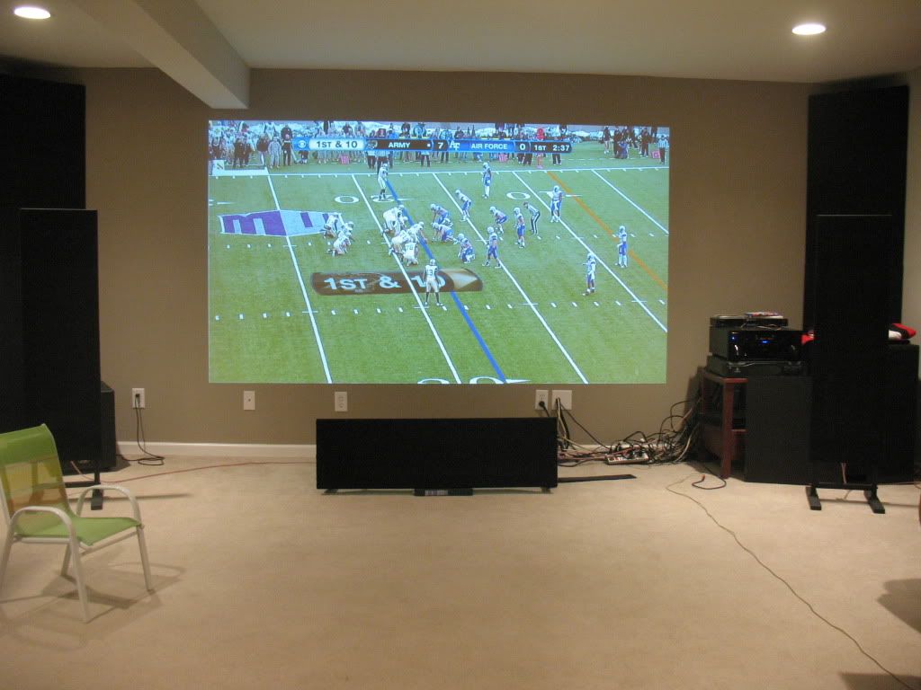

24' X 32' room (about 800 sq. ft.) 17 ft ceiling, 206" screen size, 11.1 sound, using a 8700ub (also two previous models used) and is absolutely fantastic. Your room size is similar so my recommendation is what I did....................you will not regret it. My place is VERY, VERY popular with everyone, especially when an "event" occurs. I just added a Roku for yet more content availability and so far happy with its abilities.
Hope this helps
Hope this helps
16:9 or 2:35:1? I thought my screen was big! eek.gif
16:9 ratio, and I will never go smaller, only bigger (screen size). To me it is the ONLY way to go, if you can that is, the room really needs to be big enough to easily fit the screen and seating.
It really does make you feel like you are in a small comercial theater.

Can you post pictures of your setup? I'd love to see it. My screen in 2:35:1 is 158", I wonder what that equates to in 16:9? I have a constant height setup so my 16:9 is only 124" when I zoom back in. I have noticed that when I turn off a 2:35:1 movie and switch back to tv before adjusting the zoom it's still plenty bright at that size, and the pic goes almost to the floor and higher than the top of the wall on a 7'7" wall.

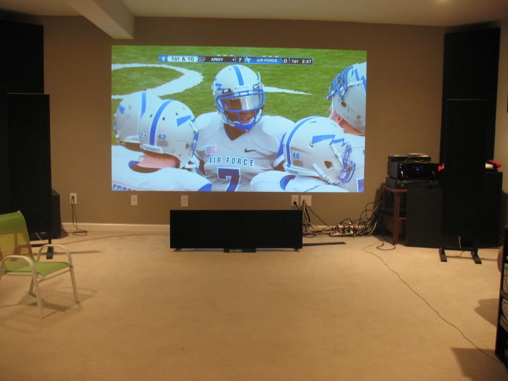

I will try with the only pic I have with me:
Taken with an older cell phone so not very high quality.

Thanks Zoey, not that it's true that I can compete with mega bucks setups, but I do agree that it's odd that so many of those systems choose to go with smaller screens. I'm obviously not a videophile, so maybe they see things I don't and it causes them to prefer a smaller screen. For me, when I first fired up the projector and played with the size of the image it seemed to just look better and better the larger it got.
I highly recommend using the wall and buying the projector first. I had just the wall for the first 2 months before I messed with a screen.
Here are some shots of the first weekend I had the projector. I knew right away I wanted to go as big as possible, and if my wall would have been taller I would have gone even bigger, I did have to leave room for a center channel. Please excuse the mess.
Image size is around 61 inches tall in all 3 photos, that's what I ended up with for a screen size.
