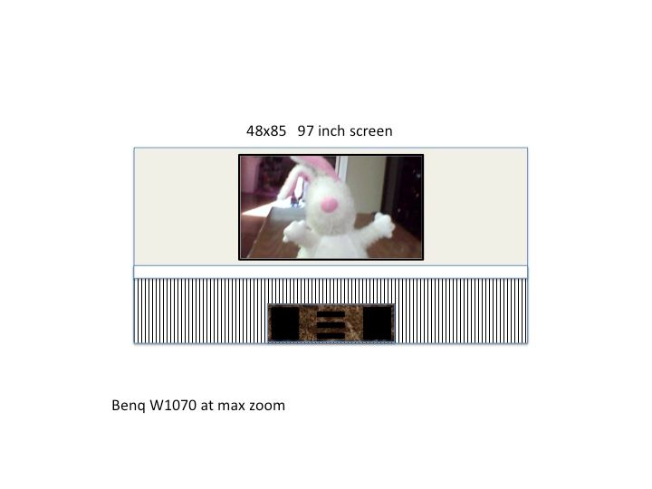

We are moving to a rented house with a basement and I have the opportunity to add a projector and enjoy a more theater like environment. Since we are renting though, I cannot customize the space as I would otherwise. Going into walls is a no go and am pretty much limited to what I can change back easily and quickly. The attached picture is a rough diagram of what I am thinking.
I am leaning towards removing the ceiling fan and using its mount to mount a BenQ W1500. Power is not a problem as I can tie it in to the ceiling fan power and hardwire at the switch. The W1500 gives me a wide throw range, good for 100 inch diagonal at 8ft from screen and a larger screen later. Also the Wireless HDMI solves the cabling issue. Not interested in 3D just some movies and light gaming so I do not think I will be over stressing the wireless connection. Eventually I will get some floor standing speakers but the Kef will have to do for now, plus they sound great anyway.
I am tempted by the BenQ 1070 and in any other application it would probably be the better choice. With the restrictions I have to live under, it is either a 80inch screen at 8ft throw or a huge dim screen at 16ft behind the sofa, plus I loose the ability to use the Wii and the Kinnect if projector is behind the sofa.
Am I missing anything? Thanks in advance and I will update with pictures for others in the budget/restricted model.

The w1070 would give about 96" from 8ft of throw, so it may be closer. The wireless HDMI feature of the 1500 might have way too much lag to comfortably game with, in addition the 1500 (wired) has a longer input-lag time than the 1070 to begin with, I believe. Depending on the kinds of games you play it could matter next to nothing with RPGs, or completely frustrate you for shooters or platformers.

Wireless HDMI is a solution to a worse case scenario, not one to be used lightly, and certainly is abysmal for gaming. There are many that use it without issue, but I've read several complaints about people using it and having issues. So, be aware that spending more for wireless HDMI may not give you any satisfaction in the setup.
I would measure several times on your distances to be sure what your lens to screen distance is.
As already point out, the W1070 is very close in size, and a good deal less expensive. You can always buy after-market HDMI wireless transmitters to try them out if you want.
I'm just not sure on this at all. I might go really short throw with the W1080ST, but the fact that you can't properly mount the projector is a real hassle. I understand there are times when renting that people don't want you ceiling mounting, but wall mounting is still not to allow, and if you actually are willing to patch and paint the ceiling then really - who cares? I mean, seriously, put something in writing to your landlord to make it official, and perhaps give them money that is specifically earmarked to that specific repair when you leave. I know when I rented in an apartment, they said flat out that painting and patching was a normal part of the move out process and I could mount my TV to the wall and projector to the ceiling and it would be taken care of.
But, as long as it IS taken care of... then who cares?
Of course, stucco/textured ceilings can't really be repaired easily.

So I played for a while on Projector Central and came to the realization that I think I will need a short throw projector to do what I want. I have played with some diagrams to show the sizes on the wall.
I can just manage a 97 inch screen at 8ft with the BenQ W1070. Since the lens is a little closer than the mount that size may even go down slightly. This looks a bit small and does not seem a worty upgrade to my 58" LCD (no cost and easy to put on a AV stand). One definite advantage to this though is I can paint on the screen rather than have to build one to overlap into the wainscoting.
The W1080 seems the obvious choice to get a bigger screen but it ends up being much bigger. A little too big in fact.
So figuring this I think 120" diagonal is the sweet spot. Unfortunately no 1080p projector will hit this size at this throw range. The BenQ MX620ST or the W770ST will though.
The MX620ST gets great reviews for gaming and is the cheapest option between all of them. Most of our movies are DVD anyway and streaming is faster and still looks good at 720P. And its got a longer bulb life to boot.
Am I wrong to think that I am crazy for not buying a 1080P projector? This 720p hits all the marks and is cheaper but... bigger is better right?
