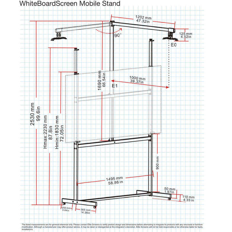

I just found this, looks pretty sweet, but would the W1080st or W1080st+ be able to mount this close to the screen?
http://www.standsandmounts.com/Elite...ZWBMS-Pro.aspx
I don't think I would buy this, a little pricey for me. But I'm tempted to make one. I don't know if it's possible for a 150in screen though. I think 120 would be too small, maybe.
Btw this is the 3d scene I made with Unity 3D to demonstrate what I want to achieve (runs on webplayer, host is my PC so it's not always on): http://www.mglushed.net/mgc
Update: I checked on their calculator, to get a 150" screen with w1080st, I would need to put the projector at least 2.3m away from the screen, and the w1080st doesn't have lens shifting, that means I cannot mount it higher than the screen, is that true?
