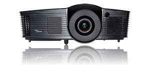

Optoma HD141X
Is this the new HD131xe replacement?
  • Bright vivid colours – 3000 ANSI Lumens
  • Full HD 1080p image quality
  • Dynamic black technology - 23,000:1 contrast ratio
  • Easy connectivity - 2x HDMI and MHL support and built-in 10W speaker
Super-sized home entertainment
Created for super-sized 1080p home entertainment, the bright HD141X is perfect for watching TV shows, sports and movies or playing action-packed games on a huge screen.
With a built-in speaker and two HDMI inputs the HD141X is easy to setup and use. Turn it into a smart projector by connecting your smartphone or tablet using MHL; now you can play games, stream videos and share photos on the big screen.
