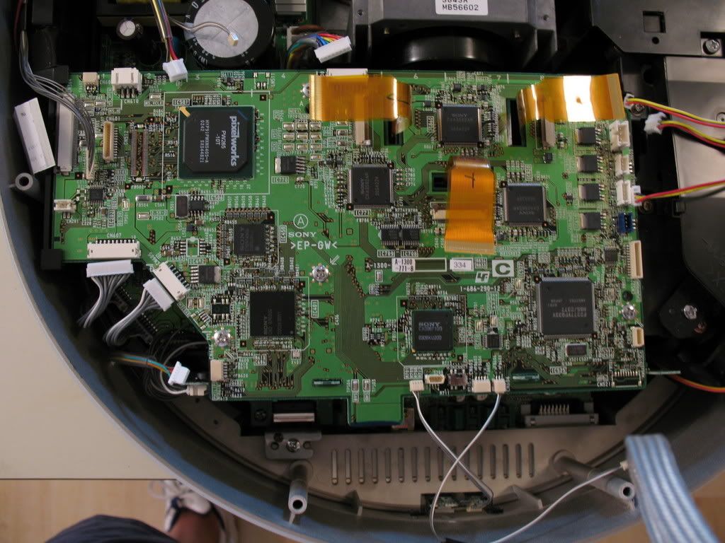

You have to remove ALL connectors and unscrew and remove the entire C board. Don't worry about marking the connectors as they are all keyed and can only be placed on the board correctly. Be carefull of the headers conncting the C board to the riser boards below it. Refer to diagram 1-2-4 (C-Board Removal)
Be very carefull when unhinging and removing the three ribbon cables from the LCD pannels, as the plastic is VERY brittle on the little snaps that hold the cables in place. I broke one side of one of them and had to use a bit of epoxy to hold it back in place.
After you remove the c board you can remove the polarizers. Remove the screw and you can slide the Blue OUT Polarizer straight up with fine tweezers. (9-885-029-41) $175.36

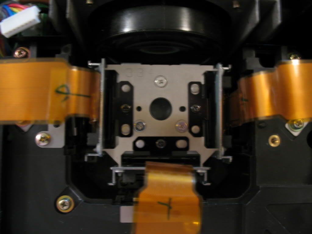

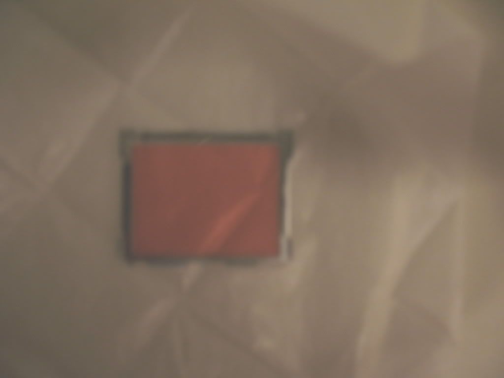

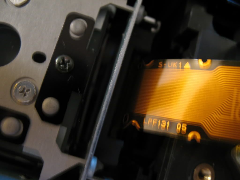

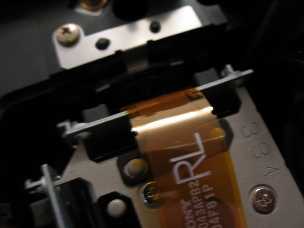

New blue polarizer!
Cover off, C board ready to come out:
Looking at the polarizers, all 6 accessible:
Closeup:
Another one:
Whites are white again, not yellow! This should hold me for another round of PJ releases, then I'll get serious about an upgrade to 1080p, probably not LCD again, tho...
