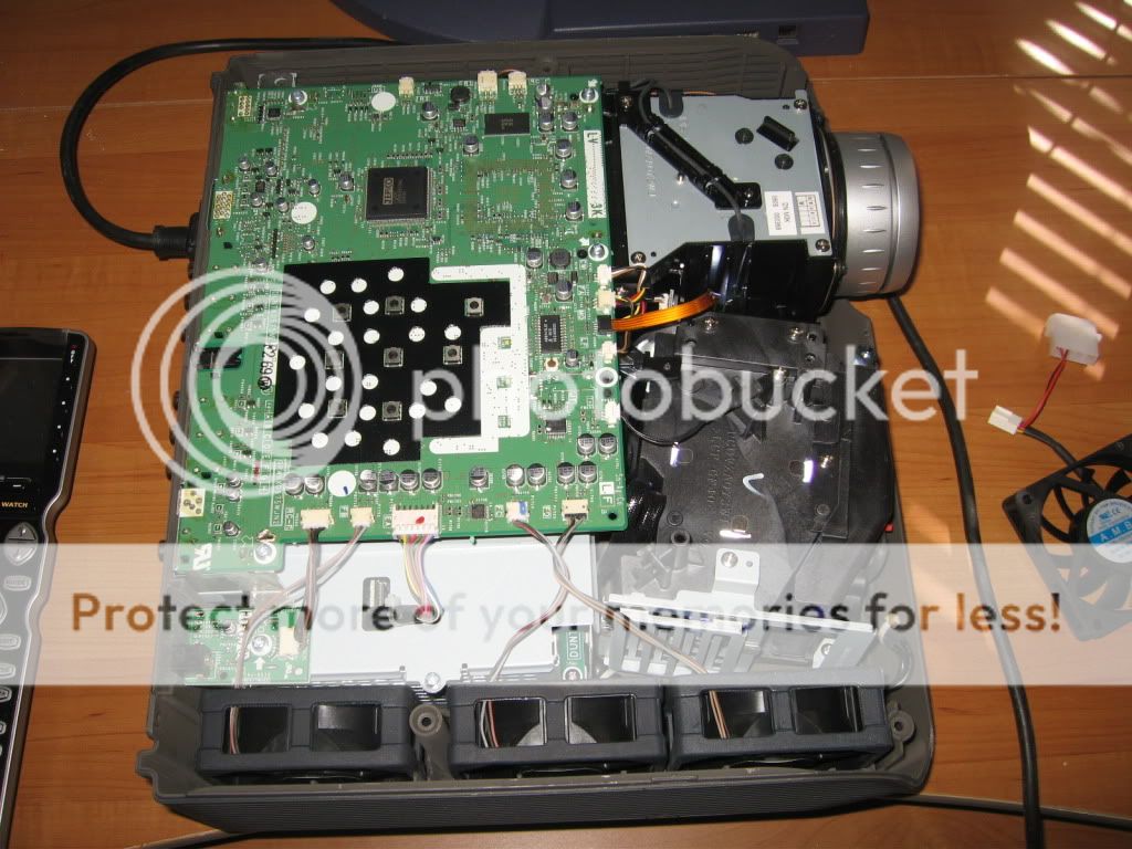

I keep forgetting to update my fan swap, as mentioned earlier in the thread here:
http://www.avsforum.com/avs-vb/showt...9#post16100289
I didn't have a lot of luck. There are three fans and I swapped in two
replacements. But the projector would shut down after just a few minutes.
So I now have it with just one replacement fan and it's been fine for the
last 1200 hours.
The single replacement fan did lower fan volume an audible level. But the
difference is so slight, that it's not really something I'd recommend unless
you have nothing better to do with your time.
I now have 1800+ hours on this projector and original lamp. I started out
watching everything with the narrow iris setting. But after about 600 hours,
I had to switch to medium iris, where I'm still at today. It still looks great
today, but I'm going to replace the bulb anyways. I'll try the relampit.com
source.
I use a 92" wide DaLite High Power screen and the projector is mounted
about 10" down from an 8' ceiling.
Here are some pics of the teardown, cleaning and fan swap.

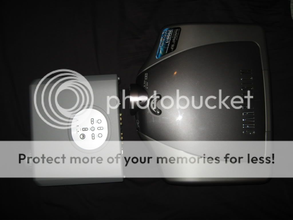

VP4001 on left, vs. the Sharp 12k it replaced. The Sharp had a slightly
better overall picture, but was louder and way dimmer.
Underside of the top cover:
Lamp removal:

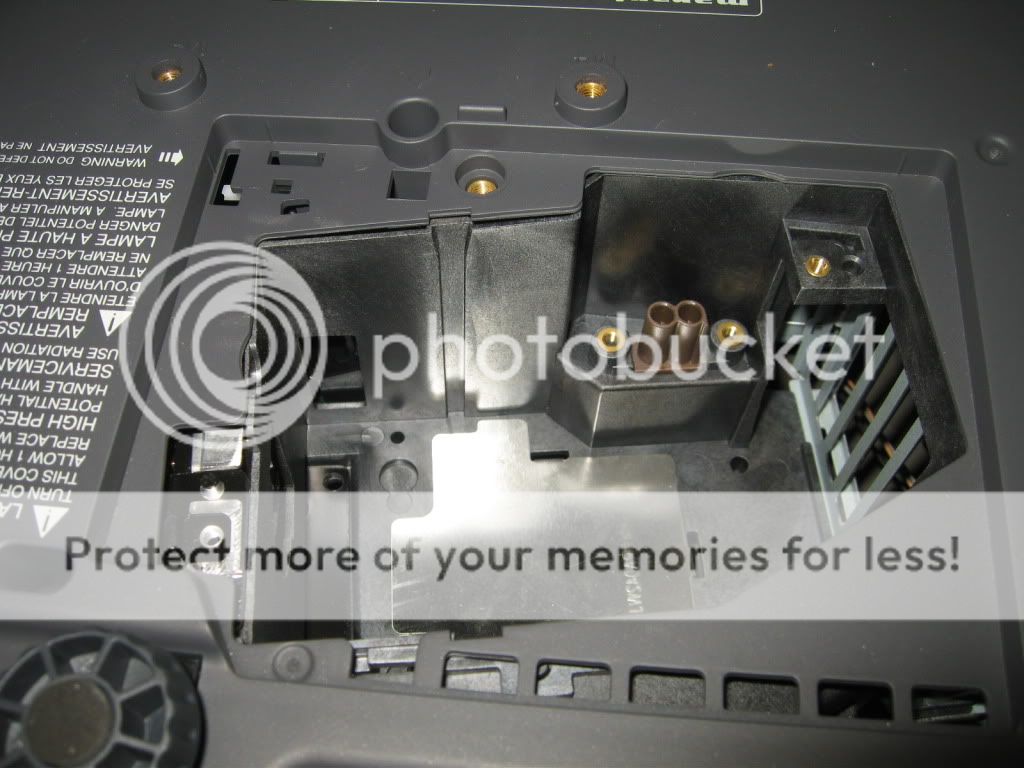

Lamp:
Lamp cavity and fan:
Internals. You can see the three fans at the bottom:

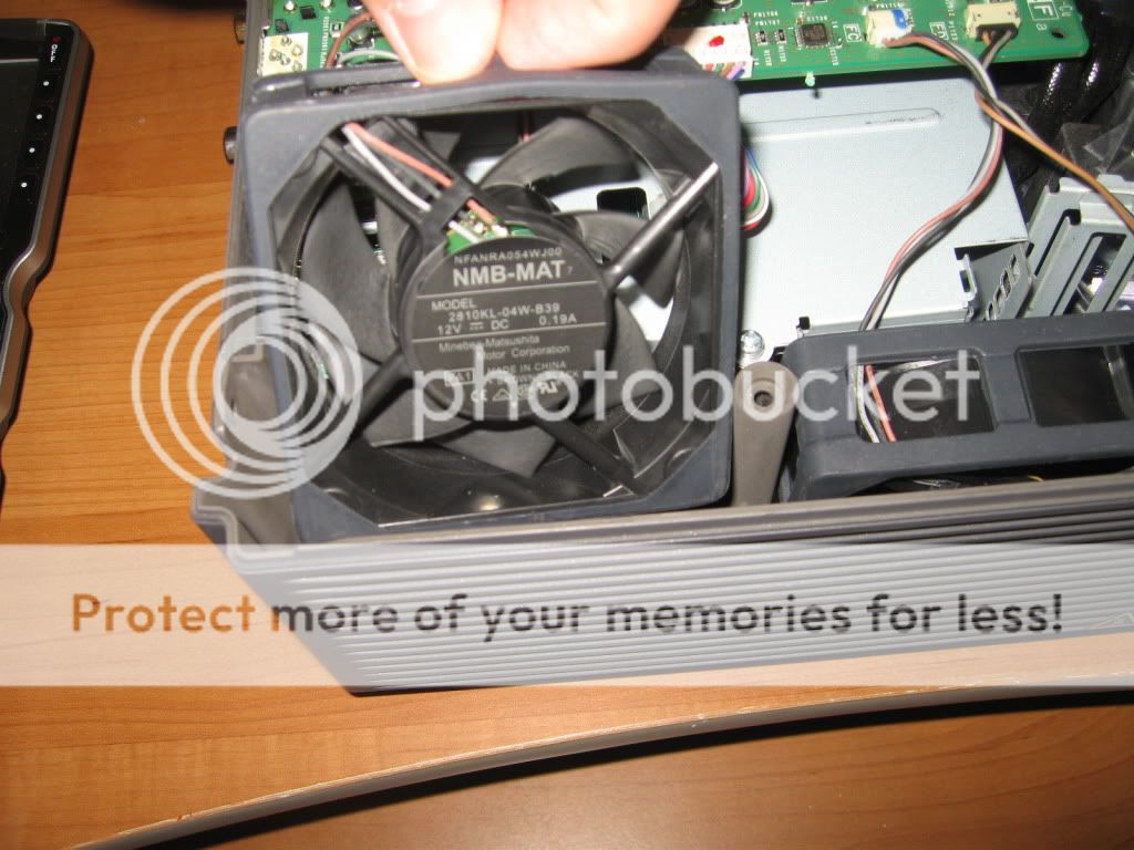

This is the original fan. Fans just lift right up. No screws.
I like that they are encased in removable rubber grommets:

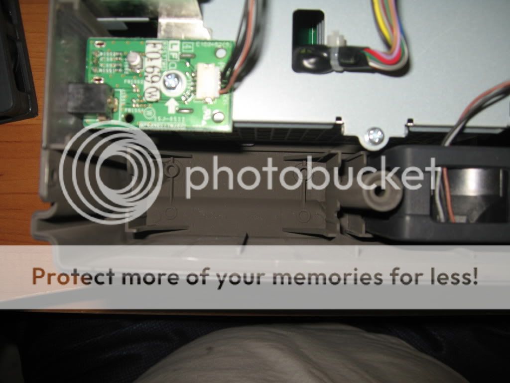

Empty fan bay:
This is how the fans connect to the circuit board:

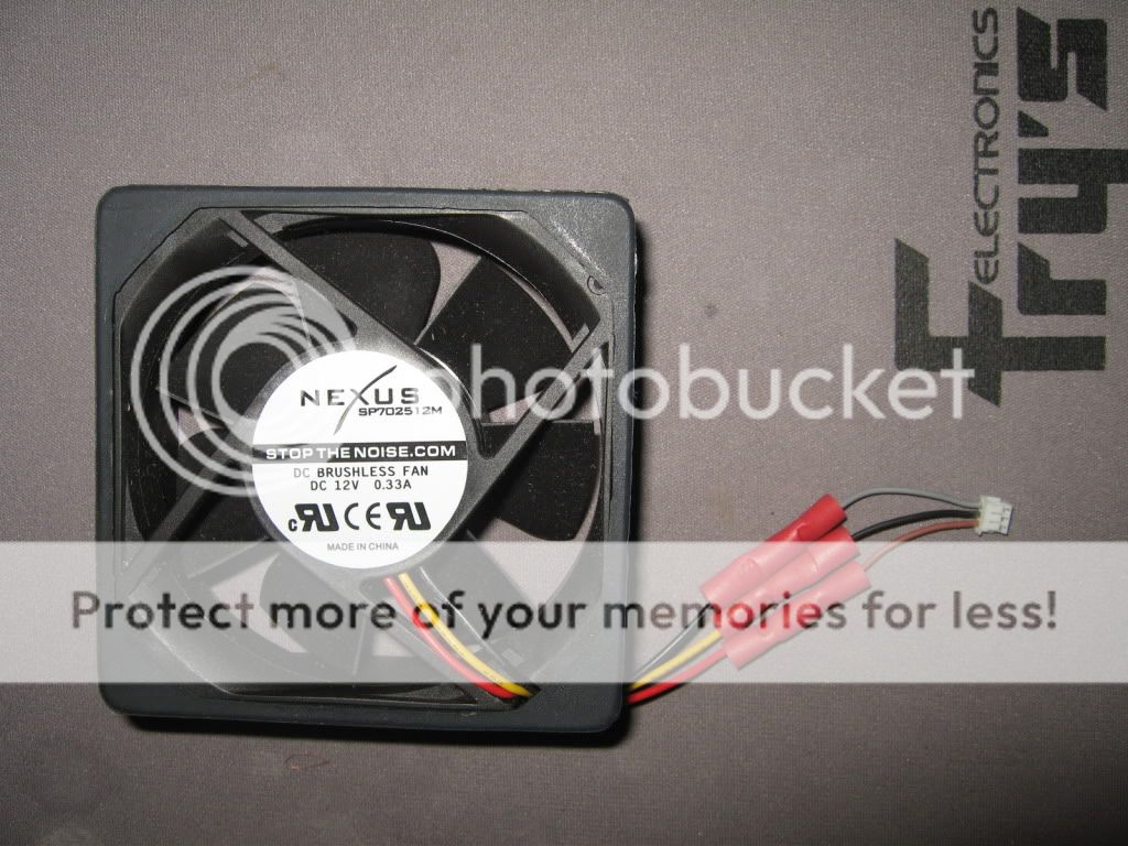

Replacement Nexus SP702512M fan spliced into the original wire harness:
Side view of where the fans are in the projector.
The Nexus is the one on the far left.
last 1200 hours.
source.
Lamp removal:
Lamp:
Empty fan bay:
Damn - I was hoping you'd have better luck than I did. Mine would start up and then shut down after 10-15 seconds.
I may fiddle with it again some time. Seems if you can get one to work, then there may be some way to get a 2nd to work also. I can say that once you figure out how to remove the top cover, that replacing the fans is incredibly easy. I just never got around to working on it further because the fans don't bother me too much.
"The boom is dead, long live the bass"

I have a bunch of pics of my old 12k also. Here's a good glimpse of one of the turbine fans. That projector is full of fans like this.
Btw, I did clean the fans before I reassembled everything.
