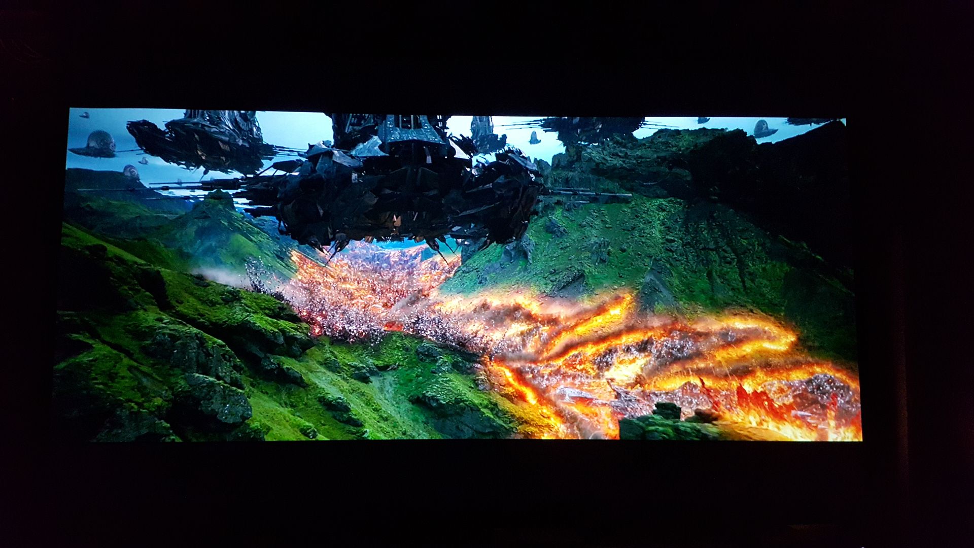

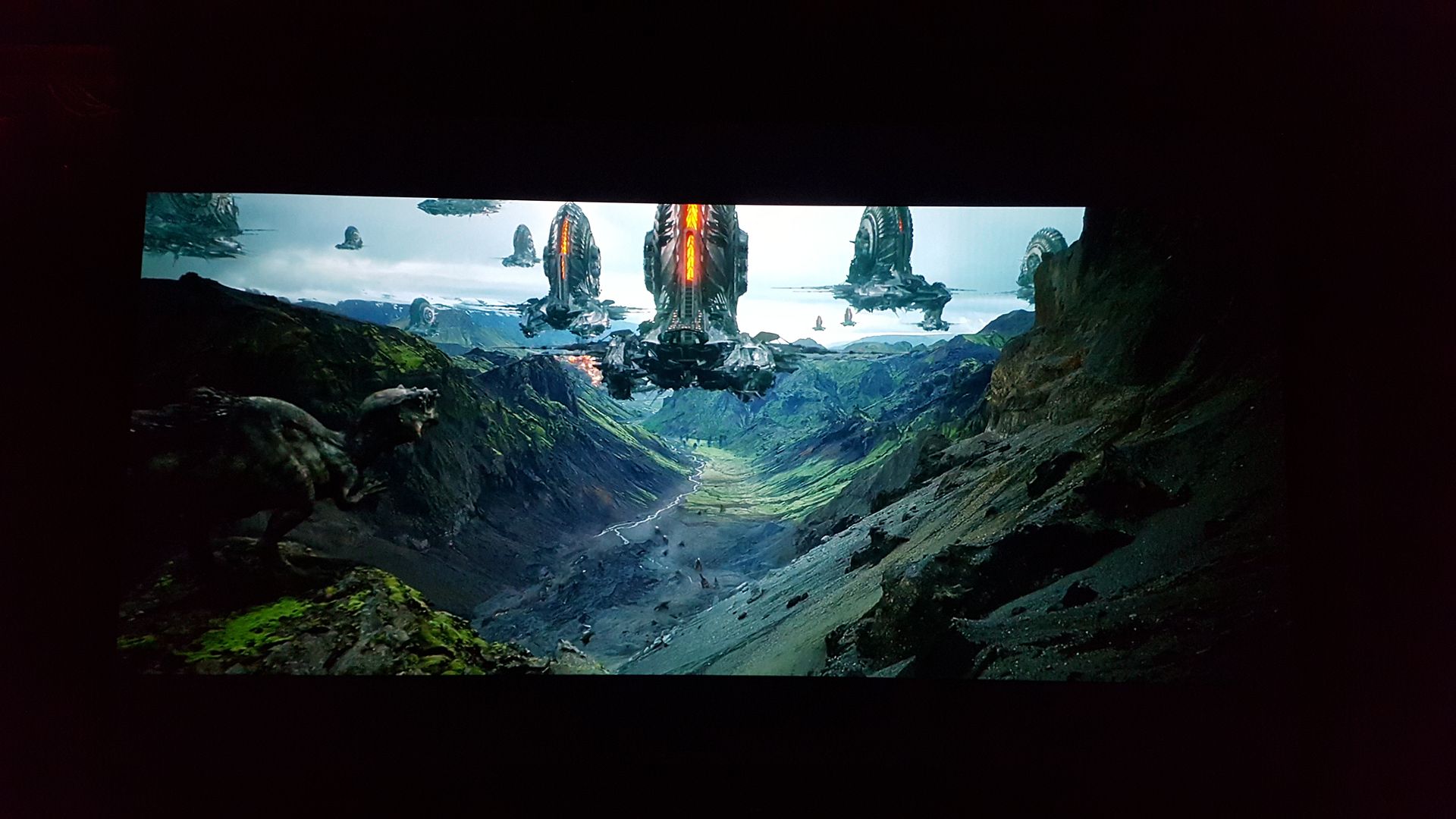

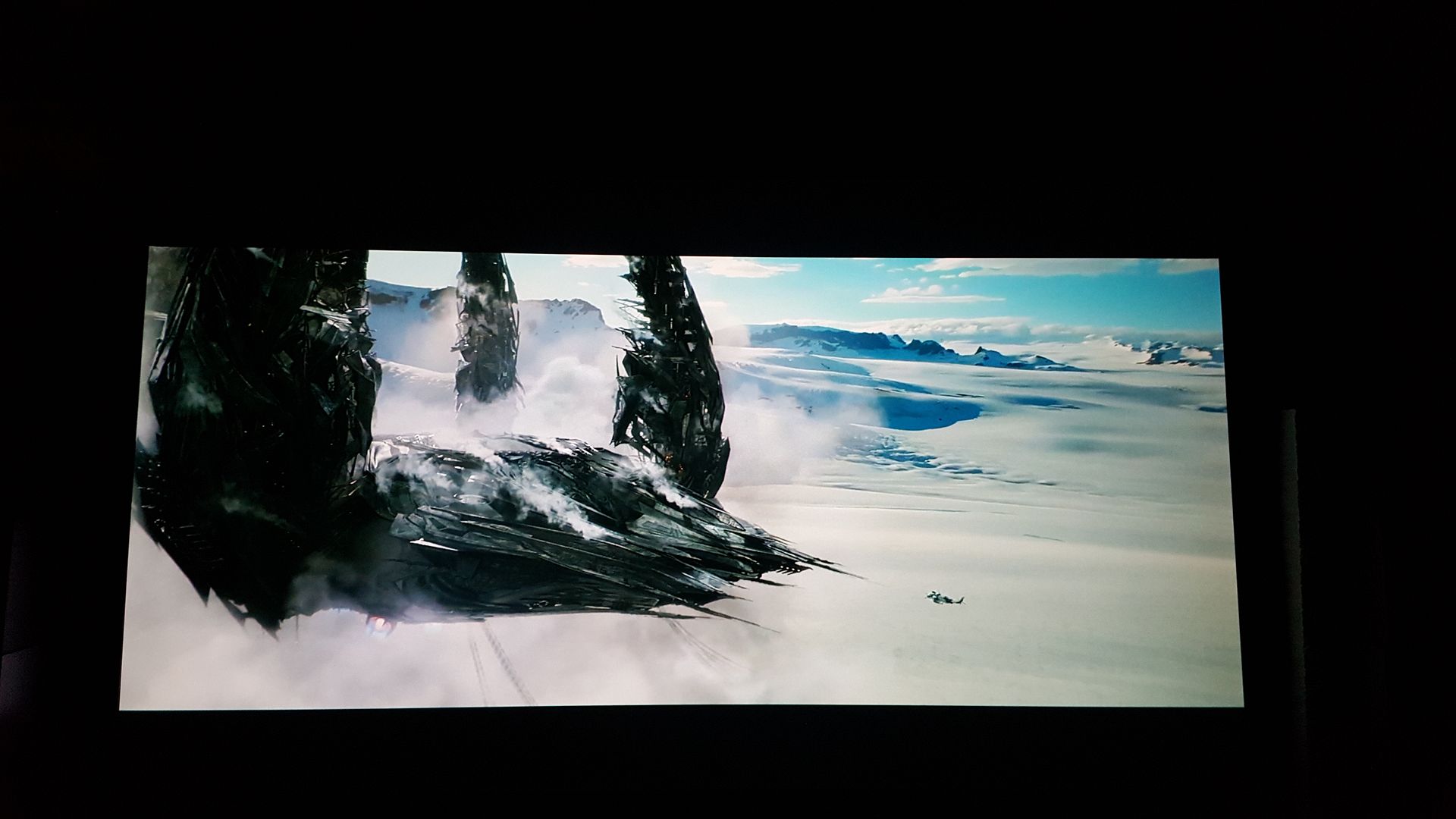

It's been about a week and half since I cleaned my 1080UB up,
No sign of trouble after another 40 hours so I treated her to a fresh new lamp today ($154)
Looks like new again
Transformers Age of Extinction
1080p rip on a flash drive a friend gave me,
playing on my XBOX One Media Player...
120" screen is about 8'-9" wide
Sorry, didn't have time to pull out my usual camera,
these are straight uploads direct from my Samsung Galaxy S6
I just got this projector used for $200. I picked up a new bulb as well. Your settings/calibrations look amazing, any chance you could post them here? If it's not too much trouble. Thanks!

LOL, go back one page and read my settings post,
....the one right after the one you just quoted
