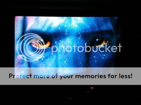

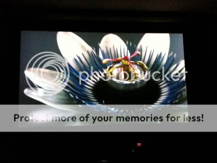

post #3054 of 3142 Old 03-15-2012, 09:31 PM
BasicBlak's Avatar
Location: Los Angeles, CA
Posts: 1,864
Greetings folks!

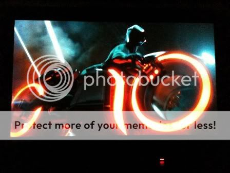

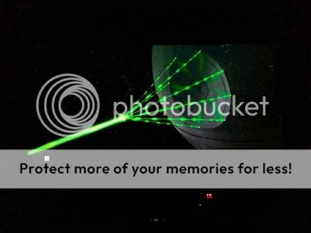

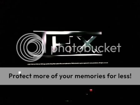

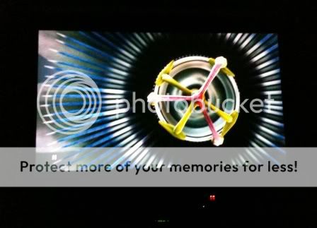

Very long time follower of this thread, and thought I'd chime in on the AX200's viability in the current 1080p and 3D environment. I was fortunate enough to snag my own brand new unit early last summer (manufacturing ended May 2011) for what amounted to an absolute steal (practically a giveaway...seriously). Only now have I been able to take the time to add my two cents worth on what I have found to be a truly fabulous piece of equipment.
Without question, projector technology in general has progressed to the point where the AX200 has now been outclassed by many a current model out there, both 2D and 3D, to which any reasonably objective person will attest, I believe. That being said, within the limits of its capabilities (and even beyond those limits on some perameters), the AX200 is quite impressive and, with proper setup/calibration, continues to hold its own. Though it is my intent to eventually upgrade to a 1080p, 3D-capable model, for now I really cannot speak highly enough about it.
To those long-time AX200 Thread lurkers out there who are looking to enter the front projector game for the first time, and who perhaps may also be doing so on a shoestring budget: If you can land a well cared for used unit (or, if the heavens are smiling down on you as they did me, a rare factory-new unit), I wholeheartedly recommend this projector. Granted, there is simply no ignoring what is currently available today from the likes of Panasonic, Epson, Mitsubishi, BenQ, etc; such is the reality of forward development. However, in my view the AX200 makes a wonderful interim purchase, and I wouldn't hesitate to pull the trigger. Ease of calibration and setup, sick'ning brightness, 1080/24p capability (yes, even from a PS3; though there were some very early reports of 24p issues, they are non-existent in my setup), more than tolerable fan noise particularly in eco-mode, very decent black levels along with a surprisingly brisk-functioning dynamic iris, excellent color decoding, and very good sharpness despite the Smooth Screen feature... You'd be hard-pressed to find a better 720p projector out there.
Though officially retired last May, I submit that the AX200 is indeed alive and well...and certainly still viable and worth considering. My sincere gratitude to all who have contributed to this thread and all I've been able to glean from it in the process.
(Please forgive the shortcomings of my somewhat anemic iPhone 3GS camera, by the way.)
Panasonic PT-AX200U
Da-Lite Model B 106" HCMW
Sony KDS-60A3000
VIP 3D Theater Plus Converter w/ MonsterVision Max 3D Eyewear
Onkyo TX-SR805 (v1.08 w/DSP & HDMI Updates)

Originally Posted by BasicBlak View Post

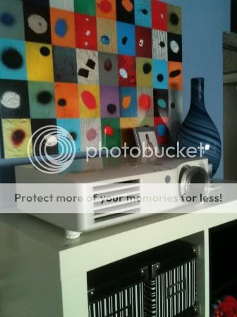

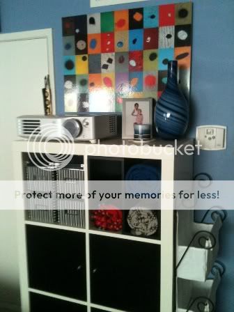

Greetings folks!
No doubt the AX200 was/is a great projector. And as far as a first projector I agree that it would still serve quite well in that capacity. The only thing I would caution prospective buyers (of a used unit) to be aware of is the issue of the polarizers going bad. My AE900 and current AX200 have experienced this. While my AX200 is not terrible yet, I can see it is getting more noticeable. I'm not really complaining as I have nearly 5,000 hours on it (currently on my second lamp) and unfortunately this model used organic panels, while most of the newer products have switched over to inorganic, thus alleviating this problem from what I understand. That said, I paid $800 for my AX200 3.5 years ago and it's served faithfully as my every day living room tv for all that time. It owes me nothing. Now I just need to decide what will replace it.
broadwayblue is offline
