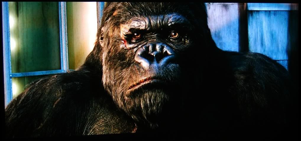

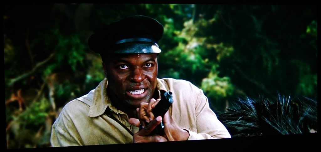

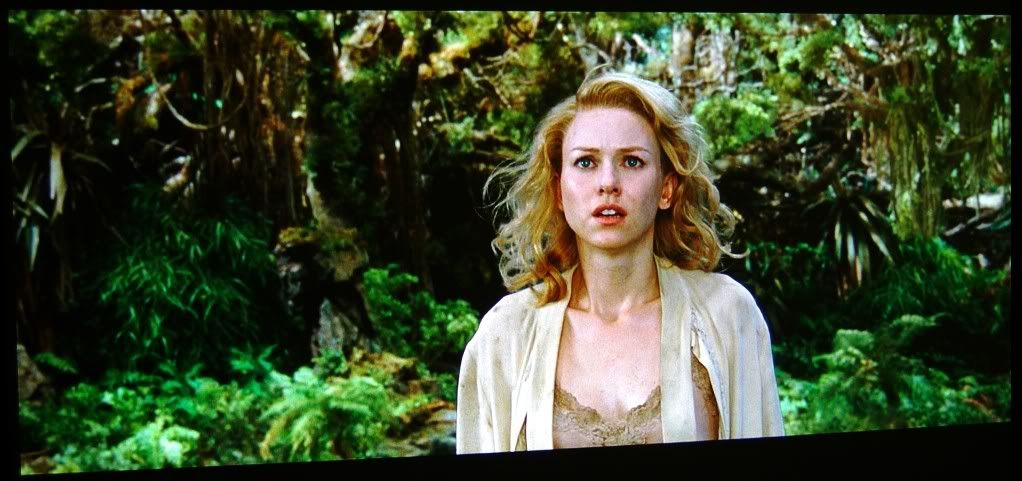

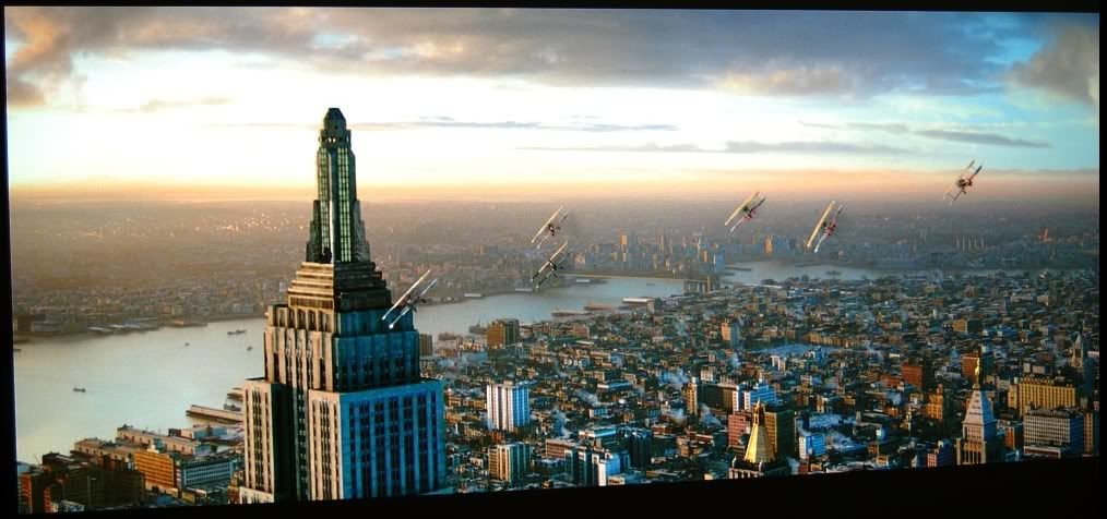

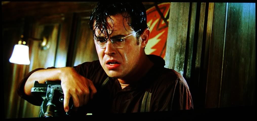

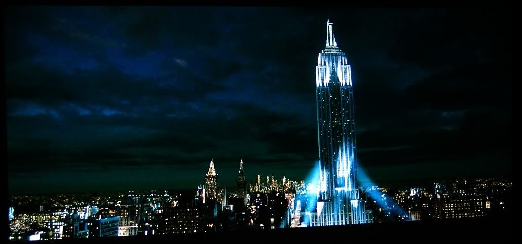

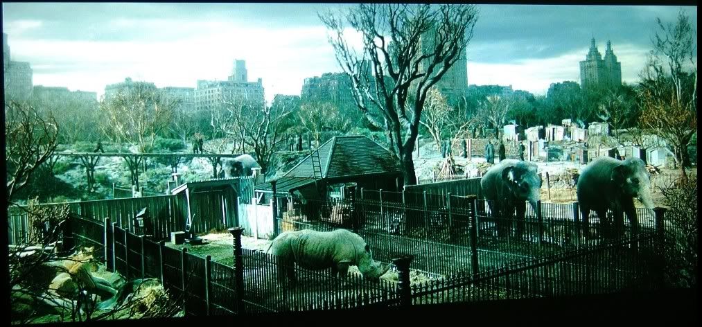

Watched King Kong first time on my new EP30. Very impressive. The transfer quality is really wonderful.
Wife got really p***ed while i paused for taking pictures in several occasions.
Sharing some screen shots here... Enjoy
Settings - HDMI- some changes from default set. Need some time to do full calibration.
cinema
contrast - 4
brightness - -5
video
bc - 1
truvid - 0
col temp med
RGB - Gain 3 0 4 Bias 0-1-1
anirbana is offline

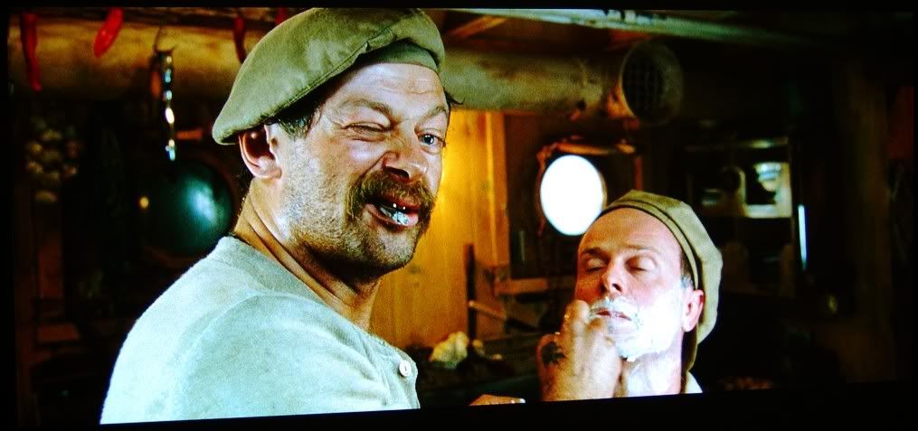

I love the coloring of this Optoma projector, Optoma always had their own vibe/look in coloring, all of them.
Is that King Kong HD-DVD?

post #475 of 2885 Old 03-27-2008, 02:11 PM
anirbana's Avatar
Location: London, UK
Posts: 604
Yes it is from King Kong HD DVD. It just pops out.
anirbana is offline
post #476 of 2885 Old 03-27-2008, 03:34 PM
acksnay's Avatar
Join Date: May 2004
Location: Asheville, NC
Posts: 1,303
Subtlety is clearly not their strong suit Tom. (needs a FILTER ) But it sure looks like a fun pj.
Oh, and thanks for the nips, anirbana. Must have been a bit cool on that set.

post #479 of 2885 Old 03-29-2008, 04:50 PM
Peter_'s Avatar
Location: Brazil
Posts: 296
Tests comparing the upscaling of Optoma with the HTPC.
DVD Player Philco via Video Component in 480i
HTPC via HDMI at 1280x720 pixels.
Software used in the PC: Media Player Classic + ffdshow
Scene 01 DVD:
Scene 01 HTPC:
Scene 02 DVD:
Scene 02 HTPC:
The definition of the image was improved by HTPC.
