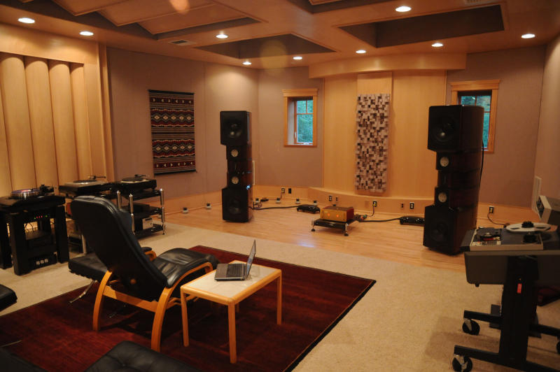

post #29 of 118 Old 09-20-2008, 09:18 AM
mike lavigne's Avatar
Join Date: Oct 2003
Location: Redmond, Wa.
Posts: 1,140
Rutgar,
a few weeks back i posted on this thread. as i type slow i spent quite awhile posting some pictures and writing comments. that night AVS had a failure and my posts were lost. i was frustrated after all the time i invested and did not take the time to repost.
anyway; i thought i would at least post another picture of my center diffuser that you were referring to. i painted the diffuser a color that works both in the light and when i have the lights dim. i do view it as functional art and seems to compliment my Navajo's as well as the maple cabinetry and the fabric wall coverings. when the lights are dim it is soothing and with daylight it is subtle.
as i posted previously; i experimented with the width and height of the diffuser to find what works. you cannot just throw up a diffuser and assume it will make things better. this diffuser is the only acoustical addition i have made to my Rives room. OTOH it has taken me 4 years to optimize my system in the room. every time i thought the room was a source of problems it turned out to be my gear in some way. when Rives designed my room they told me that i would likely want to change things a bit over time; particularly they over built my bass trapping and thought i might want to cover some of it depending. adding buiilt-in bass trapping to an existing room is not realisitic; covering some already built bass trapping is easy. i have not made any changes and the bass performance in my room is breathtaking now.
mike
Sony XBR-65A1E / Sony VPL-VW1000ES--Da-Lite 2:35-1 screen, 7.1 Revel speaker, Cary Cinema Eleven processor, Oppo BRD, dedicated Home Theatre / Fujitsu P50XHA10US / Dedicated 2-channel music room, https://systems.audiogon.com/systems/615
