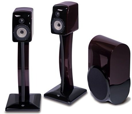

Keep in mind YOUR thread is NOT about the Xd.. Dang it John! It is a good speaker but it was lacking; the argument it is so good that people reacted negatively is flimsy at best..
It doesn't matter, Xd is gone! Well, almost gone. As is NHT. But what you see as 'lacking' is PRECISELY what I don't want to hear from a speaker - the sound of the speaker! All you had to do was drop these in the same room as a $20K speaker, almost ANY $20K speaker (including/especially Magnepans) and they would tell you exactly what is wrong with the other speaker, how it is coloring the sound, where the resonances were, the peaks, the dips. The Xd is NOT the best DSP speaker that can be built, but it remains better in many to most ways than many if not all passive speakers. I will not retract this, no matter how many times you push me to do so. Point source is just plain more natural than a large baffle of drivers. Buy a set of Xds, keep them in your house and I guarantee they will increasingly draw you to them and away from the Maggies.
Besides, I'm just pointing out that an ADC/DAC is simply not crippling, even though it is not 'ideal'.
On the crossover side I agre in part with you . It is not the ability to perform corrections that is the only advantage of Digital crosovers it is the fact that they can perform the needed mathematical function almost perfectly.. I keep on repeating it a crossover is a filter or several filters.. A filter is a device that at the core performs a mathematical functions (or at the very least should perform it). Analog Filters are a crude approximation of these functions.. very, very crude... A digital filter can actually perform the exact needed function with virtually no errors... That in itself should make them sound better in theory in practice there are implementation problems and they account for the widely different results...
Well, you still get ringing with any crossover. Meridian says that it has made what they call 'apodizing' filters, which, if I understand their press material (which remains press material), they are able to emulate a 'perfect' filter with little or no ringing. Or that's what they seem to imply.
John

Originally Posted by FrantzM View Post
John
Keep in mind YOUR thread is NOT about the Xd.. Dang it John! It is a good speaker but it was lacking; the argument it is so good that people reacted negatively is flimsy at best.. .
Frantz,
Additionally, John keeps attempting to make one of the FAULTS of the Xd crossover into
a virture - the high order, steep slope crossover. The steep crossover made the designer's
job easier by essentially "decoupling" the passbands.
Unfortunately for the end user; the steep crossover comes with a SEVERE price that is
dictated by the mathematics - the steep crossovers have "pre-echo" which is acausal
and smears the sound. John Atkinson actually MEASURED the pre-ring; so don't let
John do his usual fabrication that it was magically cancelled by the other out of passband
driver. It would have been a better speaker with smoother crossover transitions and an
improved radiation pattern if they had "blended" the drivers at the crossovers instead of
the discontinuous cut-off that was implemented.
Mother Nature is "continuous" and any product wishinig to emulate Mother Nature should
be free of artificial discontinuities.
The Xd is good - but it is definitely NOT "great"; as we have discussed many times
here before. For the low price; it's pretty good - although my colleague "smokester"
believes one can do better for the same price.
Dr. Gregory Greenman
