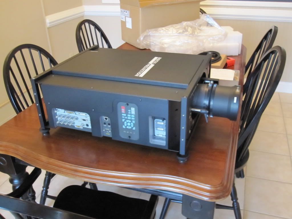

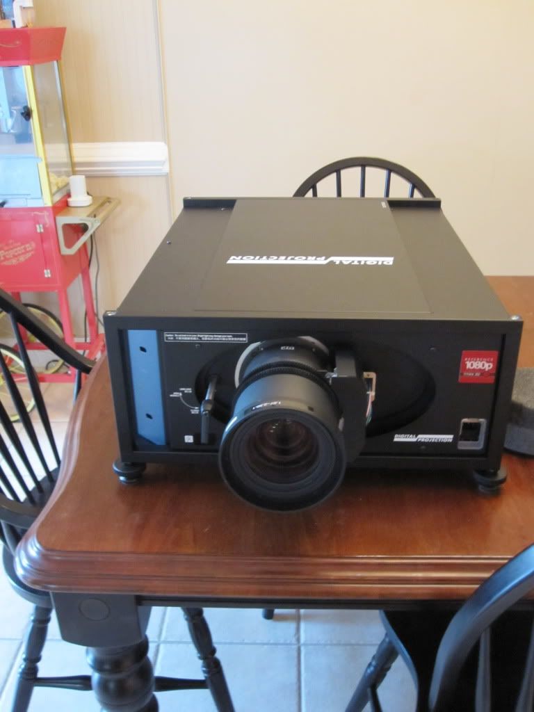

Its a BOY!!!
Weighing in at approx 75lbs and approx 35" long
I could not wait for it any longer. So yesterday I drove from Panama City to Atlanta and back the same day to pick it up from Digital Projection.
Just starting to get it setup but he has made it into his crib.
ccool96 is online now
