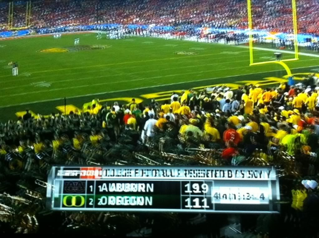

I have my Titan Ref 3D connected to a Lumagen XE all works great for Directv and Bluray.
It has to be setup a little weird though. First the Directv has to be connected to Input 3. Input 3 works for the half-res 3D formats. Input 8 is for frame-packed bluray.
I have output 1 on my lumagen going to the AV Receiver and then to input 3 on the Titan. That works for everything except 3D bluray.
Output 2 on the lumagen goes straight to the Input 8 on the Titan
The lumagen has to have 3D mode turned on, auto wont work cause the lumagen doesnt recognize the Titan as an HDMI 1.4 capable display.
The lumagen can vertical stretch for cinescope 3D blu-ray content.
Also ESPN broadcast in 720P sbs on Directv. The Titan has to be put into 3D professional mode because it wont recognize that signal automatically under 3D Consumer mode.
The only thing that wont work well is my PS3 for gaming. The only input that accepts frame-packed signals is input 8, but there is no scaling for input 8. Since ps3 does gaming at 720P frame packed all i get is a small 1280x720 image centered in the 1920 x 1080 chip. SUCKS!!!
Lumagen should hopefully be able to help with this soon. I have spoke to Jim at Lumagen and we will see a way to convert or scale between different 3D formats eventually.

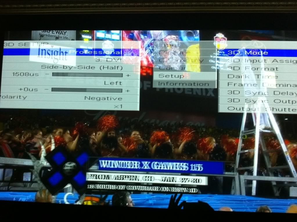

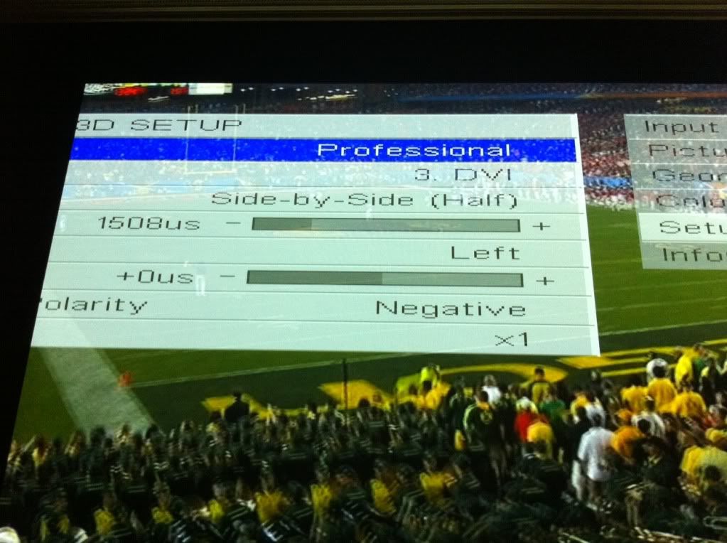

Yeah I talked to Jim last night. Looks like I'm going to have to go that route so I can game in 3d. Sony is limiting the family to 720p frame packed. Frame packed only works on input 8 and there is no scaling. The 2 radiance setup will fix that! Yay
I screenshot my setting for 720p SBS setup. It definitely works. I have been watching it since longer before I had my radiance. And it does still. Watched the BCS game the other night.
All the settings have to be right. Input. Format. Shutter speed. So on. I'll get a picture of how mine is set and post it on here.

Here is a couple screen shots

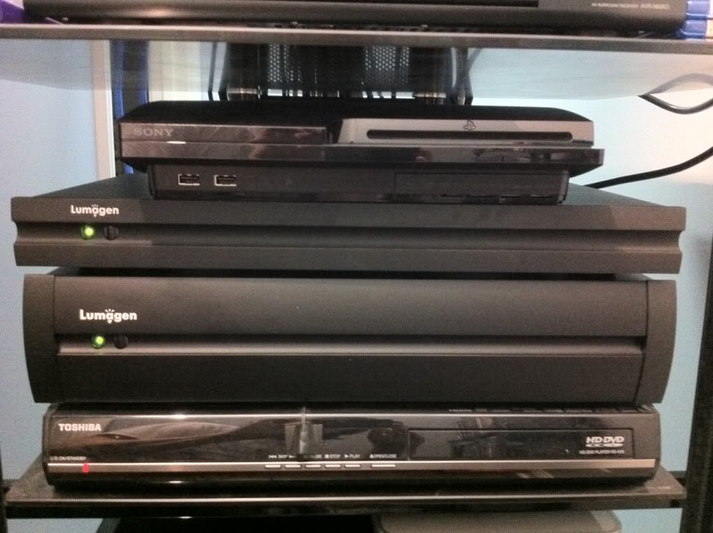

I just ordered a Radiance XS for the dual setup. I couldnt use the 3D mini cause I have more than 2 3D sources. The XS will give me upto 4 3D sources. For now i have Samsung 3D Blu-ray, DirecTV, and PS3 for gaming.
I overnighted it so I will have it tomorrow. Im hopeful this will work without a hitch!
I spoke to DPI and they said this should work in theory and that alot of commercial applications use the 3D dual pipe method. This will let me send 1080P/60 for left eye and 1080P/60 for right eye to the projector. 120Hz total
The main reason is for PS3 3D games which only output in 720P Frame packed. the Titan will not scale any frame packed material on Input 8.
the second is that now the Radiance should be outputting one 3D format to the projector so no more fooling around with setting. The Radiance will automatically determine 3D and output it correctly! Im not holding my breath just yet.
DPI said the biggest hurdle is the 2 inputs "main" and "sub" on Input 8 have to be synchronized to a 1/2 line or less thru the 3D "Dual Pipe" setup. Whatever that means But Jim @ Lumagen says that shouldnt be a problem.

Ok... so sometimes I wonder why I like electronics so much, because 90% of the time something is just pissing me off but in saying that the reward is normally worth the trouble.
After about 6 hours of updating firmware and loading new beta firmware and rewiring half of my equipment. I can now play PS3 games in 3D ))))
So far the dual Radiance system seems to be working well. The PS3 is the only device hooked up this way so far. Right now the PS3 runs thru a Key Digital 1x2 HDMI 3D splitter. It then feeds an input on the Radiance XE 3D and an input on the new Radiance XS 3D. Then the XE scales the 720P/60 to 1080P/60 for the left eye and the XS scales the 720P/60 to 1080P/60 for the right eye. Then the output of the XE feeds the Input 8 Main on the Titan. The XS feeds the Input 8 Sub on the Titan. The 3D is the set to professional mode using the "Dual Pipe" Method.
Tomorrow I will work on getting DirecTV and the Samsung 3D Blu-Ray fed this was and report back on how it works.
Here are a few pics of the PS3 setup.

Yes! Thanks! However,without the additional Lumagens we are leaving the projector on Input 8. Our client can experiment with Bluray 3d until we get back.

You can make both work pretty easily with one lumagen. That was how my setup has been until yesterday. I just have the output 1 of the lumagen feed the av receiver and then out of the receiver to the input 3 on the Titan. The output 2 on the lumagen feeds the input 8 main.
All my sources use the input 3 and the only source that requires me to switch to input 8 is the bluray. And if you leave your 3d setting under professional mode set for 720p you can use the consumer mode for all the rest.
Pretty easy control at that point. With my automation system only switching the Titan to input 8 for bluray only and then having 3 3D commands. 3D off. 3D consumer for everything but ESPN. And 3D professional for ESPN.
Might want to give that a shot.
