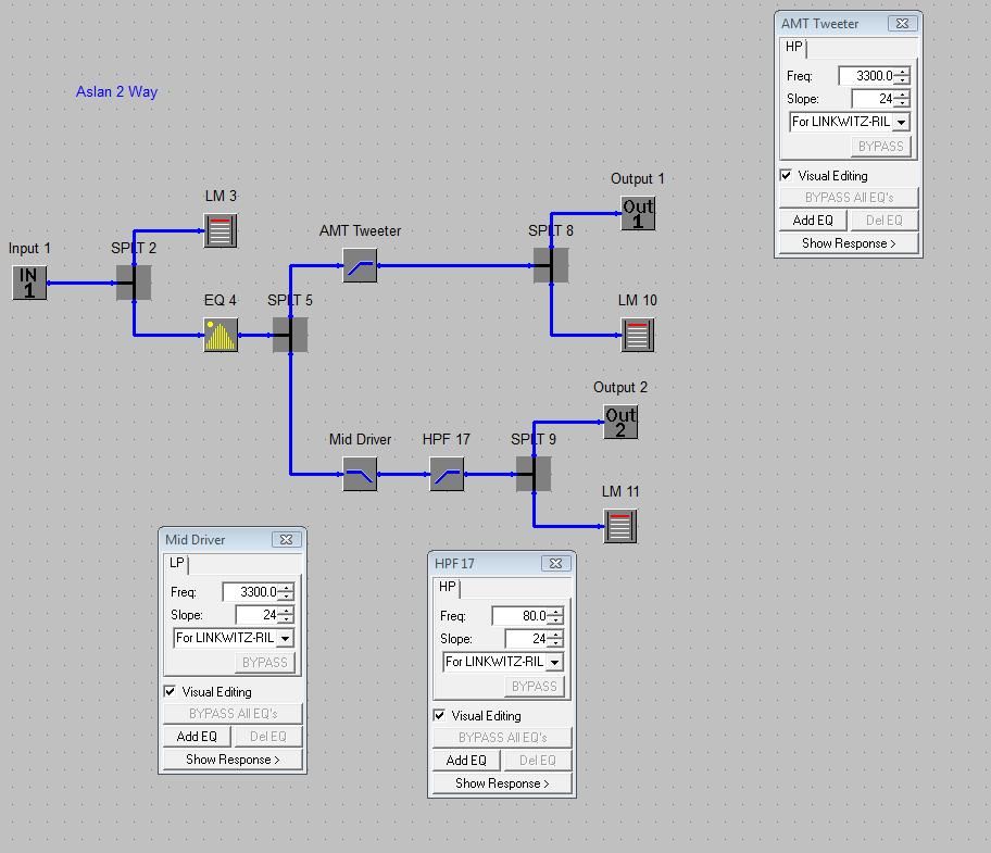

I found it pretty intuitive, look at the pre-sets to get a feel for how they work.
Here is my schematic for my 2 ways:
I wish i could understand how to use it, i thinks its awesome you know.

Who was your HAA calibrator? perhaps ask them for a bit of a lesson.
In saying that, after I did my initial measurements, eq and more measurements I was very happy with the result and I doubt I'll ever change it....in fact I wont, I'm too lazy
As I said, have a look at the pre-loaded schematics and have a play. You cant do too much damage to subs - unlike my 2 ways, if I got the crossover wrong I'd fry a $600 tweeter....
