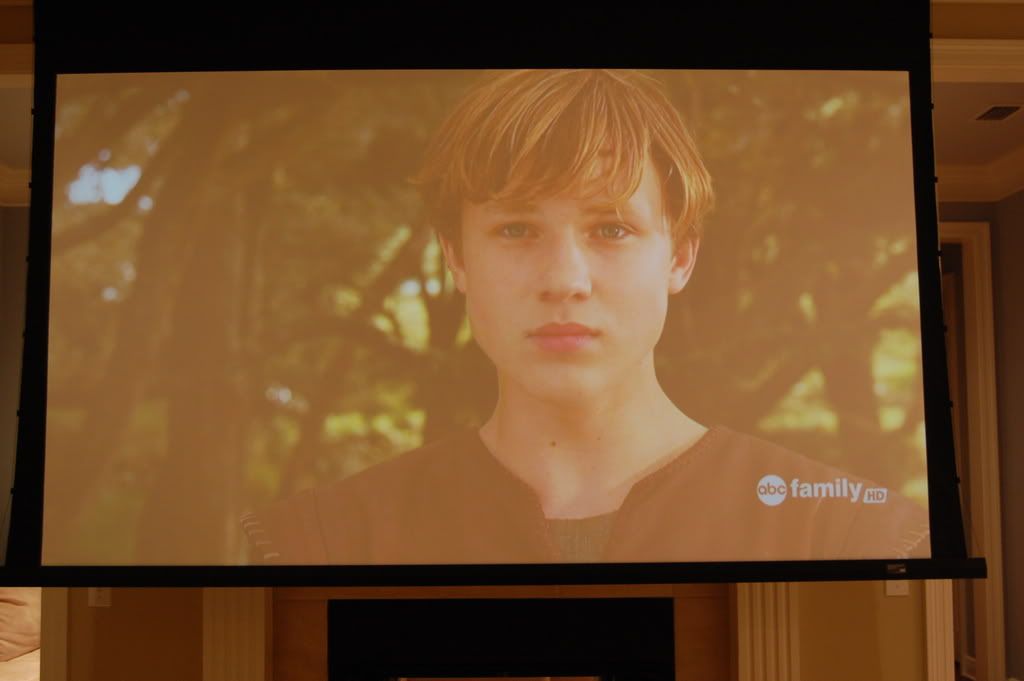

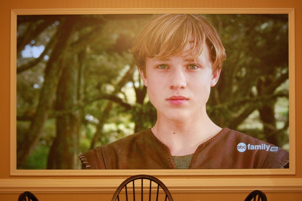

Rear projection has huge advantages over front projection if you have the space!
Front vs Rear
Close up of Front Projection
Close up of Rear Projection
I have 5 projection set ups. My main theater has a Barco 4K DCI projector with a 14' wide 2.0 aspect 4-way masking screen. I have a DP Highlite Cine 260 HB on the living room front projection and kitchen rear projection screens. Both are 106" diagonal. I have a new JVC RS-4810 in my old theater room on a 12' wide scope screen and a JVC RS-1 in my master bed on a 106" 16:9 screen. Nothing impresses people more than the rear projection setup. It's get 65fl calibrated. Looks like a huge LED TV. The picture quality and contrast is incredible!
I would highly recommend anyone who has the space to consider a rear projection setup. Especially for daytime sporting events! No one wants to sit in dark room all day long!
Thank you. Those images are night and day from each other!
