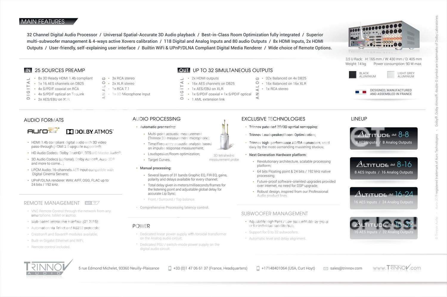

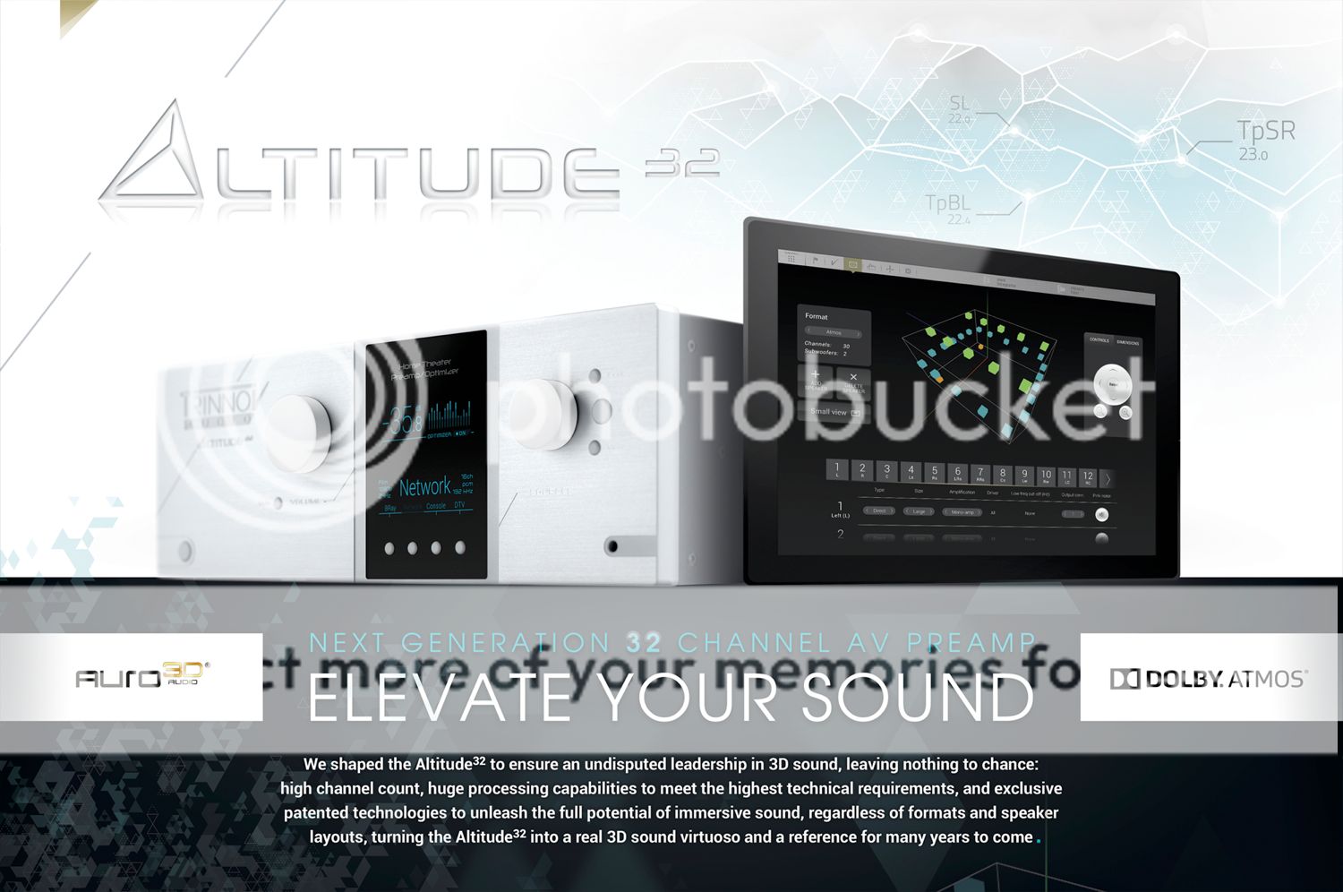

TRINNOV ALTITUDE32 update brochure ...

Liked: 55
Something I'm not seeing there in the brochure above is any mention of DSD unless I missed it. Can the platform accept native DSD via some means? I would say USB but I'm not seeing any USB ins mentioned above.

thank you so much Boonyarat for the pdf !!
The brands in your boutique are to die, very impressive! I had a pair of air tights with pawel ensembles in 1993.
Re trinov features
digital cinema input 16 channel, yes! But for this 7.1 input you can apply Dolby Surround or Auro only? 16 channels is bassis for dts uhd transport so thats good.
downmixed analog stereo out!
ANOTHER D-BoxII compatible intelligent content universal processor, actually the first stereo.

that's a pretty impressive feature list to say the least

Liked: 55
Now that's something I didn't expect to see, a DVI connection. I do see some USB inputs so it will be interesting to see how they will be used.

Hubba Hubba. I'm in love.
As far as several options noted...
1. It says upgradeable to HDMI 2.0 - is that a or b? How is it upgradeable? Can we order it with 2.0 already or do we have to wait?
2. How are the optional 3d sounds options (Auro/Atmos) added? Software vs. hardware?

Ill volunteer an answer.
When momentum data systems board is debugged they will release to qualified dealers to install.
Strictly software.
