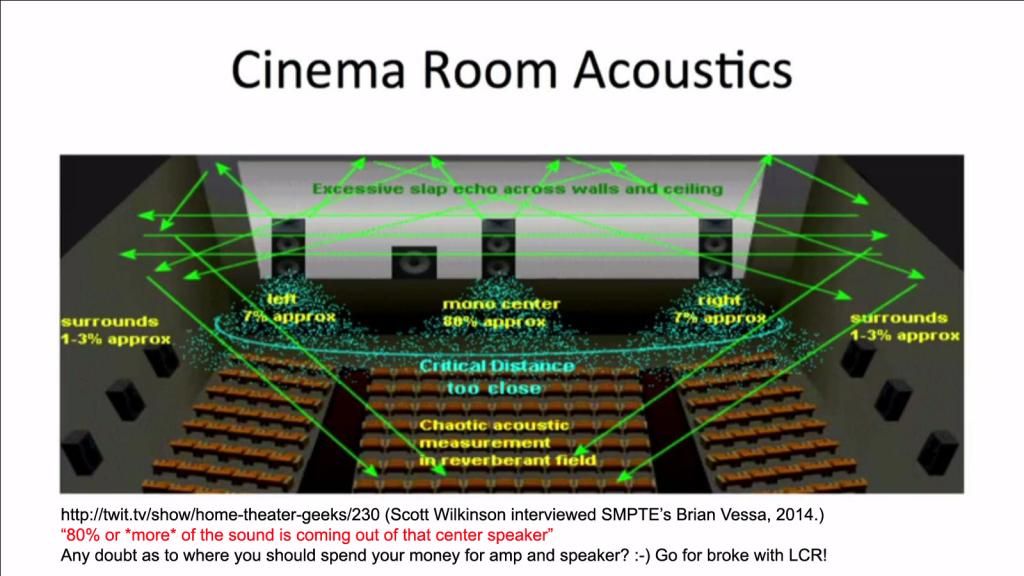

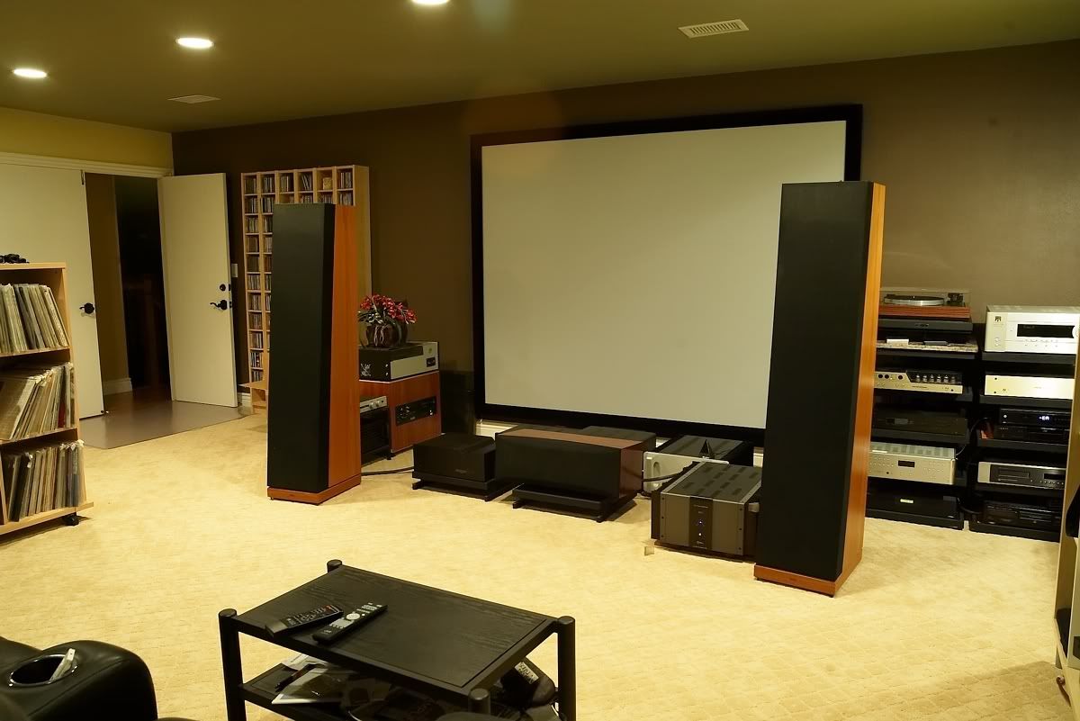

Please allow me to share my humble opinions on speaker selection and placement for a good hometheater setup. :)
How many channels and which channels are important? Before you answer this question please look at picture above, movie is front screen centric (80-90% of sound from left-right-center). It's not a competition to locate click test-sound in the ceiling. Surround effects do enhance the experience, but sound in front matters most and a good system must begin with great LCR and subwoofer as this is where ALL the drama is. I believe in higher quality of sound, NOT in higher quantity of channels. That the 7.1.4 layout is used in Dolby Atmos Bluray mixing room (see blow) is a reminder of the law of diminishing return beyond 7.1.4. Directors of good movies are not going to allow much discrete sound off screen or on ceiling because it is very distracting - spend your money wisely.
If at all possible, front seat should be in exact middle, not to the side: In other words, 3 front seats, with MLP the middle seat, is better than 4 front seats with MLP off to one side. All surround sound algorithms, Dolby, Atmos, etc., render sound with the assumption that you are seated in the middle; stereo panning depends on this. If you are off middle, clearly sound would pull to one side. It doesn't make sense to measure angles and place speakers so carefully then sit off center. The smaller the room, the more critical it is to be in exact middle. Sorry, sound pull to one side does drive me bonkers :eek:.
Bigger is better: Surround speakers are no different from 2 channel audio speakers: use the biggest and best speakers and amplifiers that fit your budget and space. Small speakers simply could not provide the dynamic headroom that is necessary for the sonic drama of movies. IMHO, do not be sloppy, and do not use cheap ceiling speaker with your $ 5k main tower for example. The minimum I would consider is speaker with around 5 1/2 inch mid/woofer driver - below this your jet may sound like a toy airplane. Bigger surround speakers allow you to crossover at 80 hz or below, which is important since bass starts to become localize-able around this frequency.
There is a second reason that I would vote for big surround speakers: whereas audiophiles use 10-12 inch woofers for music (subjectively tighter bass), hometheater geeks use 15-18 inch woofers, which subjective sound slow, and which do NOT integrate well with tiny speakers. Matching theses 15" big subwoofer with tiny speaker results in what is called "hole in the middle" - to my ears and in my experience, the crucial area around 100-400 hz (the chestiness of male voice around 300 hz) sounds like it's MIA - the louder the volume, the worse this will be.

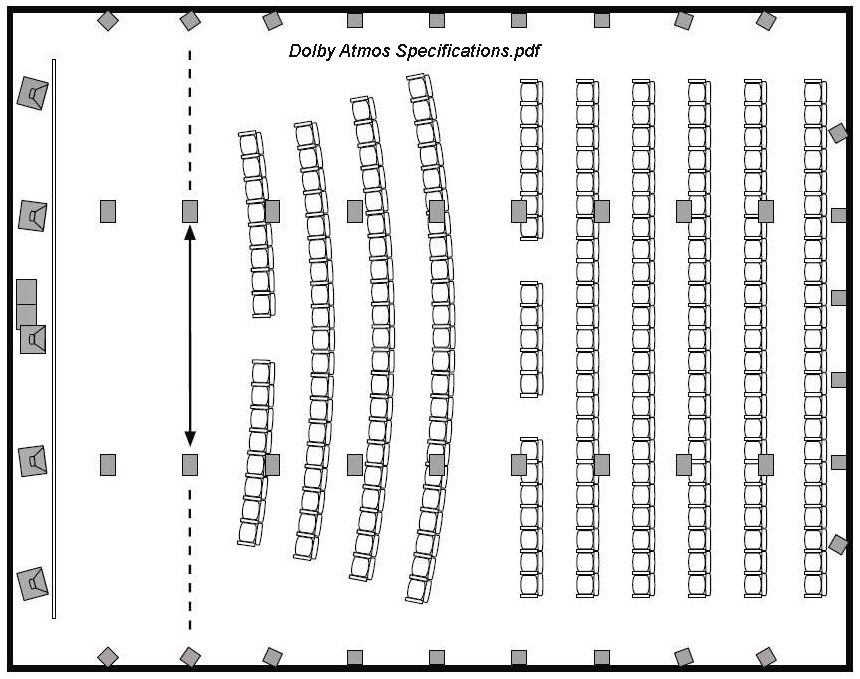

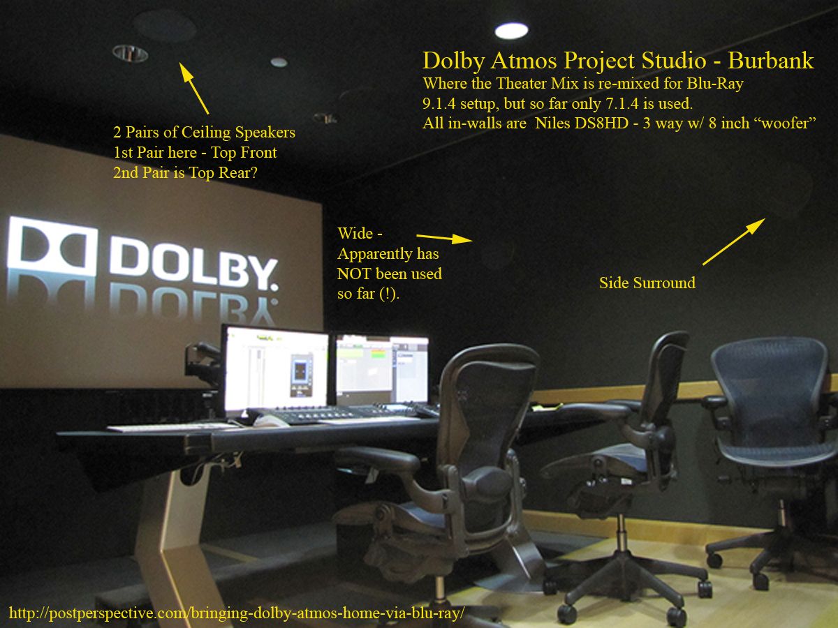

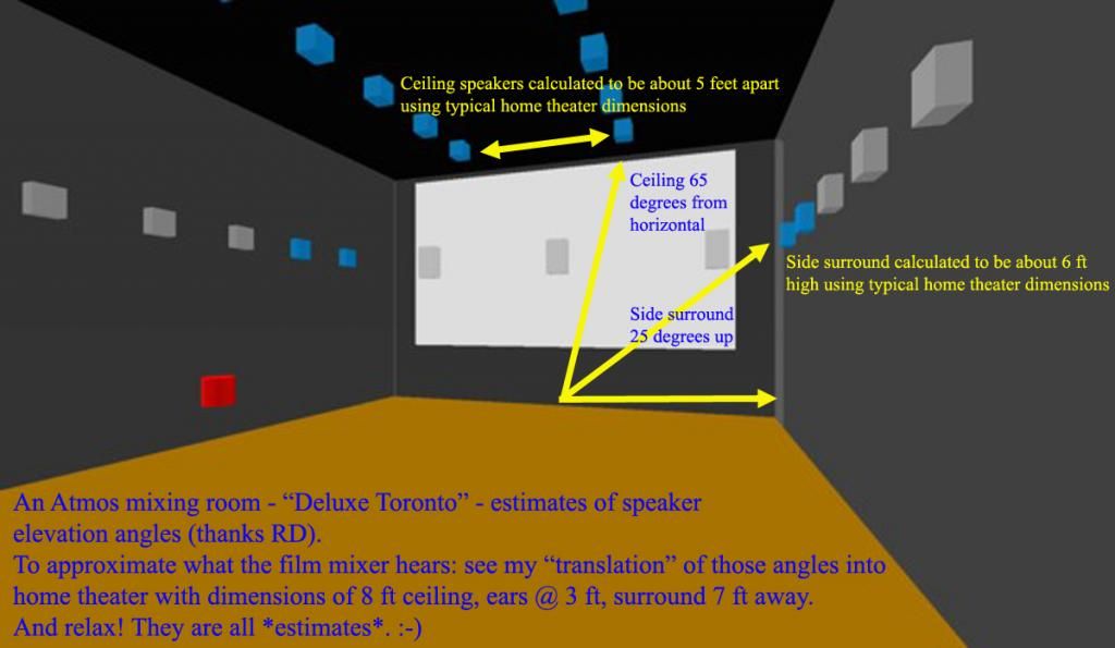

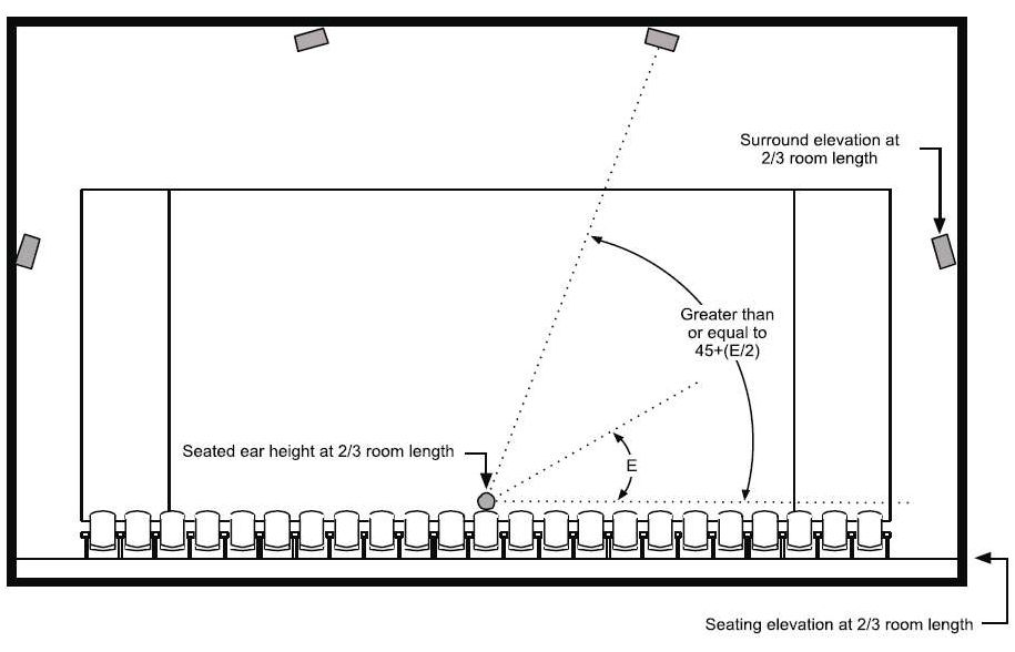

Where exactly are Atmos ceiling speakers and the DTS's "height speakers" at 45 degree azimuth and 45 degree elevation?
For me the main idea is that the 4 ceiling speakers of a 7.1.4 system should form a square approximately 7-8 feet for each side, with listener in the middle of this square. This forms the 3rd dimension dome of sound above listener. Smaller square would probably result in better central image/imaging, big square better peripheral image/immersion, but I doubt listeners would notice or care about the difference, within reasons. I believe larger/taller rooms with more rows should spread the ceiling speakers further apart, also within reasons.
Although Dolby Atmos called for the ceiling to line up with main speakers, IMHO it is better to have it closer together than the main speakers, because this is how theater Atmos is set up. AFAIK Roger (Dressler) also has his ceiling speakers closer together than the mains.
A note on "room correction": Room correction is ONLY for low frequency. If you are altering frequency response above 300-400 hz, it is no longer room correction. You are basically messing with the speaker's power response and altering the sound that the speaker designer wants you to hear.
A note on "target curve": My "favorite target" curve is modeled after the B&K curve by Henning Moller below. It has a shelf of 3 dB high in the bass, then a gentle drop of 3 dB in the midrange to the (arbitrary) over/under point at 2khz - where there is no gain, then a further 3 dB drop in the treble.
[/quote]
Ceiling height 8 ft, MLP ears at 3 ft, elevation angle 45 degrees, azimuth 45 degrees (I hope my calculation is right - it's been a long time since high school :)).
