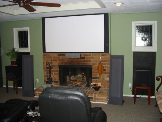

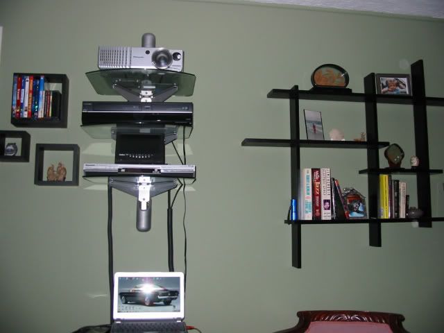

Pics of my set up or as described on another site "planar porn"
Front wall -
Juice and inputs -
Some more of the rear wall -
Audio/video -
MMGs
Emotiva Sub 12s
Paradigm CT 110 center
Paradigm Cinema ADP rears
Yamaha RX650 pre/pro
vintage McIntosh MC 2205
HP dm1 w/ NuForce Udac2
Panasonic dvd (no Blu here)
Panasonic PT - AE700u projector
83" DIY floating laminate screen
I didn't futz about too much integrating the subs, I crossed at 60 Hz and set the system up using an analog SPL meter - including test tones at the cross over for phase.
The room is 16' x 20' and the MMGs are on the long wall about 30" away, spread 8' apart at centers and symmetrically placed 6' feet from the side walls. Seating position is in the center, 8 1/2' back with 4' behind me. I have six 2" OC 703 panels on the side walls with bass trapping in the four tri corners.
Been experimenting with placement of the panels and as I can't do much about width due to the mantle I find that for now, moved a little further apart and ribbons on the outside seem to give the best sound stage.
OK..........I've shown you mine - now show me yours.
¿lɐɯɹou ǝq ʎɥʍ
citizen arcane is offline
