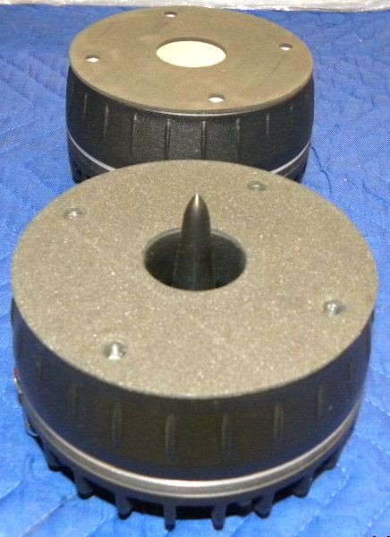

What is the model number on the compression driver Jeff posted pics of in his "2015 big year of changes." In the JTR forum?
I don't think Jeff is using BMS anymore except for the S8 series (4550). The HT models for sure not. The HTR version coaxial CD with that unique looking phase plug does not appear to be BMS either but I'm not positive. The previous coaxial CD was the BMS 4593ND

Originally Posted by countryWV View Post
I don't think Jeff is using BMS anymore except for the S8 series (4550). The HT models for sure not. The HTR version coaxial CD with that unique looking wave guide does not appear to be BMS either but I'm not positive.
That would be a phase plug and I am pretty sure they are still BMS, just a custom one that Jeff is using with that small modification.
Uh yeah I meant phase plug.
I have the 2015 212HTR but cannot figure out how to look inside. Is there an easy idiot proof way?
Yea looks lime a BMS, just surprised I hadn't seen this brought up before. I didn't know he switched from the BMS 4593. Maybe like you said a custom model for JTR?
If he is no longer using BMS I am surprised it hasn't come up in discussion. Thats an important part of the speaker! Maybe I missed it in my few month absence from the forums? The phase plug sure makes for an appearance change.
It's still a BMS coax compression driver.
