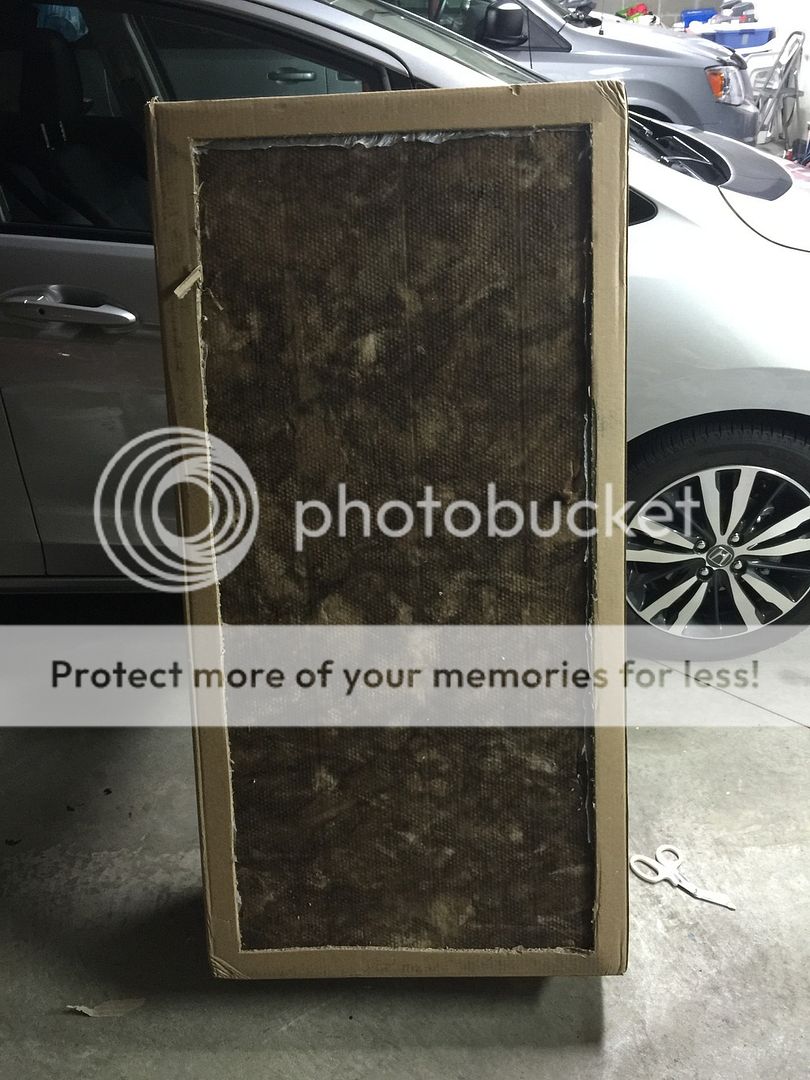

I ordered 5 boxes of knauf 1.6lb ecose insulation panels from GIK to use behind my screen wall. I received them last week and have been thinking about how I can wrap them and build wooden panels for them. After hearing Jeff say that to get rid of the SBIR interference you should have insulation equal to half the distance from the speaker to the back wall I decided I want these to be 1ft thick. They come 6 per box and each panel is 2 inches thick. The box they come in is just a 1/4 inch shy of a foot thick so they shouldn't really be compressed in the box.
I had an idea last night at about 3am when I woke up to get a drink. I thought about using the box to contain the fiberglass panels. I cut most of the box face out and figured I could glue some fabric over the exposed insulation.
These will be behind a screen so looks are not an issue. I also thought about cutting the cardboard off the back too, but if I have these up against the wall I am not sure there would be any be benefit. I could probably cut more off of the opening but I am not sure if the box would lose too much rigidity.
So do you think these ghetto bass traps/panels would work? They cost about $60 each box after shipping. I am not sure I really even need to wrap them. One side seems to be faced so there isn't any dust particles coming out even if you pat them.

Interesting approach, so the 210's are 2' off of the wall and you're covering the entire front wall with 1' thick insulation and Jeff at GIK suggested this?
The front of the 210 drivers will be about 28 inches off the front wall. Jeff (JTR) suggested having insulation equal to half the distance from the speaker to the front wall. it was in the thread about the data-bass test on the 212HTR
http://www.avsforum.com/forum/155-diy-speakers-subs/2213114-databass-tests-jtr-212htr-2.html#post39127698

Here are all 5 of my ghetto bass traps with some cheap black sheets stuffed in to keep dust at bay. The middle one was my first attempt. Need to pull the material out and redo that one although they will not be seen.
