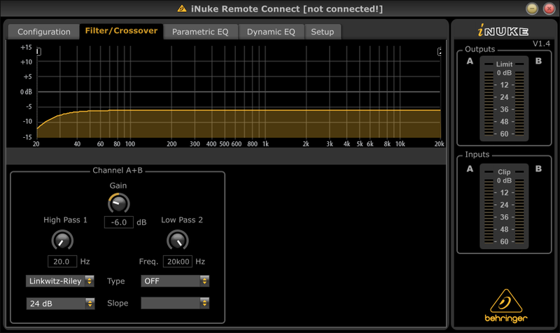

Originally Posted by SeaNile View Post
When "Right Surround" gets a test tone sent to it, the "Left Rear" surround gets the tone as well.
When "Right Rear" gets tone the "Left Surround" plays as well.
You need to make sure Mode on the back of the amp is set to Stereo and Crossover is set to Fullrange.
I'll ask this same question here because I know a few of you use the iNuke nu4-6000 for surrounds....
I'm about to go crazy. What I thought would take 30 minutes to hook up has taken me 3 hours and it does not even work right!
Marantz 7702mkII with an iNuke nu4-6000 to power 4 JTR S8-LP surround speakers. No matter what I do or how I change the wires when the test tone comes on to confirm X speaker is working nothing seems right.
It's a 4 channel amp and no matter what I have tried I can't get the 4 surrounds to play independently. It's driving me crazy!!!
I'm using the Neutrik connections with 1+ and 1- for pos/neg on each connection.
Any ideas???
There is a bridge-stereo-mono switch on the back, do you perhaps have that set on something other than stereo?
Edit - desertdome beat me to it.

Making my way through it all. Got it working thanks to you guys. Been sitting on the floor watching Roger Waters The Wall. Worth every penny!! Think I have the Crowns in bridge bypass mode. Not sure it's that's correct but I can't stop watching.
