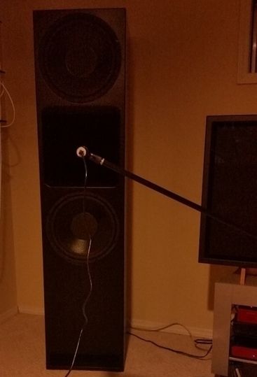

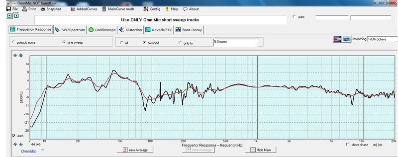

My Cherry amps showed up and I setup a little 2 channel system in my basement. There isn't any room treatment or anything yet.
I decided to pick up an OmniMic to familiarize myself with it since so many people have it
Here is the left speaker, in room, 1 meter, no smoothing, no eq, no room treatments

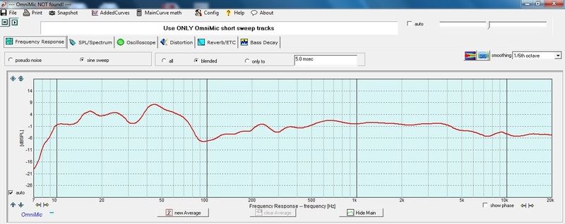

1/6th smoothing:
raw vs smoothed:

Nice!! Flat to 10hz!!!
I am guessing you don't have a HPF on these?
Are these the 2015 version? How far apart are these (cd to cd)?
