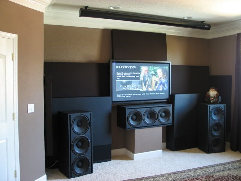

Hi,
I received my 3 triple 8s a couple of weeks ago and am still working on getting the most out of them. I really like them so far. Driving with 3 Marantz monoblocks (200 watts into 8 and 300 into 4 ohms). What I like best is the ease of sound.. no strain at any level I've tried yet.
I have two questions..first what are the advantages and disadvantages of crossing over to the subs at 80hz compared to 100hz? Either one better for dialogue? any other advangtages or disadvantages?
second, any suggestions for toe in for LR? They are 11 feet apart (minimum distance apart with screen position) at 24" high (on top of a pair of MFW 15 subs.. coax is in center position so LR coax at ear level) and the distance from the screen to the main seating is 12 feet. I have them toed in now about 20-25 degrees. Any thoughts on pluses minuses of greater or less toe in? (thx recommends pointing directly at the main listening postion.. but I've never done that before.)
Thanks in advance for any input.
Joe H
a few pics are attached
rman222 is offline

Nice set up! With regards to toe in the 888s have a large sweet spot so I would just try and toe in to reduce reflections off the side walls as they are close (the room treatments will obviously help). 80 vs 100hz will have little effect on dialogue it would do more to relieve some of the stress on the midbass.

So as I keep looking at the JTR's I have a placement question. How "bad" would it be to place them on the floor? The room is 12W by 24L and a 7 inch riser for the back.
If I place them higher what are the preferred ways and how high should they be placed? I kind of have to build this ahead of time as I am putting up a frame for the screen etc so appreciate any input.
I used to have 888s layed horizontally about a foot off the ground before I had my AT screen. On the floor is worst cast scenario because it way below ear level. The 888s have a wide sweet spot so it can be worked around. I used door stops to angle them up and then a laser leveler to line them up to ear level.
If on stands you can sit down and measure the height where your ears are. The tweeter is optimum at ear height so about 24" stands should work great. I have mine 36" high due to placement restrictions so I'm angling mine downwards but again not the type of speaker where if you move your head a couple of inches and the sweet spot is gone.
gpmbc is offline
post #86 of 37603 Old 08-22-2009, 06:53 PM
mhdiab's Avatar
Location: Anchorage, AK
Posts: 2,500
Quoted: 73 Post(s)
Liked: 42
Thanks 24 inches stands will work for the R / L with no problem.
I have more of a limitation on the Center since it needs to be below the screen. I need to get my drawing, but I think top part of the center (horizontally placed) can not be higher than 30 inches
mhdiab is offline
If you have the coax mounted in the center for all 3 of your speakers, then 24 inch mounting is perfect for the L and R. If you have a 30 inch top height limit for the center yours is almost the same as mine. I put the center horizonal with the top just at the bottom edge of the screen and angled up so that the coax center points directly at ear level. This style of speaker (according to the experts on here) is one of the few that works very well as a horizontal. I used a VTI center stand which has a six degree angled top plate and by adjusting the feet was able to get it positioned perfectly.
Good luck... they will work really well like that.
As everyone has said the alignment of the LCR coaxial driver's is important as well as having the coax as near as possible to LP ear height. I have 12LF's and my left and right (mains) have the coax in the top position (special order) with the center channel's coax positioned normally in the middle. When I originally purchased these, I had an AV cabinet with all of my equipment under the center so this alignment was preferred. I have since moved the equipment outside the room and had to build the stand you see in the picture below to bring the LCR coaxes into alignment.
As the T8's are only 26 tall I think it would be a good idea to place them on stands but with your 30 height limitation for the center, that is a pretty short stand. I'd do mock ups (temp stands) with all vertical (LCR) placement and angle them up a bit and see how that sounds before trying the horizontal center.

Thanks for the advice everyone. Yeah I was really considering a perforated screen to put the speakers behind, but decided not to do so. So now I have the 30 inch limitation to get the center below the screen.
Think it will work good anyways, but we shall see. Appreciate all the feedback
