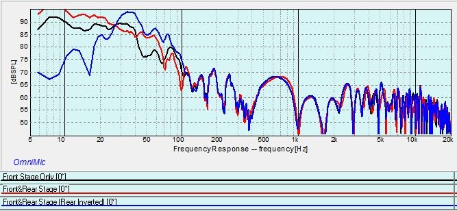

Originally Posted by Gooddoc View Post
There is not a good answer to the question because a lot of this is more theory and ideal scenario dreamland than real life achievable stuff(re: industry standards).
I just spent considerable time placing and optimizing my four subs and then I followed that up with an Audyssey Pro calibration.
Here's my three front row seating positions:
Now, I try not to drink too much of the Audyssey Kool-Aid, but I do have to admit that I do think these curves represent the best chance of hearing the soundtrack as intended. That being said, my preference is for a bit more bass, perhaps a 3dB boost, but my opinion is that this bass boost probably moves me a small step away from the chance I'm going to hear the soundtrack as intended. A 10-15 dB boost seems to me to reasonably eliminate the chance you're hearing an accurate reproduction of intent.
And I'm NOT saying that is bad, I'm just saying it is preference, not a better reproduction of intent or accuracy. But, I can't stress enough that this is all just my current opinion, subject to future change as a result of any potential future enlightenment biggrin.gif.
Actually run a few high DB sweeps with speakers disconnected - checking for any compression with sub placement - if holds same response up to your expected reference levels
pack the measuring gear away and bring on the music and movies. Looks great - enjoy

Originally Posted by GPBURNS View Post
105 dB full sweep. Looks like an f3 of around 8 Hz. Not crazy about that dip at around 800 Hz
115 dB subs only. You can see where my CHT 18.1's (HPF=45 Hz) are a little hot compared to the JTR S2's
Hard to do full sweeps above 105 dB. Just too loud. Even above 115 with the subs only is getting nuts. I'll never know how you guys can tolerate 130-140 dB eek.gif
Overall, not bad. I need a couple more S2's to replace the CHT's, but things are ok for now. I have other audio/video fish to fry right now (PJ/screen, etc.)
Gooddoc is offline
earplugs help when doing silly loud sweeps

Originally Posted by GIEGAR View Post
Yea, I think your right. biggrin.gif The dip at 2 kHz is the Audyssey midrange compensation dip. I'm real happy with where things are, at least until the next sub purchase. I'm shifting focus temporarily to my PJ and screen purchase. Time to just enjoy for a while wink.gif
