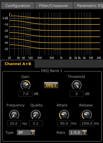

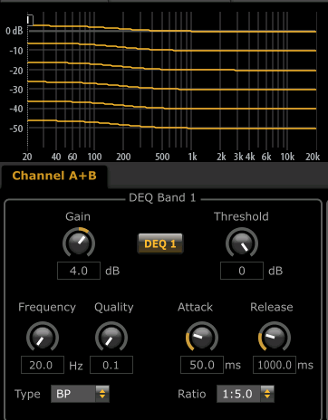

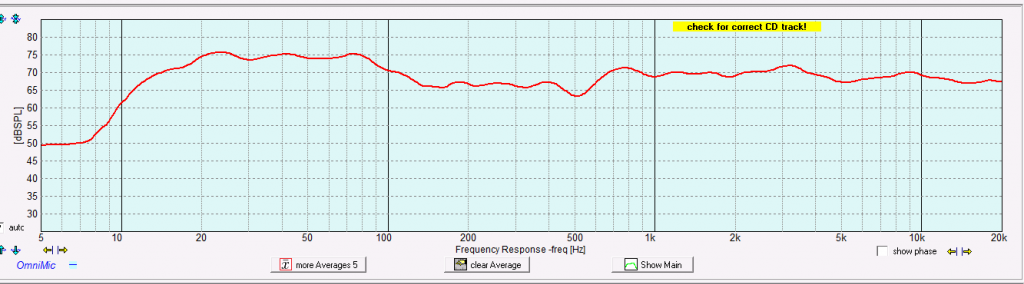

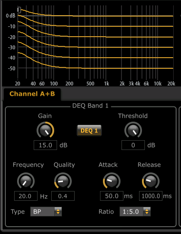

Judging from Jeff's impressions of my setup and how much he liked my curve, I would work towards something similar to this:
I tweak all the bass all the time, but here is what i had it the inuke dsp set to last ^. Pretty similar to yours Brandon, except for you have more bass up to around 150hz, I'll try that out! Do you set the bass and forget it or do you tweak it a lot when listening to music?

Haha, pert near close! I mess with sub level trim and on occasion will mess with XO points, but no eQ anywhere. That is crossed at 100hz and is usually where I have it 95% of the time. The bump at 150hz is natural too, no EQ there needed either, straight organic.
I have found that I like the dynamic eq function on the inuke for tweaking bass a lot more than messing with eq, it's a lot simpler/faster. However for the 150hz bump it looks like I'll have to try eq, the dymanic eq isn't specific enough.

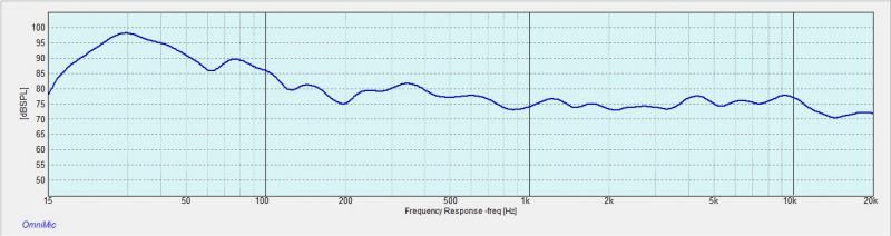

Here is a sweep with no boosting of the bass at all and like the other graph 215's only, this is another reason why I don't like Audyssey. I guarantee that that bass would be pulled down if I used Audyssey but when you hear it like it is ^ it is as little of bass as you would ever want - meaning it sounds nice and not anemic but still not enough (with the exception of some bands/albums - Dark Side of the Moon would sound great like this ^ for example).

That is where trim adjustments are nice, or your amount of dyneQ boost I guess as you sort through different genres and even different musicians the target often changes. I can get crazy silly with the sub trims listening to some metal albums, but I have to seriously dial it back down when I go back to rap or dub stuff, where there is already a decent amount of bass going on.

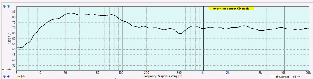

Yours and Brandon's curves look nice and a good starting point for Coach...except for the huge drop-off at 8Hz. What the hell?
dgage is online now
