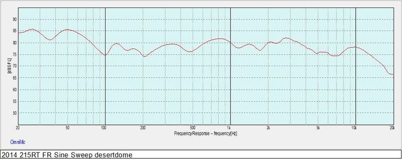

Here is a Omnimic FR measurement taken by desertdome at the 2014 215RT GTG.
I know the noise floor is what it is.. but still would be nice to know exactly what my room's noise floor is
Thanks for the information RMK! So, follow up questions, why point the mic up? I would never have thought of that, for instance.. shouldn't i point it at the front? like how we are seating and looking at the front?
The example sweep you provided, what sort of smoothing is that? 1/12? 1/24? this is another confusing variable, what sort of variables should i set in the software?
And last but not least, what is a good bass decay rate? does anyone have a good example of a graph by omnimic?
That measurement was taken 1/12th and that is generally the recommended level

Ok, now that i have the Dayton Audio omnimic and software... what do i do and look out for?
Here's what I am thinking..
1. Look at the freq resp graph when everything is silent.. basically see how quiet the room is..
The Frequency Response tab can only be used with Omnimic sweeps. The noise shown when no sweeps are playing isn't accurately indicative of the noise floor. When nothing is playing, you need to use the SPL/Spectrum tab to see the actual noise floor. However, the Omnimic self noise swamps any attempts at seeing the actual noise floor except in the bass region. My Earthworks M30BX has a noise floor of 22 dB and is better suited for noise floor measurements. For a noise rating or noise criteria measurement of the background noise, you need to use ARTA with a low noise microphone (see page 150ff in the manual). NC20 (noise criteria 20) is the recommended level by some home theater designers. Here is a chart showing that NC20 still allows for a noise floor of over 50 dB at 63 Hz.
You point the microphone at the speakers if using the default calibration file. If pointing the microphone up you need to manually make a calibration adjustment based off the rolloff shown in the manual.
Regarding measuring for 7.1, I always use track 6 (Left Channel, Short Sine Sweep) and the Order Channels feature in JRiver to quickly move the track through all speakers to take measurements. It only takes a minute to measure all the channels. If measuring with a receiver in the signal path I just use the HDMI output from the laptop into the receiver and still playback through JRiver.
DesertDome, as usual, you truly know your engineering stuff...
And where does one go about obtaining one of these very low noise floor, high quality USB mic? What can I do with the Omnimic I have then? (it's calibrated).. if I can't trust it to measure correctly, then wouldn't all my measurements with it goes out the window? Do you happen to know the dB range of that mic in terms of accuracy?
ps: I noticed the chart you presented loses about 5dB from 5Khz to 20khz... is that a good thing or should a flatter one be better?
In blind tests it has been shown that the majority of people prefer a rolling off just like you see in DD's graph. I am not that way. I actually like a flat response up to around 8khz and then RISING above that. These are NOT harsh frequencies, they add air/sizzle etc. I've tried EQing the response to look like DD's many times and it sounds dead to me.
I probably just need to get used to it, but I can't. My ears crave some sparkle.
"DD's graph" is the actual "Mic facing upward compared to mic facing forward" graph from the Omnimic manual and isn't an actual room sweep. The point is don't face the mic upward and then use its measurement (unless you have adjusted your omnimic calibration file) to try to flatten or have a rising response in the high frequencies.
desertdome is online now

Desertdome,
I've not been able to find much solid information on the direction of the omnimic mattering? Isn't that kind of the point of the name? omnidirectional?
The manual says the omnimic should be pretty much omnidirectional in measuring accurately, with the variance being a 3dB difference at 13kHz between pointing up vs pointing the mic to the speaker.
Is that not what you've experienced. I can't say I've ever noticed much difference between holding it different ways if the tip stays in the same place.
http://www.daytonaudio.com/OmniMicV4/hs230.htm
From the link:
Omnimic is a small capsule, narrow tip measurement
microphone and its response is essentially omnidirectional at most frequencies.
At very high frequencies, there is about 3dB reduction in response at 13kHz, as
can be easily determined by making a set of comparative measurements with the
mic pointing at and then perpendicular to a high frequency speaker.
RMK! likes this.
Gotcha. It does look like the curve that they say most people prefer though.
carp is online now

Desertdome,
From the link:
Almost all microphones are omni directional. However, when a microphone is also measuring the reflections in the room, the response changes. There is what is called a free field measurement and a diffuse field measurement. Free field is typical of a close mic measurement and is what the Omnimic was originally developed for - making measurements of speaker drivers to design crossovers. The further you get away from the source, the more you are in the diffuse field. A free field measurement is taken without any reflections and a diffuse field measurement is a measurement taken in a reverberant room. Since most are taking measurements from the listening position, they are taking measurements in the diffuse field. In this case, the microphone is experiencing the rolloff shown by the vertical Omnimic graph even if the microphone is pointing at the speaker. Depending on the speaker and room, the microphone can vary in its upper frequency rolloff between a horizontal or vertical mic, but it still exists. For this reason I usually use a diffuse field calibration when doing any room EQ. The Omnimic comes with a free field calibration file, though.
Summary - The closer you are to the speaker, the more difference there will be between vertical and horizontal microphone placement. The further you are from the speaker, the more similarity there will be between the vertical and horizontal microphone placement with the tendency of the measurement to be be that of a a vertical placement. When I say "vertical placement" I just mean the rolloff in the measurement more closely tracks a vertical or diffuse field calibration.
The gating used also effects the rolloff. In the Omnimic software this is changed by selecting "blended" or specifying "only to" a certain time limit on the Frequency response tab. Remember the Bill Fitzmaurice DR250's? We were using a gated semi free field measurement to determine SPL. A diffuse field measurement, by using "only to" and setting a longer window or using the RTA would have more accurately showed us the much higher SPL at the higher frequencies. A frequency sweep in the Frequency Response tab cannot be used to level match SPL between two speakers.
Because it is so hard to ascertain what is really accurate in the upper frequencies when measured at the listening position, I like to design a room correction target in Audiolense that matches the actual measurement.
It wasn't until I got my iSEMcon microphone that included free field and diffuse field calibrations and comparing to real measurements that I started realizing this.
