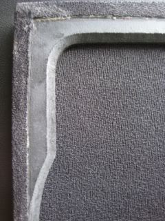

Here are the pics of the 45 degree bevel on the frame of the WAF-1 grille. Since grille cloth is stretched around a frame, Any speaker that has a conventional grille that attaches to the speaker with pegs that fit into holes in the front baffle, will have the frame extending out past the driver. The WAF-1 frame is only 1/4" in thickness (I gave Craig the 5/16" dimension, but on remeasuring 1/4" would be more accurate). On top of that, the bevel helps reduce the already minimal effect of the frame even more.

Originally Posted by craigsub View Post
The bevel ....
There have been some comments on the bevel frame around the WAF-1's.
It measures 5/16 inch thick. If one removes the grill, one will notice that the frame is angled out, making for a very small waveguide into the bevel, at about a 45 degree angle. The grill is flush to the edge of the speakers, again making for an integrated look, and performance.
Jack (Rijax) has a pic that we will get posted later.
That's not a waveguide...
lmao
That image make it look like the grill has been assembled backwards... Like someone glued the speaker cloth on the wrong side... Is it really like that?
How it should have been built:
(represents the grill viewed from top, the front of the speaker pointing up)
Arguably, this could have been considered some kind of horn...
Code:
      driver
But the way it seems to be assembled:
      driver
So actually, this has absolutely nothing to do with a waveguide, not even a horn since it seems to be inverted, it's actually the opposite of a horn... A real waveguide is supposed to 'guide' the (sound) waves (waveguide) and not just cause extra diffraction... How could an inverted horn guide anything?! The grill, as is, makes zero sens as a horn or a waveguide, makes as much sens as trying to play a trumpet or a sax from the opposite hole... (the hole where the sound comes from...) Absolutely no sens whatsoever...
Read on waveguides: http://sound.westhost.com/articles/w...des1.htm#intro
I don't know what's the joke here... Calling a 45 degree cut in the wrong direction a waveguide, or if it's bad production and QA and there's a couple defective grills out there... Or if it's a plot by craig to generate more drama by saying ridiculous things and call people troll when they rebuke his silly statements...
Anyhow, /me is
Here you can see a real waveguide, note how it's shaped to guide the sound waves...:
top view:

Well it depends how you view things. 1) I don't think people should start calling things which are not waveguides waveguides...
2) "non-issue when looking at the FR graphs", yeah I completely agree. This will in no way affect you when you're looking at the FR graphs.
Anyhow, does this affect performance? It most probably does IMHO, negatively. But it's all tradeoffs. He wanted a grill built in the cabinet, and he had to work with what he had... Anyhow, I don't know, maybe the person who actually designed the speakers can come forth and explain it, that would be interesting. But in the end, 230$ speaker, that's how they are, they don't use any kind of waveguide, manufacturer's measurements have been posted, they look pretty good, so that's that.
Hey, I'm not bitching or anything, that they're made like that, I'm just saying, that their grills are not waveguides, and that no, the waveguides that they do not have, will probably not improve anything, quite the contrary, IMHO, such grill, with an "inverted horn waveguide", call it whatever you want, will instead have a detrimental effect on performance. IMHO. YMMV. Calling that a performance improving waveguide is simply marketing spiel...

Is the grill frame made from MDF?

craigsub's Avatar
Posts: 11,550
Grandarf,
There is a thing called context. The context of my post was in reference to the small lip which frames the WAF-1's. There was some concern regarding this lip.
I never said the WAF-1's were a waveguide loudspeaker. I was pointing out why we designed the grill as we did.
In a waveguide loudspeaker, the waveguide is used to direct the sound the designer wants you to hear in a controlled pattern.
With the angle of the bezel into the lip, we are using a small waveguide to help ameliorate any small amount of soundwaves which might "bounce" off the lip. We are using this small waveguide to keep unwanted sounds from reaching one's ears.
This is a simple solution to a very small problem in a budget speaker.
In listening tests, the WAF-1's sound better with the grills on than with them off. It also measures better with the grill on than off.
Grandarf,
Yes the context is indeed important.
The bevel ....
The image, showing the 45 degree angle cut, the so called 'waveguide':
Bzzzzt!! Wrong, that's not a waveguide, especially if it is as I've already commented, cut on the wrong side...
Now it seems you've changed your story, what is it that they say about craig? "This is a typical "Craigism". Truth is not the object. Winning the argument at any cost is."?
As you'd say, we both know that's not what you've said and that's not what you wanted to say either. With your new tune, seems like you're talking about the cabinet's rounded corners to try to reduce diffraction, and the slight angle in the protruding edges of your baffle. (but it's very vague, lip?! "help ameliorate any small amount of soundwaves that bounce off the lip"?!) That seems good in theory, but the problem you have now, is that instead instead of just having rounded corners in the case where you remove the grill, you now have to deal with the grill's diffraction, or the cabinet's protruded edges... Now I know, you'll say it was designed with grills on. Well, again, the 45 degree angle of the inside of the grill will be a source of diffraction, which, again, you'd simply not have on a speaker with no grill and no protruding cabinet edges.
And anyhow, again, to beat the dead horse, the rounded corners and small angle at the protruding cabinet edges have absolutely nothing to do with waveguides. Saying that it is, is "a typical "Craigism". Truth is not the object. Winning the argument at any cost is."
