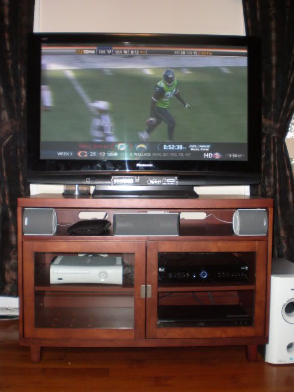

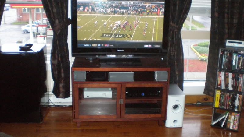

Goros,
You state that its ok to have it ABOVE the TV, I may have to do this in my setup because the cabinet of my TV stand is not big enough to hold a center channel speakers any bigger than 4.5 inches tall...
So if I put say a Polk CS10 on a custom shelf above my TV with 2 Klipsch VB-15's for my fronts on either side of my TV that would work?
(Pics are with my current/old speakers that will be replaced soon with the speakers above)

Yes, it will work. I won't advise you to mix a polk with klipsch in the front soundstage because you'll probably find the timbre and sound characteristics could be drastically different. (voice matching)
Look here for dolby's setup (which calls for below) and look here for THX (which calls for below as worst quality, above as better, and behind the screen as best, but only if you have a transparent screen and a projector.) Somewhere in the middle is your best bet.
