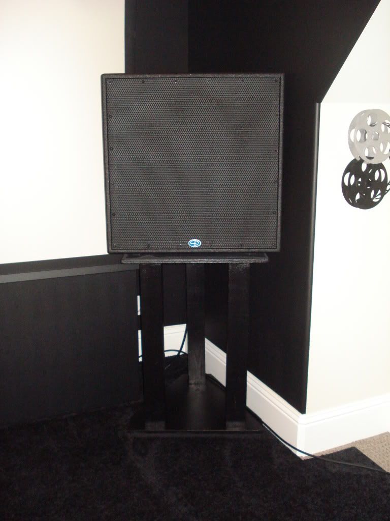

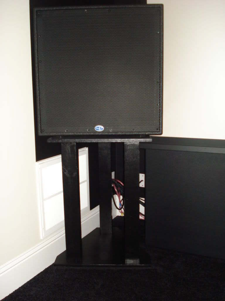

Last night I worked untill 2:30 am building my speaker stands for the SH50. I also finished up some speakon cables and have it all going into my closet in the home theater. It will be nice now as I wont be able to hear all the fans. Here are some pictures. The stands look better in person. This is a dedicated theater room however it still has got to look nice. The DANLEY SPEAKERS ARE BEAUTIFUL AND PICTURES DOES NOT DO THEM JUSTICE.
I just built the stand for the SH69 and will paint it tomorrow. I also hooked up the 2 SH50 and watched a little Avatar and listened to some music. What you notice immediately is the mid bass slam. I only have the one Crest 9200 amp right now as Im waiting on my other amps to arrive. I turned the gain knobs down to the 12:00 position and just coasted along. I really love the sound of these speakers. So I was listening with no center channel or no surrounds. Whats noticeable is you dont pick out where the sound is coming from. It actually sounds like its coming from the center of the room. Its going to be a huge improvement over my last set up.

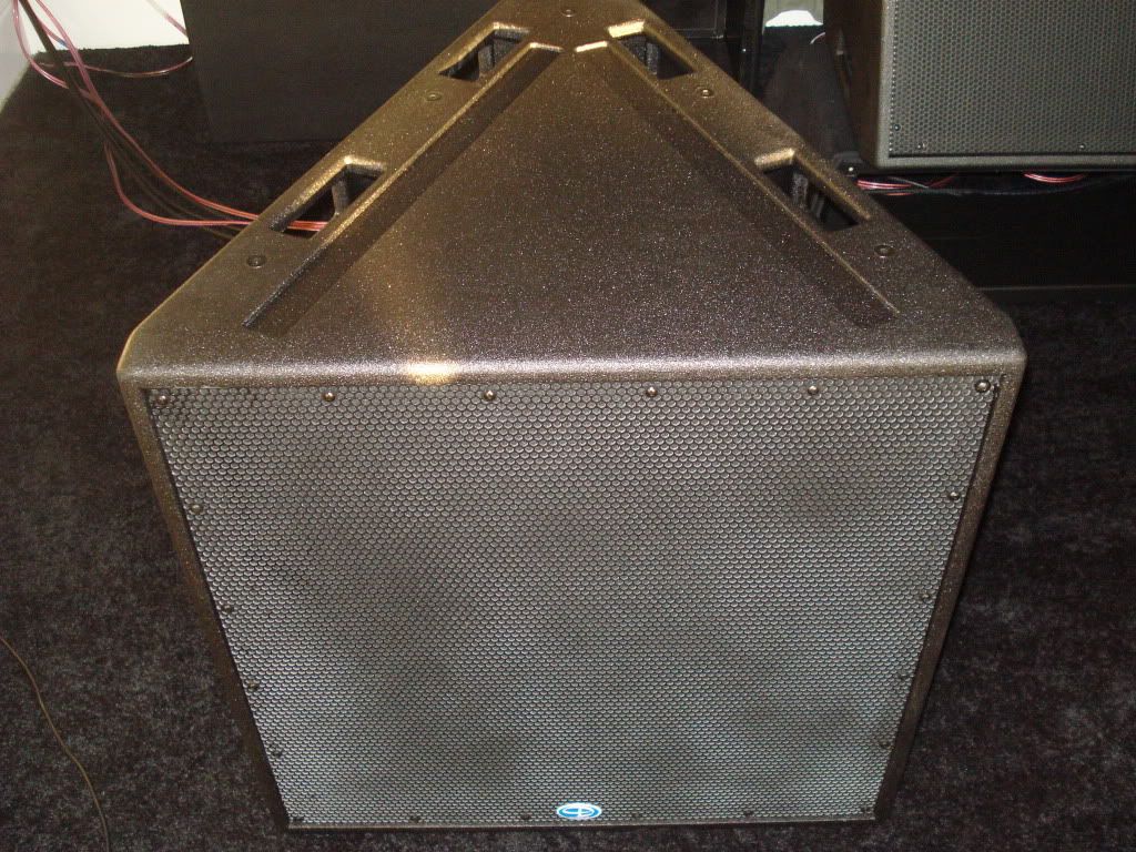

Originally Posted by kutlow View Post
The only thing I would change on the Danley gear is the color of the Danley Emblem. It should be black and siver. Can they be ordered in a different color?
That is the biggest complaint we get. The logo.
We went through a lot of decisions, and that is the on that was finally decieded on. For most in the process it was the "lesser of the evils".
The reason for the blue, was it is part of the overall Danley "image", kinda like the orange JBL logo.
You can't order them in a different color (unless we order a large number of them), but you can simply peal it off.
Part of the problem with trying to "badge" a product is how to make it "stand out" and be easily recognized at a reasonable distance. without looking too "forward" or cheap.
We have a good number of people "over seas" that think the logo is no where near large enough.
Here is a photo of a local distributor who did this on his own
http://www.danleysoundlabs.com/danleyport.asp?ID=50
Some put even LARGER logos on the cabinets that take up almost the full grill.
Different people see it different ways.

post #299 of 751 Old 04-22-2011, 06:54 AM
Ivan Beaver's Avatar
Posts: 1,660
Liked: 57
Then I spent about 500.00 in speakon wiring, 500.00 for the electrician to run 4 dedicated lines. yada yada yada and now im eating my sons school snacks. lol Oh and his allowance is temporary shut off due to the recession. lmao
It's good to know that you have your priorities straight!
