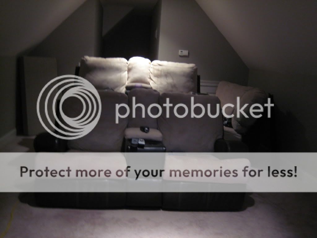

Iam trying to figure out my coverage needs:
Room is 12.5 Wide 8 High 21 Long (Valuted ceilings) knee wall is 49" tall
Listening position can vary 10-18 feet from plasma.
Iam looking at SH50's (stereo pair, for now), would they be too narrow of coverage in my room, center would come later.
bodhisafa is offline

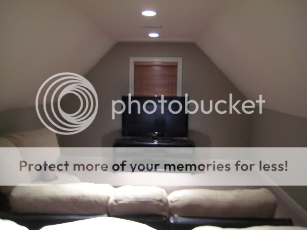

post #454 of 751 Old 05-22-2011, 03:41 PM
bodhisafa's Avatar
Join Date: Jul 2009
Location: 39046
Posts: 523
Dont mind the love seat on the side (sorry for the blurry pic)

post #456 of 751 Old 05-22-2011, 03:59 PM
Ivan Beaver's Avatar
Posts: 1,657
Quoted: 16 Post(s)
Liked: 59
If you place them against the side walls (they will be angled in), you would gain a couple of things.
The width of the "soundfield" would appear to be wider than it physically is.
YOu would have less reflections off of the side walls.
You would also pick up a little more bass from the left/right mains.
If you want a little bit wider-you could go with the SH60. Same sound-just a wider coverage pattern.
I would like to see them a bit higher than your ceiling allows-so a bit of playing in that area may be needed.

Ivan,
So you are saying the SH 50 would not be appropriate for this room. Its only temporary (the room) eventually I will move to a new space.

I don't believe that I was saying that the SH50 would not be appropriate for the room.
Mainly that they should be a bit higher and the ceiling allows-but that would apply to any loudspeakers.
Since the Danley products have a sharp cutoff at the edges of the pattern (which can be good and bad at the same time), I generally advise going to a wider pattern to make sure everybody is in the pattern.
Especially if you are going to be moving and don't know what room you may end up with.

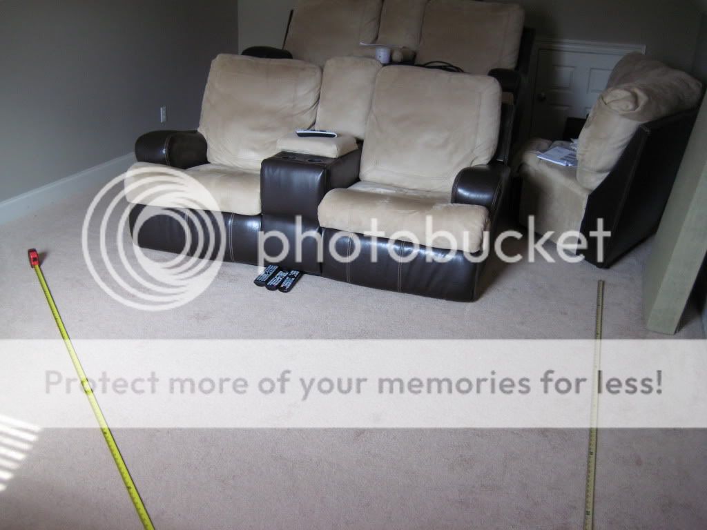

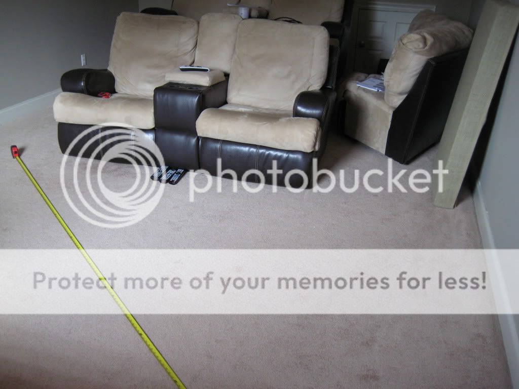

Using a protractor I mapped out the 50 degree angle and this is what I came up with.
Right Chanel:
Listening position 12 feet, SH 50 up against knee wall (wall is zero degrees), center of speaker about 44" high

post #466 of 751 Old 05-23-2011, 07:46 AM
bodhisafa's Avatar
Join Date: Jul 2009
Location: 39046
Posts: 523
Same situation as above except speaker is now 18.5" away from knee wall, putting center of speaker about 64" high

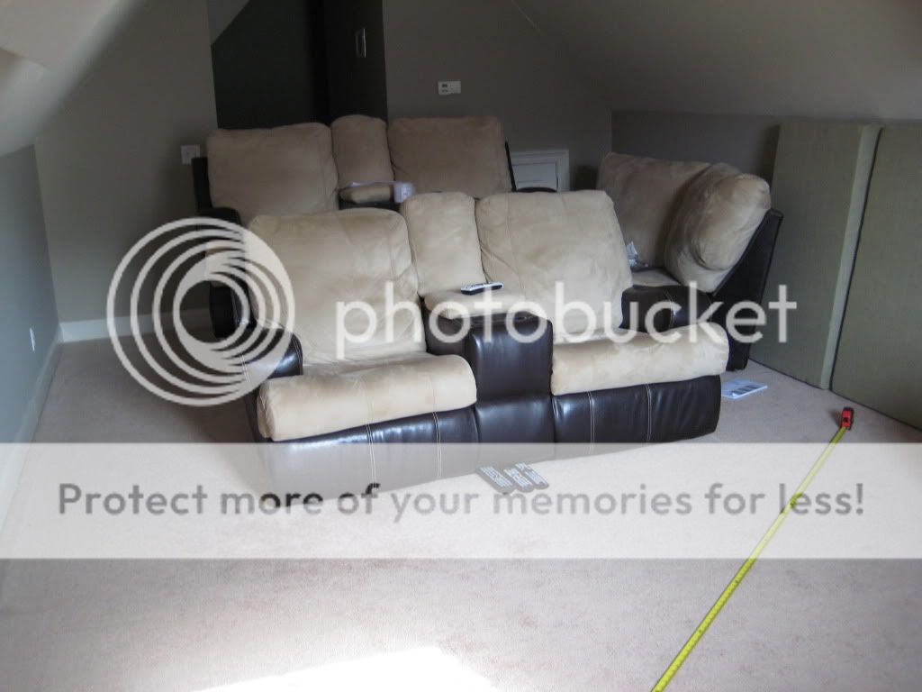

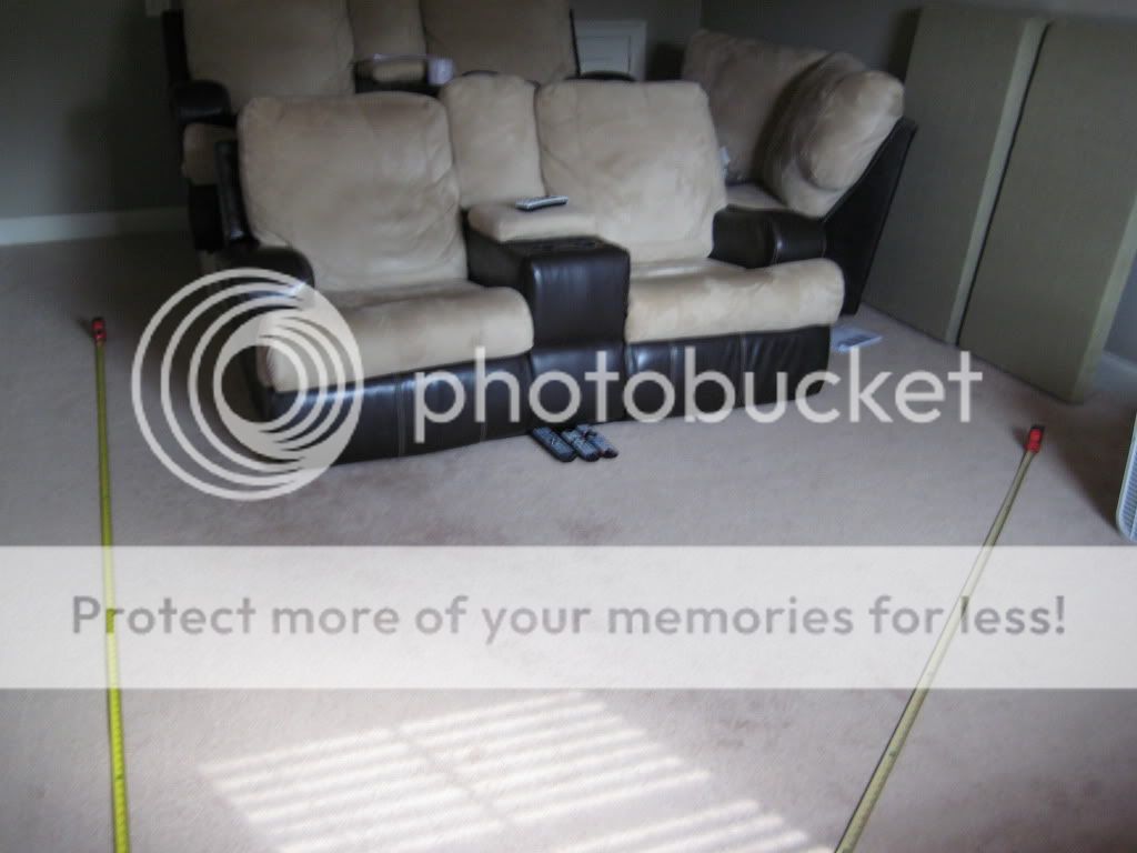

Location: 39046
Posts: 523
Left Chanel: upagainst knee wall (0 degrees), center of speaker about 44" high, listening position 12 feet away.
post #468 of 751 Old 05-23-2011, 07:53 AM
bodhisafa's Avatar
Join Date: Jul 2009
Location: 39046
Posts: 523
Left chanel: 18.5" away from knee wall, speaker center about 64" high
post #469 of 751 Old 05-23-2011, 07:57 AM
bodhisafa's Avatar
Join Date: Jul 2009
Location: 39046
Posts: 523
This is the best I can do at the moment, please critic my methods.
Moving the speaker in towards TV, gives a few extra inches to play with, not sure if thats enough?
What do you guys think?

post #470 of 751 Old 05-23-2011, 08:19 AM
Tom Bley's Avatar
Join Date: Jan 2001
Location: IL. USA
Posts: 3,127
Quoted: 707 Post(s)
Liked: 639
Looks like you are good to go or if you wanted a little wider coverage patten you could always go with the SH-60.
I feel that's very solid front row coverage. The listener's head is multiple feet within the 50deg pattern boundaries. Obviously there are no horizontal coverage issues for the deeper rows, but vertical may be an issue for ideal coverage. Since this is a temporary situation it doesn't seem worth much worry as you can correct for it later on in the new room. Curious what Ivan's take is.
