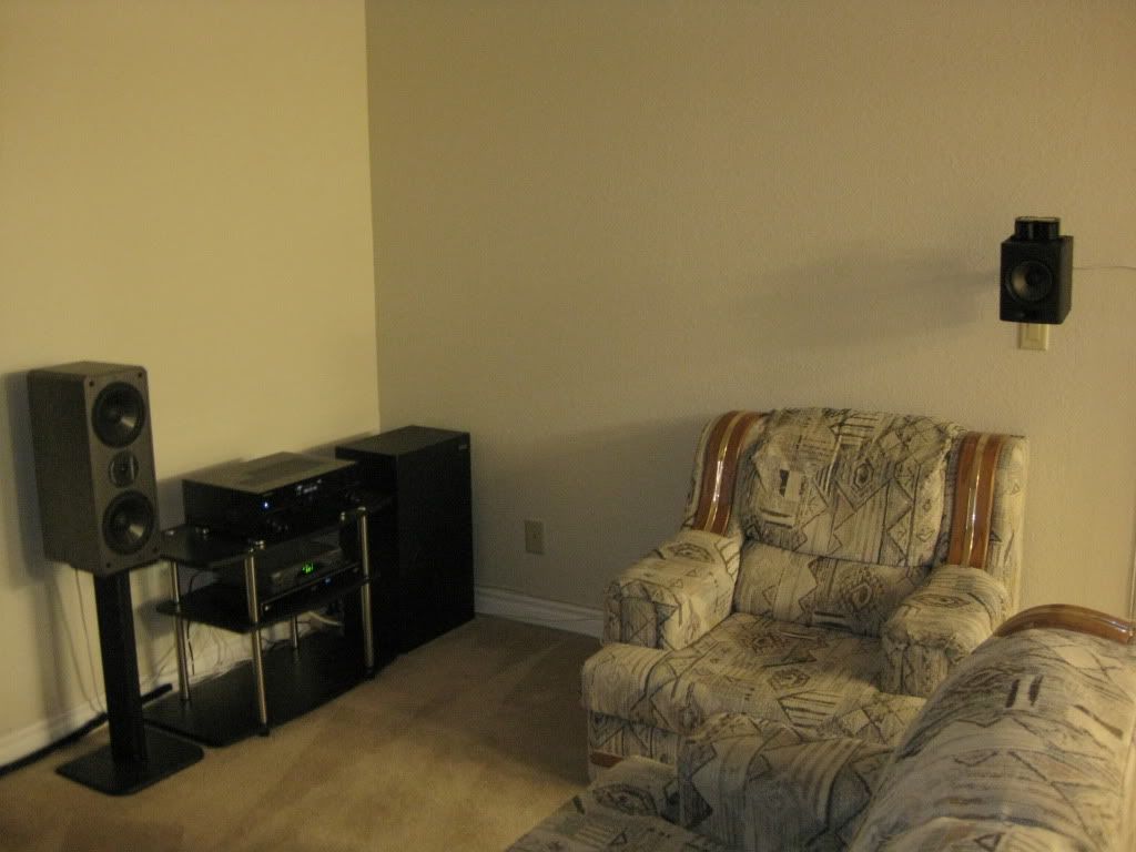

is it "bad" to have bipole/dipole speakers (i.e. Energy RCR) mounted on my back wall a foot behind my couch? Or should I aim to have it place on the side wall?
Also from what I understand the speakers should be mounted approx 2 feet above ear level when sitting? Correct?
Thanks in advance
