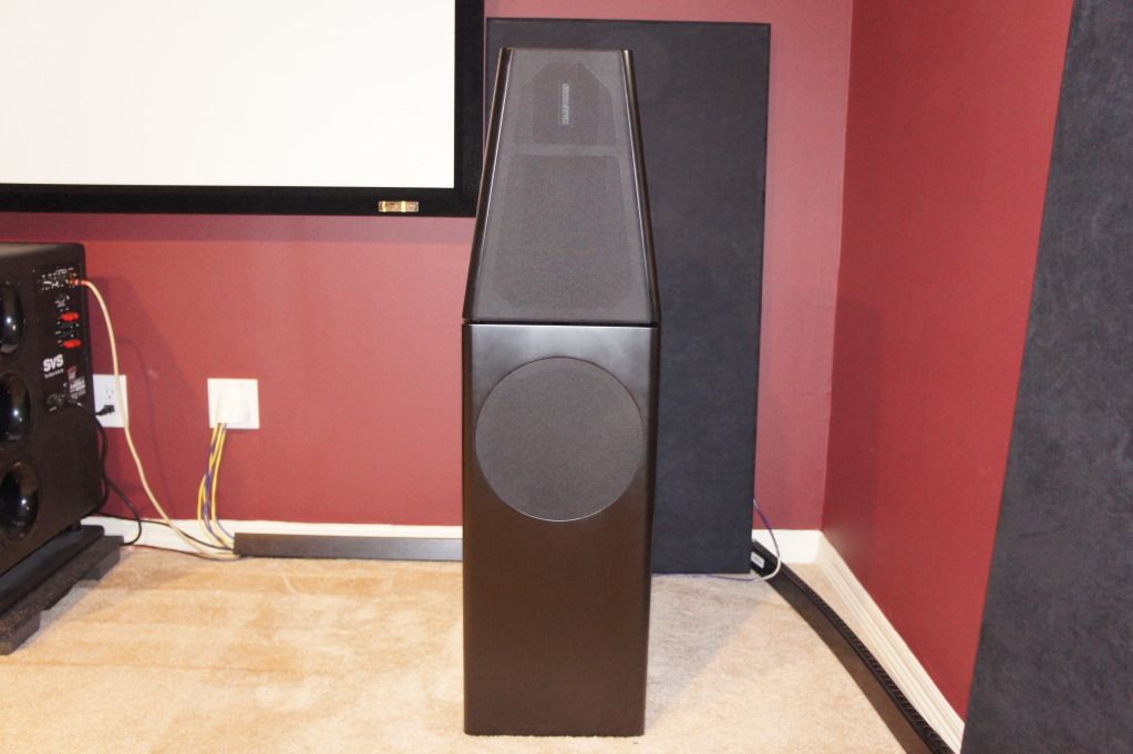

Dennis - The Philharmonic 2 are amazing. Thanks for all your thoughts on my room and music tastes and what would work well.
and 10 feet of cat since its the internet
I have ordered the center and should get it soon, will update accordingly (and move the sub back over to the right a few feet)

And thanks for taking the time to report and take many, many pics in your Black Hole room that lets no light in or out. Your center will go out tomorrow or Tuesday.
Dennis Murphy is online now
