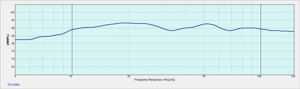

Old 11-20-2011, 08:52 AM - Thread Starter
MKtheater's Avatar
Location: New Hartford, NY
Posts: 17,003
Mentioned: 88 Post(s)
Quoted: 1589 Post(s)
Liked: 1116
Hi Bill, what do you think of my idea or just keep what I have?
OK guys, here is a sub response using the omnimic system.

Old 11-20-2011, 09:58 AM - Thread Starter
MKtheater's Avatar
Posts: 17,003
Liked: 1116
Btw +/- 2 DBS from 10-150hz is pretty good and +/-3 DBS to 7hz and +/-5 DBS to 5hz.

Now, on to your OmniMic graph, what level of smoothing is applied, and where exactly is the measurement taken? How hot are your subs relative to the midband? What kind of signal shaping, etc., is applied with the subs in the graph? Have you measured/calculated how much PVG you've got, and where it kicks in?
Have fun with the OmniMic, it's a nice tool. I've been playing/experimenting with it's capabilities for a year now.
All the best
