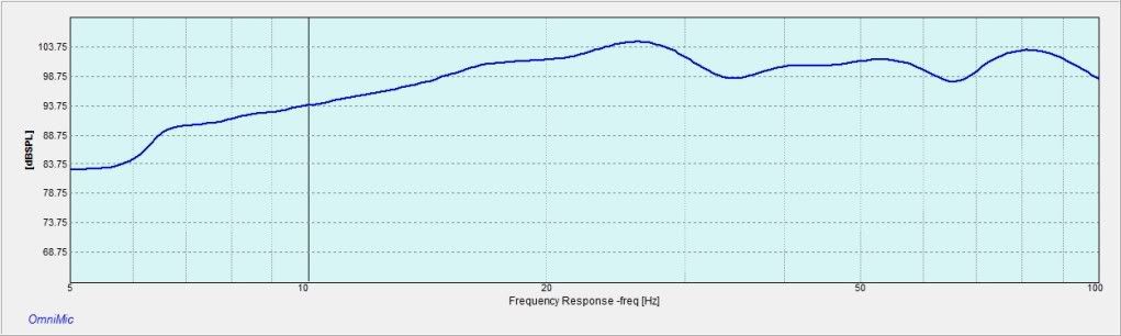

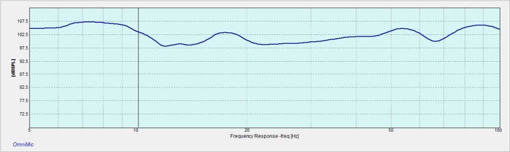

Not yet. I did finally get omnimic working and measured my subs with and without EQ. Here are the differences:
Without EQ
WITH EQ
I copied the original graph to REW and applied EQ for the filters and then put in the filters. It makes manual EQ a breeze. The only problem is that most of the time REW recommends more filters that I have. I am running them flatter than this right now and the low frequencies are much better as they are not masked by the midbass anymore. I can feel every ripple and shake now rather than that crazy loud audible bass(was good though). I ran this at reference and I used Tron as the demo and it was quieter and more visceral at the same time, I liked it much better than before.
I am having the BFM DR-280's built for me and using my DR-200's as surrounds. To me this will be the ultimate cinema experience and I will add more low end too!
Marantz 7702 Atmos
MKtheater is online now
WITH EQ
That looks good, but I noticed you mentioned REW recommends more filters than you have. This is one downfall of that software's auto filter suggestion, as it's best to use as few filters as possible; the more you use, the less headroom you have, especially when you EQ down low. Try manually adding your own filters (as few as possible) to EQ the response (when you do so, watch the predicted graph line to get the desired response); only fix the necessary portions of the response.
Not yet, I am going for more!! I want to get rid of the notch below 6 hz
Good look. Anything that low in the response won't be measured accurately and is likely an anomaly. I wouldn't bother. I highly recommend checking out some of the REW threads over at Home Theater Shack's forums. There are some real REW guru's and some of them have written some enlightening articles regarding the software that might aid you in your quest.
