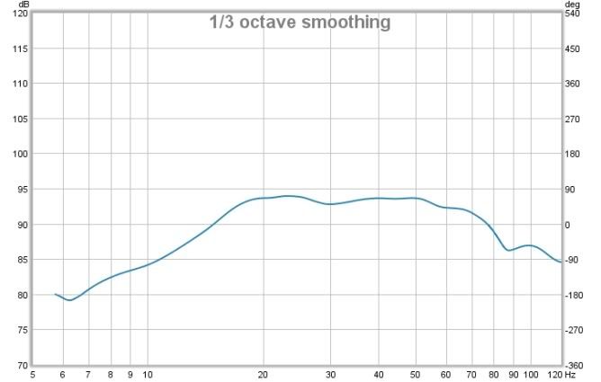

Here is my sub's response at the LP.
I am using the digital rat shack meter on c-weighting, no cal files. The DR's still can sound rough at times but during Tron it was very clear and effortless. I need to run the M&K's and Triads the same way to be sure.
Marantz 7702 Atmos
MKtheater is online now
post #99 of 1149 Old 08-14-2011, 03:02 PM
Gooddoc's Avatar
Join Date: Oct 2004
Posts: 6,926
Mentioned: 121 Post(s)
Quoted: 2424 Post(s)
Liked: 1646
I assume that's with bass management engaged? Is your crossover at 70 Hz?
Gooddoc is online now
post #100 of 1149 Old 08-14-2011, 03:49 PM - Thread Starter
MKtheater's Avatar
Location: New Hartford, NY
Posts: 16,916
Mentioned: 84 Post(s)
Quoted: 1538 Post(s)
Liked: 1083
80 hz. It always rolls off before the xo.
Marantz 7702 Atmos
post #101 of 1149 Old 08-14-2011, 04:55 PM
thirdeye11's Avatar
Location: Dallas
Posts: 1,797
Which I think is perfectly acceptable. Looks like from 15hz-80hz you are +/- 3db which is impressive in its own right.
-Chad
thirdeye11 is offline
post #102 of 1149 Old 08-14-2011, 05:17 PM
Gooddoc's Avatar
Join Date: Oct 2004
Posts: 6,926
Liked: 1646
I was close. Your FR is outstanding, although I usually use 1/6 smoothing since it is often cited as the finest resolution we actually hear. When calibrating I will often go with a higher resolution (1/24) to get a little better picture of what's going on, then retake a shot at 1/6 to be sure I got everything that matters.

MK, why EQ at 2 M? Everything may be completely different at the MLP, particularly below Schroeder and importantly at the crossover. Are you trying to achieve a house curve by manipulating the mic position?
