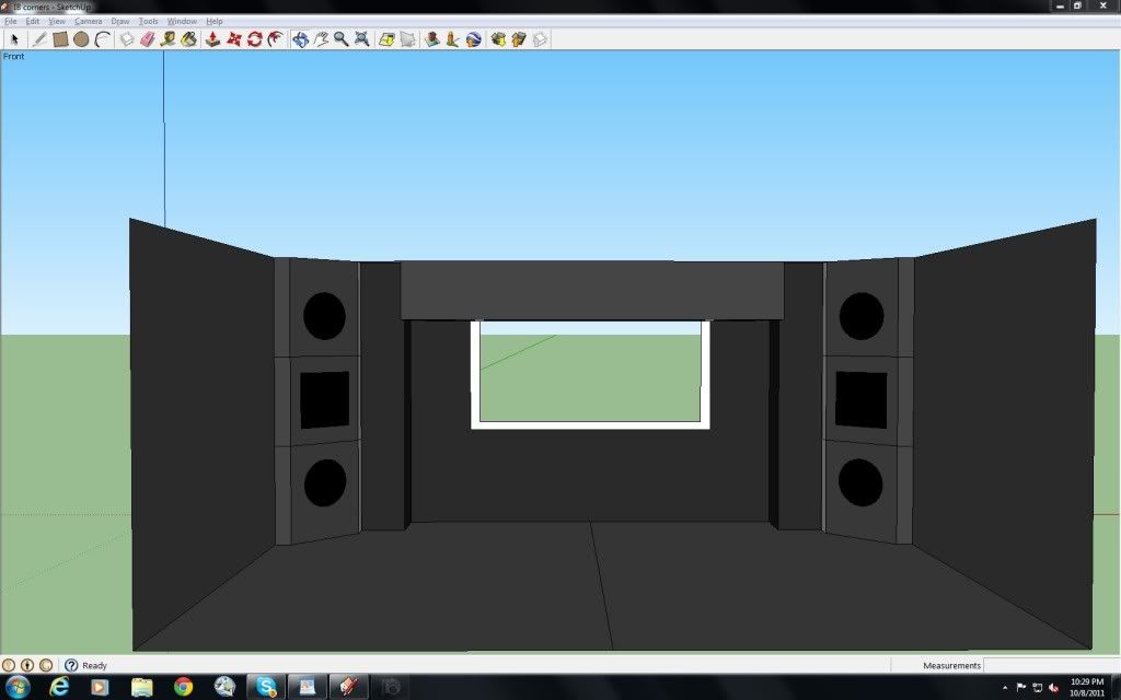

OK so here's the latest incarnation. I'm fairly confident I'll end up with the speakers in the front corners like Ivan recommended. The variable will be the toe angle. It looks like it should be really close to 45deg to aim the speaker at the opposing passenger seat.
So after crawling around the attic and ruling out various IB locations, this is the latest incarnation of the IB/LCR, with the center channel attached by flypoints and set up to raise and lower from behind the cornice (for lack of a better term). There will be five separate IB manifolds. Two in each front corner -- one venting into the ceiling/attic and another venting into the floor/garage attic. Also front and center just in front of the cornice there will be a 2x2 cutout / vent with a 4-driver IB manifold in the attic.
So in the image below I've come up with dual IB's straddling a soffit mounted SM60F. I'll give Danley a call to see if they've developed an optional crossover with no BSC for soffit mounting the SM60F. I would imagine there's only the standard crossover available, so If I end up going this route I'll likely end up running the signal through a mini DSP to tame the bottom end.
Any thoughts? This is not your typical full wall baffle mounted type soffit mount. Would I be better off just making the subs as small as I can and not walling in the SM60F?
BSC? I am not familiar with that term. But to answer-there is only the standard crossover available.
Danley Sound Labs

Hey thanks for saving me the call Ivan. I'll just use a mini DSP or my DCX2496 to tame the low end then. I think having the extra extension on the low end will help integrate the mains to the IB.
BSC = baffle step compensation.
So what do you think of the corner pillars with the SM60F walled in as shown? My wife sure likes the idea. Do you have any better ideas to get them hidden into that pillar somehow? I'm going to cover the whole thing in AT fabric, so there are a lot of options available.
Also, the IB manifolds can be made taller or shorter to make for a tight fit for the SM60F or to give it more space.

Looks fine to me. And if the wife likes it-even better.

Thanks Ivan. I think I'll start a new soffit thread over in Theater Construction to see on getting some more input on soffits...
http://www.avsforum.com/avs-vb/showt...9#post21058999
