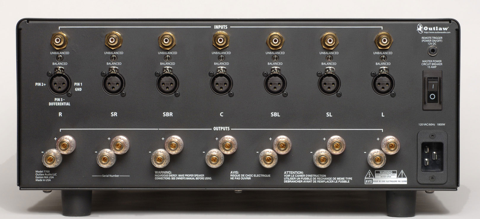

Pre-amp outs are female RCA (or balanced XLR... but that's another story) jacks that send out analog audio from a receiver or pre-amplifier/surround processor to a separate power amplifier when analog cables are connected between the two.
This allows you to bypass any or all of the built-in amplifiers in a receiver and power your speakers with better, beefier outboard amplifiers that have large power transformers and heavy-duty circuit boards. Most average amplifiers with good power ratings are around 200 - 250 watts/channel.
Full pre-amp outputs would mean the receiver or pre-amplifier/processor has one jack per audio channel and sends out all the decoded channels. Right now, that's up to 9.2 channel outputs. Most receivers have 7.1 or 7.2 channel outputs, except for the cheaper models that only have one or two subwoofer outputs.
Back panel of Onkyo 709 showing 7.2 channel pre-amp outs (they're located at just right of center of the receiver, right above the speaker binding posts):
Here's the back of a typical multi-channel power amplifier (this one has 7 channels of amplification with both RCA and XLR input jacks):
I'd go with the E2 package and Onkyo 709 receiver. You'll be happy for quite some time.
