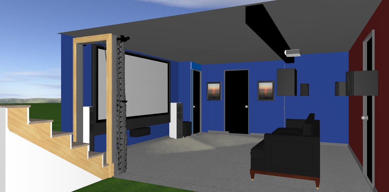

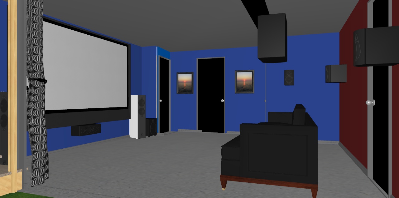

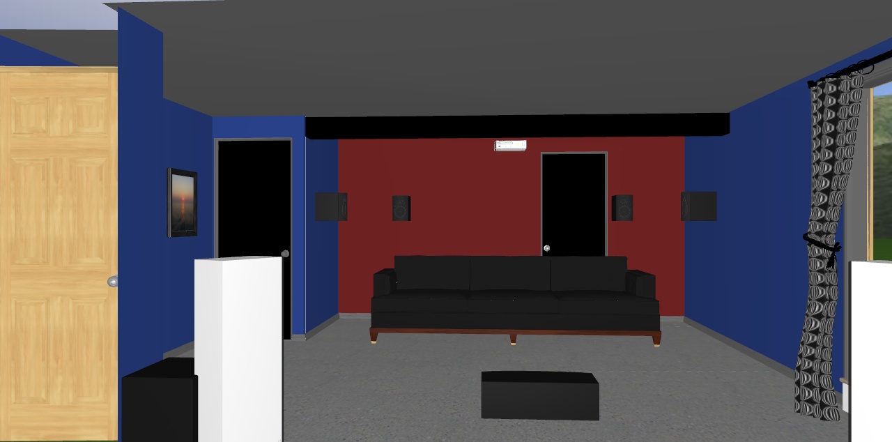

Hello,
I am a new to audio equipment and am in the process of setting up my own little slice of heaven in by basement but i am having difficulties deciding where to place the surround and back channels. So far my setup includes:
TSI 500's-fronts
CS20-Center
Klipsch Sub12- Sub
Onkyo 709- Receiver
LG 55 inch Flat screen
My plan this week is to order 4 Polk TSI200's for my surround and back channel speakers ( wall mounting on pinpoint AM40's) but i don't know if they will be to large for my space considering the couch is only a foot and a half away from the back and side walls.
Here are a few images of my space that i created to scale, any suggestions or advice would be greatly appreciated!
Attachment 240352
Attachment 240353
Attachment 240354

I have never heard your speakers but smaller speakers will not help. Your placement looks about right (I might place the surrounds a little higher). Ideally you would have more room to the right, left and behind your seating area but most of us have similar issues in our in-home setups.
Your Onkyo AVR has Audyssey setup software that will set your speaker levels, crossovers and distance automatically for one or more locations on your sofa. The AVR will also allow you to tweak the speaker levels and crossovers for the best sound at your primary seating area.
There is no magic here (though Audyssey room correction software is very good at performing setup magic ) so you will just have to use trial and error and your own sound preference as your guide. Looks like a nice comfortable room ... have fun!

Thanks for confirming my suspicions, I have read allot of posts saying that the speakers should be two feet above ear level but i have also seen allot of posts advising the speakers be put right at ear level. I'll go ahead and put them at two feet above and just angle them down a bit.

I'd personally go with bi polar or omni polar rears. Dipole on the sides would be good too. I'm not a klipsch fan either,way too bright..
I have mine right at ear height and I really like the placement. Try different things, and see what YOU like.

How far away are the speakers from where you're sitting? mine would only be about 6inches to a foot...
I can't speak for Chad, but mine have been as close as a foot and a half.
Your 709 has audessey, so you can place them anywhere you want and the AVR will do the math for you as far as distance set up and equalizing.
And as Chad did mention, experimentation with placement is going to get you your best results, trial and error will get you honed in.
And, your 709 has audessey DSX, which means you can choose to run; wide channels, height, or, as you're planning, rears.
I have an 807onk, with the same speaker options as yours. I've tried all three configurations and have settled on the wide channel, IMO, that's where the most content is utilized of the three choices.
Your mileage may vary, and you may end up preferring the rear channel over the other two, or space may be a factor as well.
Bottom line, it's your toy, play with it.
