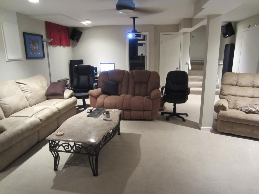

We're having a GTG this Friday at my place to compare these speakers in my room. We plan on doing some blind testing and sighted as well. We are going to demo both music and movies.
So, here is what we have:
5 eD Cinema 12's (mine)
3 JTR Triple 8's (Bluesprings1)
3 SHO-10's (Huskeromaha's)
4 DR250's (I think these are desertdome's speakers)
Huge thanks to Bluesprings1 for letting us borrow the JTR's, and also to desertdome for making the drive down along with Kwarny and bringing the other 2 sets of speakers. Initially we were just going to compare the JTR's and eD's for a couple of members who are in the market to buy, but when DD got on board it really got interesting.
Also, Jedimastergrant is going to bring over his Orbit Shifter to compare to my dual Submersives and desertdome is bringing 4 DIY dual opposed subs. Mrsmithers, Stitch1 are coming, and of course you can't have a gathering without Archaea. biggrin.gif
Stay tuned, should be interesting.

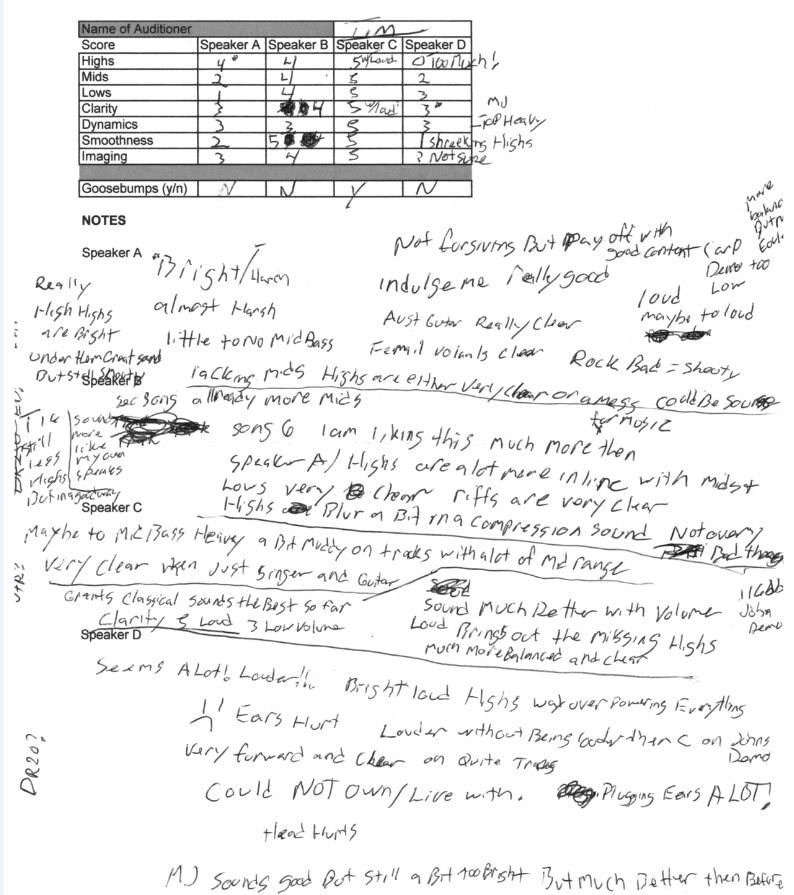

Here are my original unaltered scoresheets with notes taken during each audition, and my guesses in the top right corner of my scorecard.

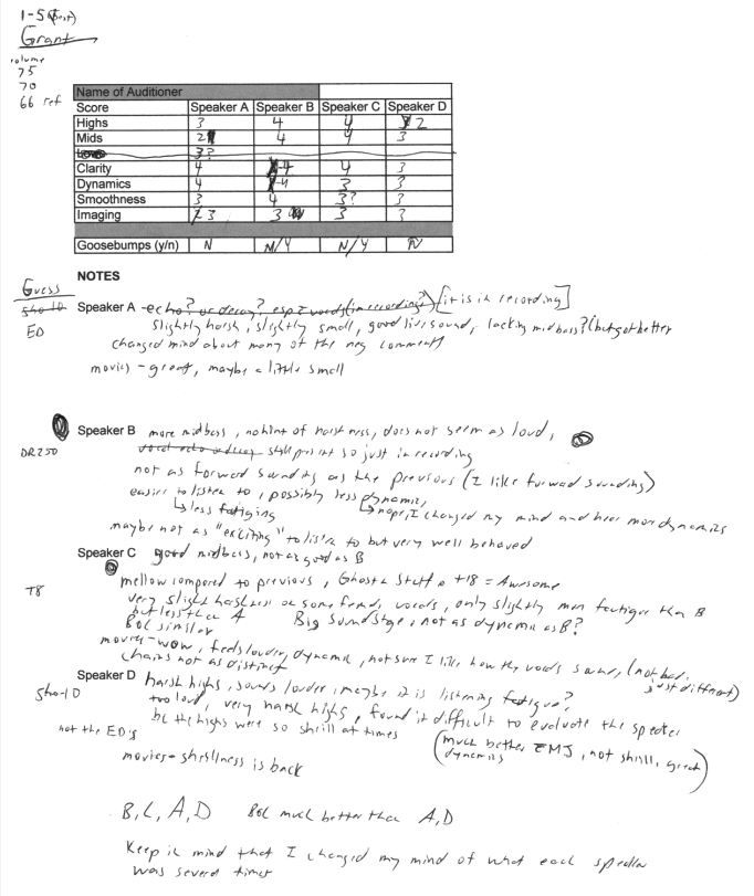

Impressions:
A. ED Cinema 12
Music
These were the only speakers that I had previously heard. I had been to Carps before and really liked them especially for the money. I posted my impressions in his “room configuration” thread a few months ago. I would say my opinion is largely the same with a few caveats. Tesseract67 mentioned (and I agreed) that the ED’s were pushed pretty hard and that might explain why I noticed a slight bit of harshness on the highs that had never popped in before.
Movies
I will keep my notes short on movies because my impressions were largely the same between music and movies (with a few exceptions). My order for the speakers is the same for music as it is for movies. I did not feel like there was a marked difference and I realize that other participants felt there was a huge difference. I tried to listen for dynamics and dialogue clarity for the most part but my opinion did not change dramatically after listening to the movie clips.
B. JTR Triple 8
Music
My favorite by a good margin for both music and HT. These speakers were NEVER harsh for me. They are the ONLY speakers that I did not get even the slightest amount of harshness and I wanted to turn them up but I resisted ( I wanted to keep the volume consistent with my material for all the speakers and that is exactly what I did). They did not seem like they were playing very loud but the SPL meter next to me told a different story.
The extra mid bass vs the previous speakers was immediately apparent and was hugely significant in my enjoyment. They win the mid bass hands down for me. They are the best all around speaker and I can really find no fault considering the price one would pay for a better all around speaker with an emphasis on HT.
I thought they were a bit less forward sounding than the ED’s. I do like a speaker that is kind of in your face especially for movies but others may not.
Movies
These were the most dynamic speakers. It was not as apparent in music as it was in movies. Best dialogue clarity but I liked the others as well. I did not feel the speakers differentiated themselves quite as much on movies. There were bigger differences for me in music.
C. CHT SHO-10
My second favorite speaker and a good speaker for those on a budget. I felt they were the most similar to the JTR’s but there were still many differences. I did notice slight harshness on highs but a bit less fatigue vs the ED’s. I thought they were less dynamic and a little mellow compared to the JTR’s. The mid bass was second best but I was less impressed with it vs the JTR’s and I do think it was even slightly muddy in parts and when we listened very loud.
I realize many thought these were best and they turned the volume up more when it came time to listen to their clips. That is fine as long as we realize how effects our perception of sound. In some cases the volume was turned up more than 10 db compared to the others. I did enjoy this and in some cases I felt they sounded better louder. As long as the speaker does nothing that hurts my ears I will probably always prefer the louder speaker. I wrote that I liked the Dead Mau 5 clip and thought it was awesome (at +16db) and indeed it was. I do think I would have enjoyed the JTR’s even more if it was cranked up as loud as the SHO-10’s but they never were.
Movies
Wow. Great for movies. Great dynamics. Big soundstage. It felt louder than the others. I thought the tonality of the vocals was strange. It was a bit off but I cannot put my finger on it. There were things like the clanking of the chains on the LOTR scene which were not as distinct or detailed compared to the JTR.
D. BFM DR250
Music
First of all we know this speaker needs significant EQ and it did not get what it deserved. I can only post my impressions of the speaker having no idea which one I was listening to. The speaker was extremely harsh with the treble. There is no other way to say it. I have no doubt that this could be helped with proper EQ but we were unable to tame it to my satisfaction even after the blinded portion was finished. It was so severe I had to cover my ears. At that point some listening fatigue had set in anyways. The speaker sounded louder overall. It was difficult for me to evaluate other characteristics because the treble was so distracting.
Movies
Same problems. I did feel the MJ scene was an improvement but I was not nearly as impressed as the others in the room and I just didn’t say anything. I did feel the dynamics were very good but I was influenced by everyone else in the room wanting to listen to the “dynamic horn” scene over and over. I don’t think I would have been as impressed without the others excitement.
Before listening to this speaker I thought I had the order figured out and expected this one to be the ED’s but after listening I knew it could not be true so I flipped my guesses for A and D. We need to add that we did talk between demo’s and because of an error that occurred during demo B we all thought that it was the DR250. Without that faulty assumption I may have guessed differently.
Overall order
(remember that the impressions that I wrote down are more telling than a numerical score)
BCAD
B. JTR Triple 8
I felt these were the runaway winner and what I would buy. Great all around speaker. I expected to like many of these for movies but I was very keen to listen to how they handed music and these were fantastic. If you want an HT emphasis speaker that does justice to your music at very high SPL’s you should give these a listen.
I need to admit here that I was influenced by other impressions of the JTR’s that I have read here on avs and I expected to hear some harshness to the treble. All I will say is that knowing what speaker one is listening to dramatically influences our impressions of a speaker. In many instances one will hear what they expect to hear. The JTR is the ONLY speaker that I NEVER heard a hint of harshness in the treble region. Listening blindly to the JTR gives me the impression that I could just keep turning up it up and never hear compression or get listening fatigue.
The most dynamic speaker.
The best dialogue clarity.
The best mid bass.
The best non fatigue treble region.

C. CHT SHO-10
Second best and great bang for the buck. I really enjoyed this one and the price point is low. Again, I think my impressions of this speaker were influenced by what others thought of it and the ED’s are very close to this speaker in performance and cost. If you are on a budget demo both of them and send the loser back.
A. ED Cinema 12
Very close to the SHO-10’s for a similar price. It is baffling to me that I heard a few negative things from these in blind listening that I never hear prior. Like I said for those on a budget just get them both and send the loser back. Your room and tastes will inevitably be different.
D. BFM DR250
Buy these with an intent to do a proper EQ. I have no such ability. I do wonder what these speakers would sound like if done justice to. I think we all realize the limitations of this blind GTG and take the results with that in mind. We did the best we could with a limited time frame and lots and lots of “technical difficulties”. In the end it was a bunch of guys listening blindly to mostly un EQ’d speakers with too many variables to count. And I would do it again.

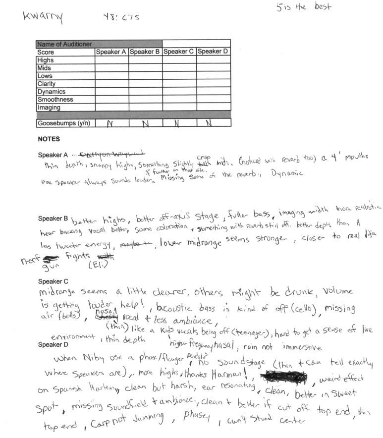

Seating Location – I kneeled, crouched in the area behind the main listening position so I could move my head around and get an idea of the soundstage and hide from the piercing highs behind the listeners and couch. I based impressions off this and sweet spot. Everyone hears difference, looks for different things, and other levels such as volume were not controlled.
Music Selection Tracks - Not enough EDIT - [time] for instrumental songs
City and Colour – O’ Sister 1:19 – 1:58 (seen Dallas Green, Tegan & Sara live so familiar with voice, recorded in a church, backing vocal that is not always recognizable)
Angus and Julia Stone – Draw Your Swords 3:29 – 4:19 (needed a slightly compressed track, not enough time to hear Angus and Julia both in a song)
Right Away, Great Captain! – Memories From the End Pt. 1 0:45 – 1:21 (reverb, awesome vocal dynamic range, could not choose from album)
Hugh Masekela – Stimela 2:05 – 2:43 (good laughs even though it is a serious song, very dynamic drums, just need to turn it up).
Speaker A – Ed Cinema 12
- Thin depth to the soundfield.
- When moving a few inches from the center, the nearest speaker dominates the soundfield. Can pinpoint where the closer speaker is and the other seems much much lower in level.
- Crisp vocals in the midrange (higher up in frequency in what I heard with JTR). Also noticed this crispness with the recording reverb/ambiance.
- Snappy highs.
- Seemed like giant people were singing and playing instruments. The vocal imaging size was huge (estimated that the singers mouths were 4’ wide). The instruments were also abnormally larger. Might be sweet for voiceless trance.
Speaker B – JTR 10 (should not be triple 8, DDD is better known as F)
- Much smoother highs from start. Seemed a little recessed later on and missing some cymbals, bells.
- The imaging width/height seemed more appropriate. Moving my head did not result in the closest speaker dominating the soundfield.
- This speaker was the closest to presenting a realistic soundstage such as an unamplified indoor music venue. It was the only one that provided some depth to the presentation. I enjoyed the more immersive feel for movies too. The Book of Eli brought back memories of nerf gunfights so it has to be realistic. The Rain scene was the most immersive on this setup too.
- The reverb/ambiance still did not have the relaxing airy feel. Something a little crisp with the reverb.
- The upper bass seemed louder.
- Seemed to be some coloration somewhere in the lower midrange. Also missing some detail in the recording.
Speaker C CHT Sho-10
- The presentation seemed the clearest but there was also some nasal quality to vocals. Not like Lois Griffin nasal but seemed more like undeveloped teenagers vocals, maybe due to recessed high end (NOT the haaaaaaa or maybe it is huhhhhhhhhh sound you hear with prepubescent kids, I remember listening tests over this in middle school, has this singer’s chords matured yet?).
- The soundfield depth was thin and like speaker A, it was easier to tell the location of the speakers by moving your head. Not as dramatic though.
- Missing air on bell, most of the cymbal energy is gone, and some detail was missing on songs.
Speaker D – Dr 250 Odd-Ball, meant for large venues
- Mother Hubbard!, the top end was harsh but at least back. My eardrums were ringing like a bell on certain notes. Had to throw a notch filter on eardrums, suck extra air into inner ear canal to further reduce highs, and add fingers to outer canal. The 10 kHz area was still hurting even after PEQ that area and reducing the channel levels.
- The tone was clean. I bet these measure well in harmonic distortion.
- Sounded like Nilsy boy was using a flanger/phaser (have hard time telling the difference between those pedals) pedal on guitar and voice. Most of the tracks sounded this way. Not full flanger/phaser effect but with some level. Very noticeable with the center channel during movies.
- The speaker sounded much better in the sweetspot. Everywhere else the imaging was missing, whats the popular word, oh swag, or maybe saying it was vague is better?
- Could tell where the sound was emitting from the easiest.
- Is this what 3D sound sounds like cause 3D movies hurt my eyes?
Center Channels
- The only center channel for movies that I really enjoyed was the JTR. I prefer a more immersive soundfield. The others seemed too localizable. The JTR was even.

Yeah, Desertdome told me they are 22x22x22, so I built the blind frames pretty big - thanks though. The center channel will block some of the screen for movies, but oh well it shouldn't be that big of a deal.
Here is a picture of what the seating area will look like, I really want to avoid doing folding chairs. The seats aren't all optimal of course, but I figure all of us can take turns sitting in the sweet spot. If we get more people coming we can set folding chairs up in the back... wish I hadn't sold the bar stools years ago...

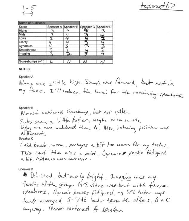

EDIT: My blind listening impressions, hind sight is 20/20. biggrin.gif I tried to limit scoring my card to my impressions from the sweet spot listening chair. Not easy when you only have 30 seconds or so of music clips, and one of my chosen clips didn't make it to the HTPC hard drive, so I had the least amount of time in this chair. I did save Dynamic impressions for movie/concert clips, during which time we would all move about the room trying the sweet spot chair and alternate positions. I decided to call the category "Lows" Mid bass, because true bass (lows) were filtered out and handled by the subs.
_______________________________________________________
Speaker A: Didn't sound bad, just not what I am used to listening to at home. It handled Dynamics pretty well, male/female singing voice and movie dialog came across with very good Clarity, but A was a little rough around the edges at the high levels we were listening at. I would have liked to give it another go at lower volumes. I think that being the first speaker put it at a disadvantage. All participants lowered the volume for B, C, and D at one point or another during their time in the audition chair, even if levels were cranked later on.
Speaker B: I really enjoyed this speaker, it didn't have any glaring faults except for imaging was vague for me. Could have been improved with setup, possibly, but that takes experimentation and time. Dynamics were impressive, B sounded the same at higher levels as it did with lesser.
Speaker C: By this time in the audition, we were trying wider ranges of listening levels. This made scoring a little tougher, and I made some changes to my sheet when the movie clips were played. Midbass was best of the bunch, and may have masked the midrange a bit. I've listened to these speakers in two other environments (I own the 2012 version and bought them based on hearing HuskerOmaha's in his room), and they excel in the midrange.
Speaker D: This speaker started off with levels noticeably higher than the others (5-7 dB higher average), especially the highs. I had to plug my ears, looking around I noticed Carp and kwarny sitting in the back row with me did the same. The rest of the guys in the front row did not and I was concerned for their well being! I did ask that the volume be reduced so that I could get a better handle on the speaker's sound. When levels were reduced, I could hear the potential the speaker had, especially with the well recorded Michael Jackson clips while listening in the sweet spot chair. I asked a few participants to sit and listen to these clips and I think they were in agreement that D did very well with that material. I scored my card based on lower listening levels and ignored the blast we experienced at the beginning of the audition. Mid bass was thin, which didn't help with impressions of the highs. In spite of my scoring or the impressions of the other participants, this was my favorite speaker and I really would like to hear it at it's best. D didn't get to put it's best foot forward, but it's potential was evident to me. Imaging was best of the bunch..
________________________________________________________
Optimizing a speaker to the room takes time, time we did not have. As a result, no Goosebumps were experienced by me, or by my 2 channel Nebraska brethren. smile.gif

Listening to BFM arrays and dual SubMersives as I type this.

Here are the revealed identities of each speaker
Speaker A - Elemental Designs Cinema12
Speaker B - JTR Speakers Triple 8
Speaker C - Chase Home Theater SHO-10
Speaker D - Bill Fitzmaurice DR250
SCORE SHEETS!
I've made an album in photobucket to hold the scoresheets from this blind meet.
Here are the other's score sheets.
Two notes: I deleted a line from carp's scoresheet at his request before publicly posting his sheet. Kwarny didn't score because he was helping Desert Dome setup and so was not blinded.
All other attendees were 100% blind and in talking to each of them --- none of us had any clue what was what during each audition, and what's more the ones we thought we SURELY KNEW --- several of us found out were wrong (myself included)

JediMasterGrant's Score Sheet
Kwarny's Score Sheet ( was setting up and tearing down blind speakers - no scoring since he knew what was what )

Tesseract's Score Sheeet
