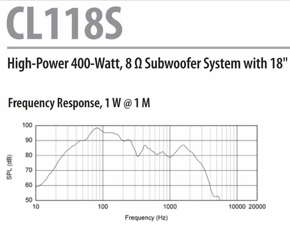

http://www.behringer.com/EN/Products/CL118S.aspx
Does anyone have this sub to match their 212xl or 215xl?
-10db at 29hz
Made from double ply birch.
I have 2 sealed 15" subs today that start to roll of at 60hz but with room gain alone they are flat to 18hz. I think the room gain would give these bad boys some nice headroom? Bi-amp them to my 212xls each on a channel of my 3000dsp?
279 a pop!

They call that a subwoofer?

Pro audio subwoofers only need to go down to around 45 Hz for live music vs. 20 Hz for home theater.

And it looks like this one goes all the way down to 10 hz so I guess its pretty good.

With an F10 of 29 Hz, this is a pro audio subwoofer.
I guess I didn't understand your original comment.

Corradizo, actually, I don't think you benefit from RG with that sub. Its -10 at 29hz because it's "front loaded" (gonna assume a front loaded horn here) so below 29hz its gonna have no useful output. RG usually kicks in around 30hz and down IME. From about 40hz and up that sub will likely have insane output in a home, especially for the money. But that extra octave is significant IMO. Myself I go for another 2 octaves minimum. Pro subs just don't do those octaves.
David, we don't understand what is wrong with that sub. Yes, it's a (pro audio) subwoofer. You don't think it is? I'm confused.

David, we don't understand what your problem is. Yes, it's a (pro audio) subwoofer. You don't think it is? I'm confused.
A bit tongue in cheek. Obviously it is for Pro-audio not home theater use, but in the AVS world where 20 Hz capability is "entry level" I question whether a ported box which appears to be tuned at 80 Hz can really be considered a subwoofer at all. I seriously doubt that room gain will even start to level out that precipitous drop.
I won't side track the thread anymore, especially by repeating a discussion that happened about 8 pages ago. Back to the B215XL.

Oh I see. I agree RG won't help. It's certainly tuned lower than 80hz though BTW. That peak at 80 is probably from being in to small of a box. A bigger box would make it cost more though.
