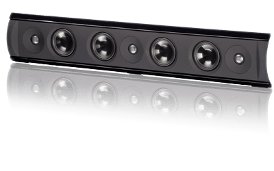

A really great soundbar with included sub is typically $800 or much more.
If you want great sound with the look of a soundbar, get a low cost AVR ($150), a low cost sub ($100) and a really good 3.0 front / center speaker like the Paradigm Trio - you can get them from eBay for around $225 - total cost of $475. Down the road add some used Paradigm Atoms for the surround and you will have something that looks good and sounds great with only slightly higher cost than a disposable / non-upgradable $350 sound bar.
http://www.ebay.com/ctg/Paradigm-Cin...ker-/114742580
