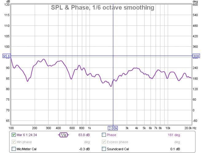

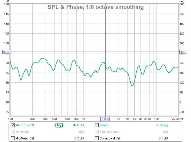

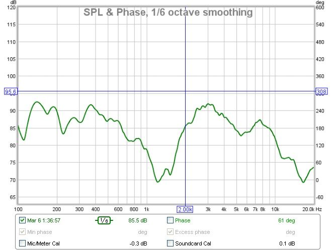

Guys, the reason I state what I do is because I have tested countless gear like you guys with tons of experience and each time I was critiqued in what I have could have done better. All I am saying is the test conditions and placement were the same but the frequencies were not and that is the most important baseline. It is OK to say one was better but until you make each one flat or your preference in response you won't know for sure. You can't even level match correctly unless the responses are flat or within a certain window like +/-3 dBs. Why? Because when you calibrate you are setting the level to the peaks of the responses and it can vary without measuring. Of course speakers still sound great just placing them in room but some may be better than others due to the response to the room, not the speaker. I can't stress this enough. Why? Because I have done the same thing countless times. Yes, I have people over whenever they could come, I have never said no to a member. I mean look at what Carp said about my speakers, could not even listen to them at 80 dBs. Now everyone from that GTG thinks the DR-250's are crap. I bought them because I know they are a pain in the butt to get right in a room(they are meant for outside concerts). In my room they beat every speaker so far from 7 different people and none said what Carp said. I don't have a magical room! So to say one speaker is better based on a GTG is really hard without data to show why. BTW, I say the same thing for everyone no matter what speakers are played.
I know how time flies at GTG's and EQing could be hard and why I always use 2 different speakers at a time even though I had many on hand.
That's a good point about the level matching. The 1099 and JTR measurements were really good, Tempests were the worst I've ever seen.
With this measured FR, there's no way the mids are going to sound good either:
The Tempest, 1099's and 228HT's are all within 1.5-2dB's of each other as far as level matching at the GTG was concerned.

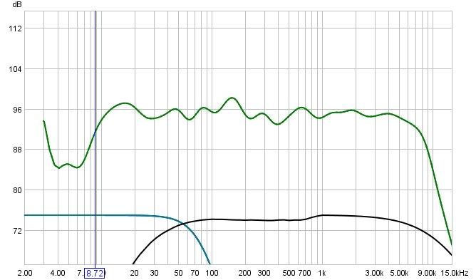

Here are some responses I have taken from speakers not EQ'd.
JTR 888LP
DR-250
DR-250 in baffle wall
SEOS 10
Unity 215
DR-200
Triads(disregard the over 10khz)
M&K S-5000's
Non stacked DR_200
JBL pro 4675C-LF's EQ'd
Disregard the below 60hz as that is subs and not speakers. The point is without EQ the responses are all over the place. I get them all flat and then I can judge clarity, dynamics, feel, sound stage, etc..

So with all that said I have no choice...
I just scratched "Doing a GTG" off my bucket list!
Congrats to the FLAWED GTG my fellow Canadians.
I hope you guys had fun despite the pathetic GTG you had.
Tux...you're 1099's are meh! anyways here my latest test with my 1099's
