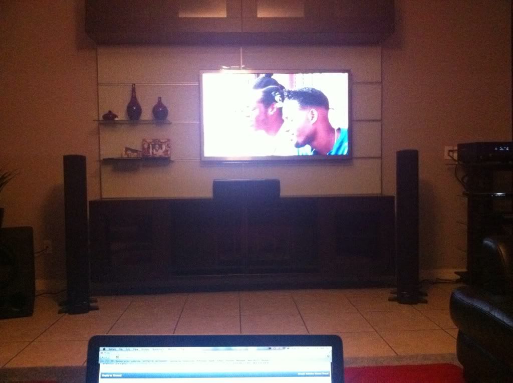

I just took the measurements. the first and last is sub and it's very hard to set it at 75db as the needle goes crazy, and the funny thing is that i can barely hear the bass LOL. I'm i doing something wrong? the results were worst than audyssey! i ended up setting the sub to -4.0. Here is the video of the measurements http://www.youtube.com/watch?v=ga71M...ature=youtu.be

Originally Posted by KJSmitty View Post
Turn the "response" switch on your meter to slow. The 75db number is irrelevant. Just set the master volume to where the tone is not too loud and the needle is steady on a line/number etc that's easy to trim to.
You may need to get into your receiver setup to ensure your LFE/sub is set to 0.0 too.
Also, I hold my meter vertical with the mic straight up - at the seated position where my head would be. Adjust your trims so the needle falls on the same position/line on your meter. If any of the adjustments fall below 0.0 just bump the lowest up to 0.0 then change the rest equally. IE, if the lowest results in a -1.0, raise it to 0.0 then raise all others by 1.0 etc.
Ok, so i measured again and got these results;
FL 0.0
C 0.0
FR 0.0
SR +2.O
SL +2.0
SW+2.0
i Had to turn down the master volume way down in order to get 75DB for FL & FR from the 0.0 trim point. I guess Audyssey has a pre-set volume for the test tone menu.
speakers sounded better this way at -20db it was pretty loud, but i still think i'm missing something here.
Originally Posted by Ericthemidget View Post
Turn the meter dial to 80 or 90! Are you using a sub or the bass coming from just the speakers? Either way, turn down the sub volume on the speakers/sub! Then adjust the trim.
i'm using the svs pb13 ultra. The gain is at 50% and audyssey had set it originally to +1.5db.
Originally Posted by truwarrior22 View Post
As others said, set the meter to slow and turn it to 80db. That room looks like it has a lot of hard reflective surfaces. It's probably going to be hard to get any type of speakers to sound good in that room. You might not hear the bass because your head is in a null and the meter is in a peak. Stand next to a side wall and walk back and worth the wall. You'll notice that some areas are louder then others.
On a side note, I think room correction features only sound good at low volume levels, at least with my bipolar towers.
You guys keep saying how you hate all the eq features, but in my case, as soon as i hit the multeQ button on the denon remote And set it to "manual" (assuming this means that my manual settings are the ones being played?) and turn dynamic EQ and Volume to "OFF" i no longer feel the little bit of bass I get and everything sounds worse Even though my manual settings are set louder than audyssey settings including the sub. Same thing if i turn multieq to "OFF". But when i turn it to "Audyssey" and DynamicEQ "on" and Dynanic volume to "day" everything sounds louder and clearer, you can hear the bass pretty "loud" in comparison.
So, this is leading me to believe there's something very wrong in my picture. Could my tile be really affecting the sound to this degree? isn't reflection supposed to make things sound "bright"? that is what i feel i'm lacking, that vivid,defined sound. I remember when i first heard the speakers at BB and they demo a gladiator fighting scene and the sound from the swords slamming together was so real and clear i felt i was inside the coliseum with them! that is what made me fell in love with them. But on that note, I do have a big 11x9 area rug in the main listening area. The rug is 3' away from the speakers, I think that should help with reflection.
On the bass note, I have crawled around the entire area looking for that pressurized sweet spot and i just can't find it anywhere. I'm gonna move the sub to the size of my couch on a corner to see if that helps.
I'm open to all suggestions guys so please feel free.
Thanks for all the support gang
Elfather is offline

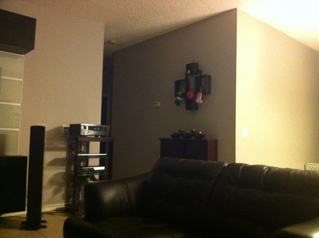

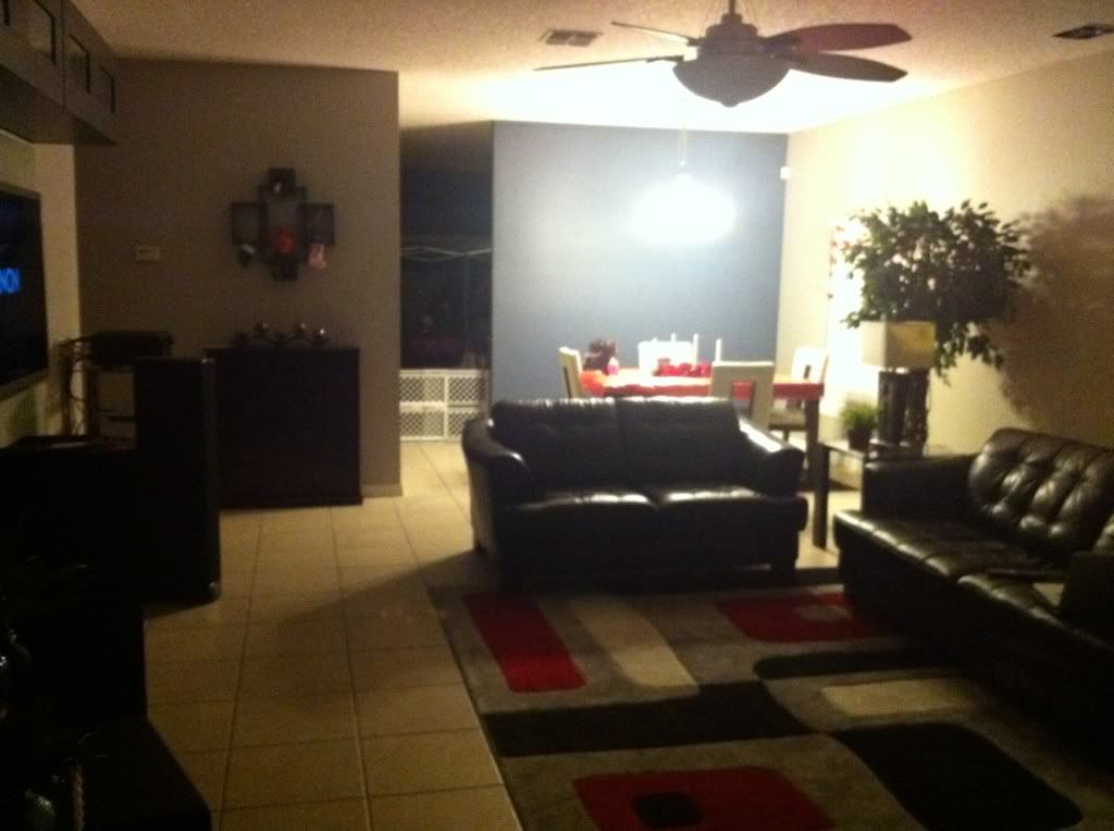

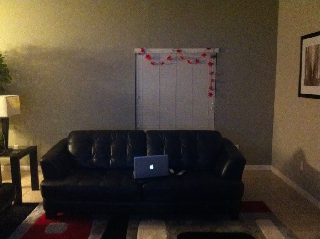

Originally Posted by koicraft View Post
Sorry to hear the 8060s aren't sounding as expected - while I do not have the same speakers, I have been through the whole Audyssey / tuning / endless tweaking drill to get the current great sound I have out of my BP2000s.
What is the audio source that you are using to test with? My Denon treated stereo and other outputs separatley - make sure you make your changes to both.
My main AVR is now an Onkyo 709, but I do have a Denon 1611 in another room that used to be main. I have found that my Audyssey approval depends on the room - in the main room with my DT speakers it sounds hollow and too flat - in the other room it actually works ok with the hard surfaces, other brand of speakers, and 20' ceilings. I'm still not a huge fan though.
Others have given you great advise as to using the RS meter for SPL adjustment. If your sound still isn't cutting it, I'd advise going back to basics and try the following:
1) Speaker/sub positioning - how far out from the wall are the 8060's? Try increasing the distance if possible. Sub - try moving it to different locations if the bass isn't adequate. For my huge room, I found corner loading works well. Do the subwoofer crawl if possible (when nobody is watching).
2) Run speaker wire only to the 8060s. Set the sub volume to 10-12 o'clock on each tower. Also, make sure they are turned on
3) Enable subwoofer in the AVR and connect just the real sub to the LFE/sub output on the AVR. Turn off double-bass.
4) On your sub - if it has a crossover dial - set it to max. Also set phase to 0 and volume to 10-12 o'clock.
5) Plug in the mic and re-run Audyssey setup. Ensure the mic is at ear height and test all 6-8 positions. I tend to have all positions within 3' of my main listening position.
6) When Audyssey is complete, set your 8060's to Full size if they are not already, set all of your other speakers to small, and try an 80Hz crossover. Note - only set to 80Hz if Audyssey has set to something lower - if set to 100Hz or higher, leave as-is. When I had the Denon in the main room, I had the best results setting Audyssey to Bypass L/R, Dynamic EQ on, Dynamic volume at Day.
Now test your audio at this point with a blu-ray and a good stereo source if possible. Try different listening modes - I am a huge fan of Dolby PLII on the Onkyo for music (now PLIIz height since I added my additional speakers).
Now, if necessary, use the RS SPL meter and adjust to get 75db at the main listening position if not already there from each speaker by adjusting the trim. As other have mentioned - increasing the center and sub levels above what is set are common. I like to run my center and sub about 3-5db higher.
Good luck - hope this helps!
Hi,
Thanks for your great reply. So far i have been testing with the the incredible Hulk blu-ray in that park battle scene. Lots of gun shots and smashing stuff.
I have not tested with music, but i did notice and i mentioned here that the speakers sound better and louder with music i played in pandora.
The speakers are 18" from the wall. i just ordered more sub cable so i can move it to other locations so i have to wait and do that next till next week. Unfortunately i ran in-wall sub woofer cable with a RCA wall plate and i do not want to go up the attic and pull all 50 feet of cable to move the sub around.
I'm only running 12awg speaker wire with banana plugs to the speakers and they are certainly on.
I'm running the sub cable from the SW output on the avr directly to the sub left input. All crossovers and parameter eq have been disable and phase set to 0, letting the AVR manage the sub. I'm not sure what "double bass" is? and last the gain of the sub is at 12 o'clock
I will re-run Audyssey later on this week and see if i get different results. Audyssey has set my fronts L/R to "Large" (full band) but based on people's advice here, i set them to small and let the big sub take over the low frequencies. I have set them to 40hz,60 and 80. and to be frank i can not tell the difference of the sound My center Audyssey had set it to 150hz but i set it to 60hz-80hz and also couldn't tell a difference in sound. The Surrounds were set to 80hz and i just left them at that.
What exactly does the audyssey "Bypass L/R" means/Do?
What is good source for stereo? will pandora be consider good or airplay from my iPhone? I Don't really own any Music CD's.
Here is a couple pictures of my living room. As you can see it's not big so i should be getting full blown vivid sound. The main listening area is 18x12 where my couch is. But it extends another 7 feet to that grey wall and another 13 feet to that blue wall so in a whole we can say it's a 18'x25' room with the open (small) hallway. and the kitchen (behind blue wall) is another 17 feet.
Thanks Again for the support guys. I'm going to be it is 4:47am here and i have to be up in 3 hours for a doctors appointment. i will check back tomorrow.
THANKS!
Elfather is offline
