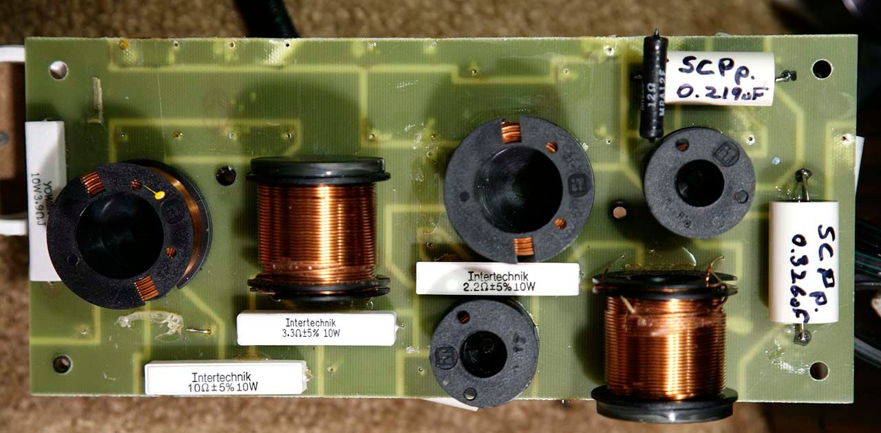

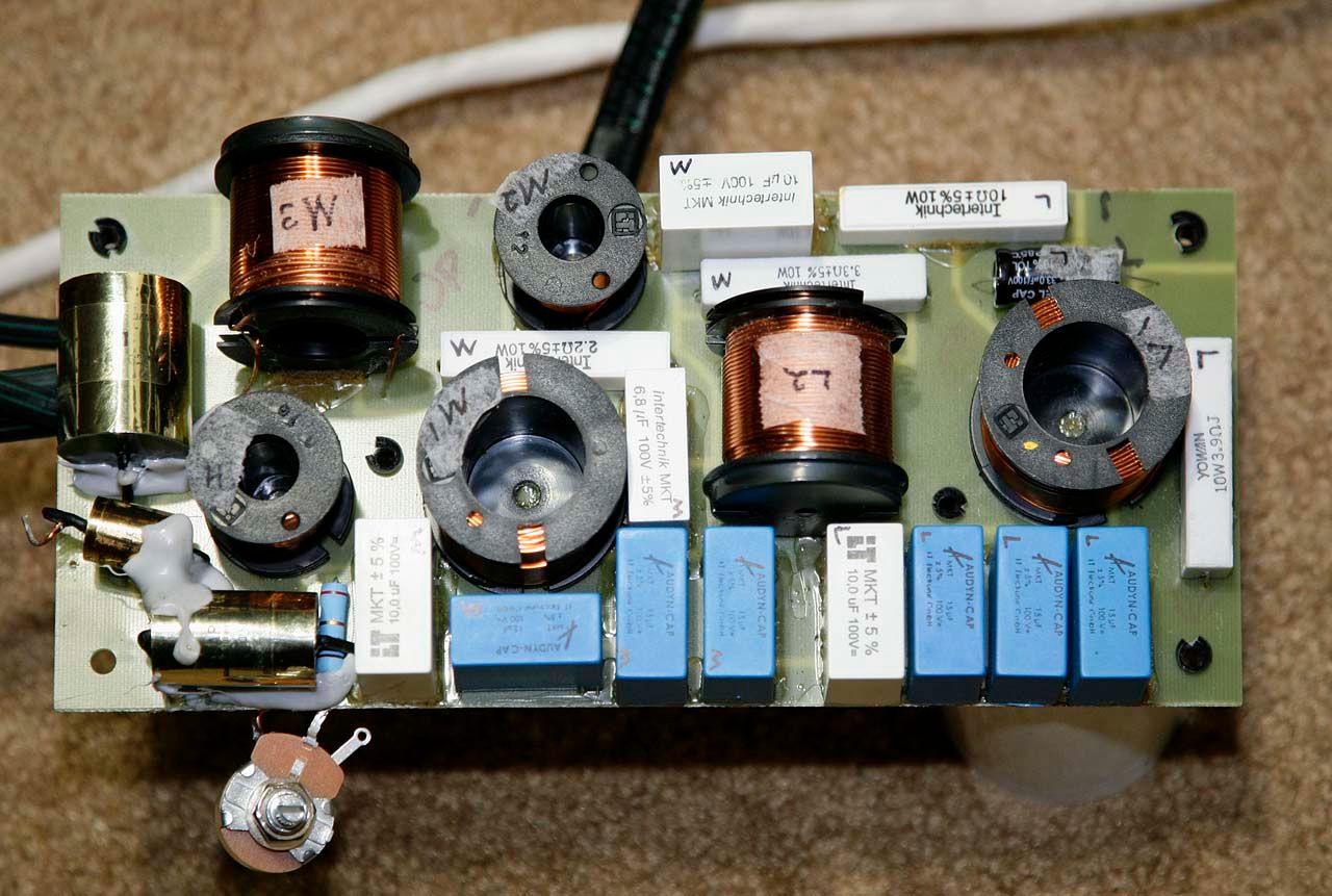

One of the things I decided to do early was to move the high-pass filterpoint of the MR drivers down to increase the warmth of the system and use more of the frequency range of those excellent MR drivers. I had tubed amps in which I could easily change a couplingcap to create a active filter for the bottom of the MR, which I did, and I then REMOVED the 2 banks of inexpensive plastic-film caps that AP used. My MR drivers now run down to c. 80Hz, about the bottom of their physical ability, and the increase in sound quality amazed me. Without getting into amps, you could achieve some of that by adding a great-sounding cap in parallel with the 2 sets of MR-hi-pass caps on the board, but of course you have to identify those caps which means finishing that schematic. On my board, the 2 banks of MR-hi-pass caps are the 3 blue and 1 white caps (3 15s plus a 10 totaling 55uF) at the bottom of the board in this pic.
In this pic, the treble section is on the left, MR in the center, and lower-MR on the right.
This is the board in progress; notice the blue and the white caps are missing.

Daren, more thoughts on moving the MR-LP-filterpoint down.
Again, start with the LMR driver and add in parallel a 47/250 Solen that's only $16.50 from Michael Percy. The LMR driver probably won't reproduce the edginess that's inherent to the Solens (and especially the 250s), so that'll cost only $33 for the 2 speakers. While you're ordering from Percy, buy a couple Axon 33/250s for $24 total and replace the 33uF (or whatever the value is) 'lytic cap that's in the LMR section. 'Lytic caps sound bad in MR sections even if they're in shunt.
But I still think you should start by outboarding the MR/treble x-overs and rewiring the speaker.

Finally finished fooling around with the crossovers.
The wood is poplar, and I should have started staining with WATCO Black Walnut instead of Light Walnut. They now have many coats of WATCO Dark Walnut and WATCO Cherry. Without the cherry stain, the color was a bit yellowish.

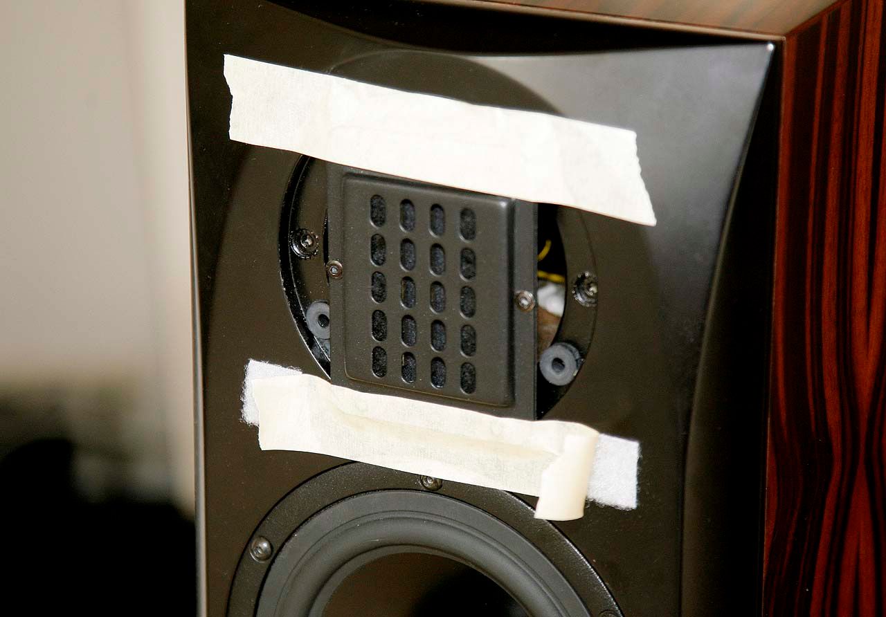

I've been fantasizing about replacing the tweeters, but so many perhaps-more-experienced DIYists tell me I'd be lucky to actually achieve better-sounding treble, so I put it off. Finally I decided to try a pair of tweeters I had some experience with years ago but I guess forgot how good they had sounded. Yesterday I borrowed my buddy's loose pair of B-G Neo3PDRs and clipped and taped them into/on the Avantis.
They almost fit within the 104mm-diameter recess, and they match very well with the Avanti's 3rd-order treble filter...at least as much as I can tell with my Phonic PAA2 3rd-octave RTA.
They sound definitely better--for instance massed violins have significantly less coarseness--so I'll be buying and modifying slightly a pair so they do fit into the recess. Another diffractionbegone.com antidiffraction pad and I'm finished without touching the crossover! AND...it can be easily returned to original when I finally find an affordable pair of Vandersteen 5As.
04 April.
Today I ground* the lower corners to a larger radius and permanently mounted them, this time with black tape.
Remounted the antidiffraction pads (which I did NOT have to cut) and I'm finished with my improving-the-Avantis'-treble project but for the leveling resistors.
* AFTER sealing the driver carefully.
16 April 2011. Decided to screw the new tweeters in/on.
The new tweeter still sound great. I'm THRILLED with the improvement $115 of tweeters and a halfhour made.
