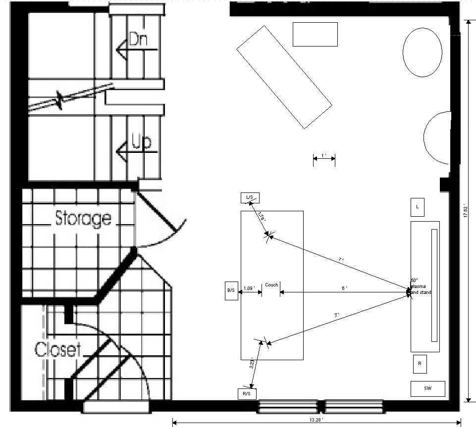

post #820 of 7633 Old 04-13-2008, 12:09 PM
RaginCajun92's Avatar
Join Date: Jun 2003
Location: Virginia
Posts: 244
Originally Posted by Plex View Post
If you already have the 800's in hand i think you should use them in your step up, this all depends on your room layout. Can you provide a rough room layout and distances of where you sit/HDTV? and where you think you mave want to place these speakers. This would help to understand what your asking and maybe understand any recommendations given.
Photobucket trimmed off the room dimensions for some reason but they are 13'2" x 17'4".
Measurements to the couch are from the ProCenter 1000 which is not shown on the layout sketch.
I will put the DefTech's in the same location shown on the sketch with the idea of adding a 2nd back channel for 7.1. I was thinking of getting the dipoles for behind the couch.
Thanks for reviewing Plex!

post #821 of 7633 Old 04-13-2008, 07:11 PM
Plex's Avatar
Join Date: Jun 2004
Location: North Huntingdon, Pa 15642
Posts: 2,027
Let me start with a quick question first then I'll give more input. The Left side and back side speakers are to be hung or placed on stands, i don't see any walls or structures that they will be placed on. Let me know and I can give better options for you to consider.
Audyssey setup guide
Plex is offline
post #822 of 7633 Old 04-13-2008, 07:24 PM
Join Date: Jun 2003
Location: Virginia
Posts: 244
Sorry for that omission. The Left side and back are on speaker stands at ear level. The right side is hanging on the wall.
Ultimately at some point these speakers will be in a dedicated theater room. No time frame on that though.
RaginCajun92 is offline

post #824 of 7633 Old 04-14-2008, 05:10 PM
Plex's Avatar
Join Date: Jun 2004
Posts: 2,027
You may run into a problem with having the left side speaker at ear level. If look back into the past comments you will find where I recommended that rear speakers should be placed at ear level while standing. Anything lower you most likely will only hear those speakers and loose the surround effects.
What I thinking to use two 800's (dipoles will not be the best for this current layout) for the R&L side speakers, move the right speaker back to the wall just in front of the doorway entering the room and the other at the wall or post at the storage and steps area . Based on your drawing this would bring both speakers about equal distance behind your sofa. Even if these spaekers are mounted higher on the wall them at standing ear level you will be OK, if you page back you'll see my posting where i show that my rears are higher and i have no lose of surround effects. Your AVR will do the adjustments for the rears being further back so don't let that worry you.
Since your layout puts your rears back further (if you go with my recommendation) you really don't need the rear-center (6. or 7.) speaker, unless you would put it on the wall between both rears. I reall think this setup would be the best for your current TV layout, even if you moved the TV to another wall, i think the rears would still be an issue.
Have to add, the wife saw your layout and besides agreeing with me on rear speaker placment she thinks your sofa is to close to the TV (just had to let you know)

Has anyone mounted ProCinema 800s horizontally for fronts?
The only location for our front and center channels is on a thin strip of wall above the TV, so I'm wondering if it'll be OK to mount the fronts on either side of the Center channel with the top radiators pointing outward (the top of the left speaker points to the left; right speaker points to the right). Is this going to create substantial problems regarding the soundstage? If so, what (other than not putting the speakers there...we have no other options) would you recommend? TIA.
Edit: In case a photo (or 3) helps, here's our layout: http://craigfroehle.com/basement/ (photo 2 shows the area in question best; the DefTechs will be replacing what's currently there)

I don't think you will have any problems with the sound stage with the 800's on their sides. You did not say you are using a DT as the center, if you use a different brand center you may have a off balanced sound stage. It is very important to have the L/R & center speakers from the same company and that you try to match the same size drivers across the front. The rears are not as important to be the same, but if they are different try to get the db rating the same or very close.
The ProMonitors can even be mounted upside down and they'll sound great. Make sure you are able to point the front and center speakers down enough to the seating area since you are sitting close. The center looks like it is pointed above the seating area. What are the rear surrounds?
