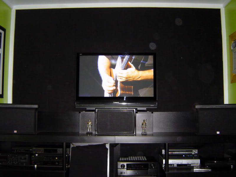

I have 4 E-30's mounted on a DIY bracket, as you can see in the attached snapshot below. Had to do that due to space constraints and it gets the job pretty well though.
What I've done was to build a swivelling iron bracket, facing 45 degrees downwards. No complaints so far. I'm sure if you look around, you'll find some other nice & fancy options, though.
Regards, Chuck

Good job on the black wall. That must really help your video.
Do you have a close up look at the brackets?
Shure I do,
BTW, I'm also attaching the new front view arrangement, as I've recently got a Panny 42" Plasma though. IMO, overall view now is a lot better, as the TV is completely black and blends pretty well with the back wall.
Now all 3 fronts are at same level and I put the S38 as CC and E-50's as L/R.
Chuck
