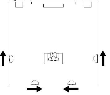

Got a placement question for you guys:
Dipoles have an orientation. According to the diagram below, you should "point" them forward for side wall placement in a 5.1 or 7.1. If using dipole on the rear wall in a 7.1 setup, point them toward each other. I'm guessing this helps them from not creating additional nulls between the sides and rears.
But what about if you are using dipoles in a 5.1 setup mounted on the rear wall? I realize it is not recommended to place them this way, but I actually heard this today and it sounded better than monopoles in the same location.
My theory (based on not much at this point) is that you'd treat them back there like you would the sides and have them pointed outward instead of inward as indicated on this diagram. That way the "forward facing" driver would bounce sound along the side walls just like they would in the side configuration. Do you guys agree? Or is there something about the rear placement that better produces a null the way that it's shown in the diagram?
The arrows are not showing which way the audio will go, because the audio will be going in both direction.
The arrows are there to help you make sure you have the left and right speakers in the proper place, so in the manner that the tweeter work if you are using bi-pole or di-pole. Depending on which one you use, the tweeters will be in phase or out of phase.
That's how I understood it as well, however there's still something more to it. They tell you in a 5.1 system, to point the arrows forward. If all you are doing is aligning phases, it seems as though they could point forward or rearward as long as they were pointing the same direction, right? Because you're just matching phases at that point. (Same thing if you have them along the rear wall in a 5.1 setup...seems like it wouldn't matter)
I understand how in a 7.1 system, it could matter so the sides don't inadvertently cancel out the rears where they are not supposed to, but it seems for a 5.1 it shouldn't matter.
I'm trying to understand why it would, so if anyone can shed some light please do!
I just set up a pair of B&W DS3s this weekend along my rear wall up high. I actually have the arrows pointed toward each other (like the image above) although, like I said, I am not sure it matters because the phases seem like they are aligned either way with only one set of speakers. But I actually have them in monopole mode for the moment. Seems to sound better. Could be because of the high placement or the fact that behind you is not recommended for dipoles, but they aren't that easy to locate unless there is a specific "thing" in the soundtrack trying to call your attention.
I would not use dipoles in the rear -- period. Rears should be directs, like the mains.
