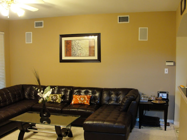

I finally got a set of used Infinty Beta ES250s....just like Electric_Haggis has been recommending.
I must say it is nice to have the option to play between the different settings: MONOPOLE, DIPOLE, BIPOLE. I have decided to stay with BIPOLE because it is mounted on my rear wall. FYI, this is a 5.1 set-up.
To be honest, I am not that impressed with this upgrade. I was expecting a bigger improvement over my poorly positioned (per DOLBY and THX positioning diagrams) 12 year-old home-builder installed JBL in-walls. I think those old in-walls sounded pretty OK b/c they had 6.5" drivers compared to the dual 5" drivers with the ES250. I must admit, those Infinity CMMD tweets are smooth. I just don't have as much impact from the surrounds, and i am not sure if I feel like I am getting a larger surround effect. I guess I am hard to impress. I am sure they will warm up to me with a little more time. Read my question below the pics as maybe I may not have them dialed in properly with Audyssey.
OLD SURROUND pics:
NEW surrounds (ES250) w/ the in-walls disconnected:
QUESTION:
I ran Audyssey with the speakers in MONOPOLE mode, and than switched it to BIPOLE mode afterwards. Does anyone have a recommendation as the best way to calibrate BIPOLES with using Audyssey? FYI, I have an Onkyo 605.

Originally Posted by deepstang View Post
QUESTION:
I would re-run Audyssey with them in "bipole" mode. This setting vs. the monopole setting could impact their in-room LF response and impact the crossover chosen by Audyssey. Also, the overall level measured by Audyssey could be different, which would affect their "trim" settings.
