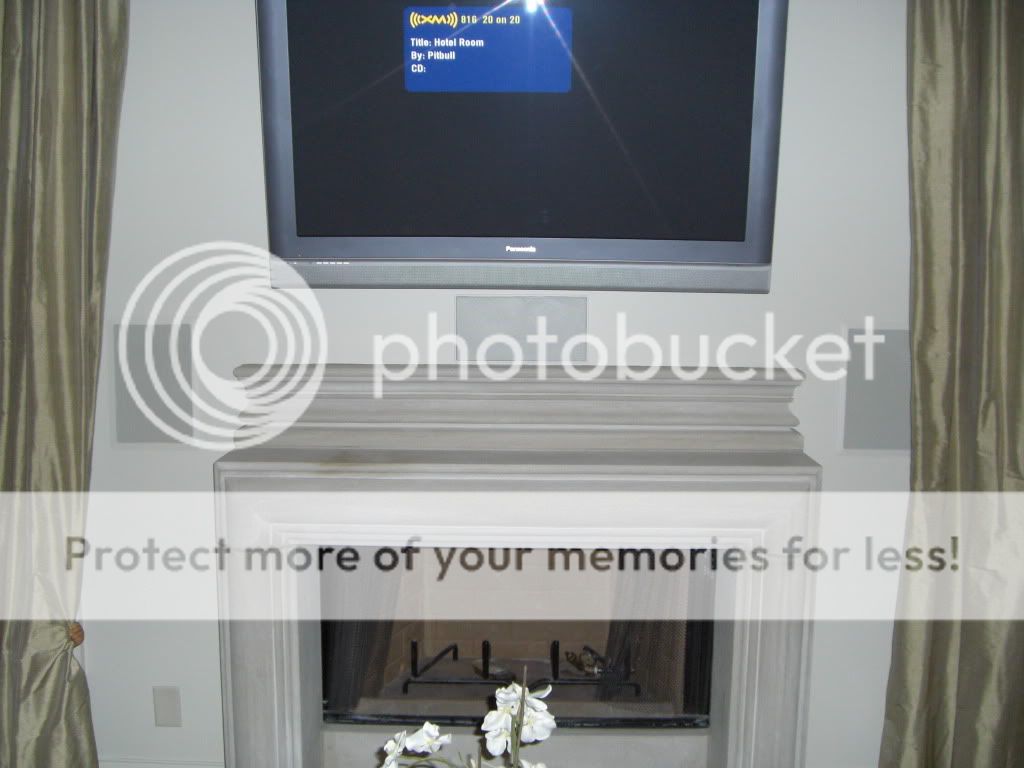

Okay, so I have the okay to do the in-wall speakers. As I have some drywall off, now is the time to install cabling and speakers and run electrical to where I will, eventually, mount the TV. I was thinking of using the Monoprice speakers (8" kevlar, 4101's) for front and rear L/R then getting a center channel, was thinking of picking up a center from MP as well (however, I can't figure out why the 8 ohm is only 40 watts continuous and the 4 ohm is 80 watts as neither seems a good a fit to the 4104's).
However, I think I am running into two problems for the center channel, one is a space problem as it will be above a mantel over a fireplace and it seems I will be physically running out of space with the TV I'd like to mount there. But seemingly even more insurmountable, seems to be the wife doesn't want a center channel 'cause of looks.
I guess I have a couple of questions then; has anyone had good luck running these speakers with either a TV speaker system (ouch, I can't believe I'm asking this) or some small unobtrusive sound bar under the TV? If a sound bar would work, which one has?
On a related but different note, since I'm wiring for a TV and audio equipment, what connections should I be worried about now-a-days? It seems HDMI and component would a requirement at the TV level, what else? Ethernet? Coax? Extra center channel outputs for later ?
The wall plate leading into the wall (receiver level) will obviously have requisite wall speaker inputs and whatever else I run to the TV. Am I overlooking anything?
Audio Lover is offline
post #646 of 2112 Old 03-01-2010, 11:22 AM - Thread Starter
AceCannon's Avatar
Location: Mountain Brook, AL
Posts: 375
So we had the same concerns with a monitor above the mantle. We had to angle the TV down a bit, but we've gotten used to it and it seems fine. The wife had the same concerns you mention, but she is happy now. The TV is as low as I thought I could get it without covering the center speaker.
(see pic below of what I ended up doing in my keeping room) The center is the micro-flanged. Some here have noted that the spec for 4ohms may be incorrect on the Monoprice website - it may actually be 8ohms. At any rate, I am using it just fine in my setup (with an Integra 5.4 receiver). The front L/R (8" in-wall) and the two rear (in-ceiling 8") are all 8ohm.
Connections: for my video locations, I ran rg59 minicoax x 5 runs per location (actually a bundle containing 5 runs) along with cat5e x 4 runs per location. For speakers, I ran 14ga for front L/C/R, 16 ga for rear and for distributed audio locations throughout the house. There are tons of threads here about how to wire your house. Check out the "wiring 101" sticky thread either here on at Cocoontech.com.
Thanks for the input. I'm excited to get this project going although this is going to take a while before all the components are in place. One step at a time I guess. My speakers and at least some cabling should be here Tuesday from Monoprice.
BTW, I love your stone mantle. Very cool.
