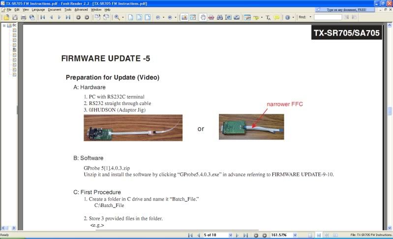

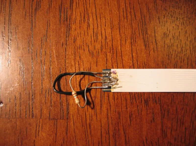

Yes, a jig and a dongle are different items. The dongle is simplistic, and in my case, was needed for my SR-705 to upgrade from 1.01 to 1.06. Here's a photo from the instructions:
A jig is different and according to the instructions is required for the SR-705 to upgrade the VIDEO. Here's a photo:
I'm not handy/techncial to build a jig. BUT, if you're saying I can upgrade without a jig if my firmware is certain version or above, and if it's not needed for the video upgrade, then I don't need it.

To clarify, if your receiver's LOADER version is 1.01 (irrespective of the Main Firmware version, which is separate), then you will have no need for either the jig or the dongle and can do your updates via a straight-thru serial-to-serial connection.
Okay, so, sorry if I'm 'dense here. But in the SR705 Instructions in the ZIP file, they clearly spell out that a jig is needed. Here's the screenshot from page 5 of the instructions.
Are you saying that this is incorrect and that a jig is not needed in order to upgrade the VIDEO?
Note that I've used the dongle successfully, running V1.06, have upgraded the DSP, and also recently upgrade to HDMI V1.02, so think I know how to follow what's needed to do this.
It's needed for video, as far as I know nobody has upgraded video.
Great, so that gets back to my earlier question 1 page back. I need to upgrade Video on my SR705, where can I get a jig? Is there a list for a jig? Surely someone has done this or has built a jig. I'm running 3.58, need to upgrade to 3.61.
I do not need a dongle.
Actually, my clarification was more a response to Jasonvr's post, who in turn was responding to k2_1971. I do not own a 705, so I can't 100% attest to what is exactly needed there. That said, I've seen those instructions, and frankly I still don't understand why the 705 would be singled out as requiring a jig for further updates when all the other firmware (including the loader) has been previously updated. Perhaps the illustrated instructions merely assume one's loader is outdated...? After all, for the longest time it was considered sacrosanct that only a full-blown jig assembly could be used to update ALL firmware on most of the x05 series only for a few industrious members here to later discover the virtues of the dongle. So I'm puzzled, personally. Still, as was already mentioned, no one here has updated the video via DIY. I seem to recall reading earlier in the thread that either the video or HDMI update required a hardware mod at the factory. Well I, as have several others, updated my HDMI to v1.02. So clearly that doesn't apply to the HDMI. But perhaps it applies to the Video? Can't say for sure. But I do know that no one here has reported doing it, so I'm guessing there's a reason for that....
Your question was already answered by jamesm1 above. You simply add yourself to the appropriate region on the list. (The list is for BOTH dongles and jigs, though the majority of members used a dongle after its viability was confirmed.) Last I recall, no one has spoken up as to who last had the one or two jigs that were originally put in circulation. So I'm afraid you're in for a very long wait--unless you're inclined to build one on your own, that is.

I have PM'd alikob (the original designer of the dongle and the one who was selling them). I asked him to pop his head into this thread, but I have not heard a response unfortunately.
On a different note, I actually have an FFC dongle I created and have been keeping more for sentimental reasons than anything else (heck, I still have the protoboard jig I created, but that's a different story). This dongle has never been tested, however, the prototype of it (pictured above sitting on my kitchen table), did work and was in circulation for a while. The actual dongle and the details on how to build it are here:
http://www.avsforum.com/avs-vb/showp...postcount=3997
Based on the fact that there has been almost no movement on the list, I am willing to put this dongle into circulation, but I want everyone's promise that if they receive it, they will perform their upgrade and send it on. If this one disappears, we're out of luck until someone builds another.
What I need is a technically adept volunteer from the list to make sure this dongle actually works. In all the experimentation I did early on in this process, I actually broke the connector in my receiver and can no longer use it as a guinea pig (note the breakage was not from the FFC dongle, but rather my HDMI connector based jig; the FFC is very safe and does not pose a breakage hazard to the receiver). Luckily, the breakage was after I had updated my 805 to 1.08. First technically adept person to PM me wins. After that, we need to start it circulating thru the lists in some sort of fair manner.
